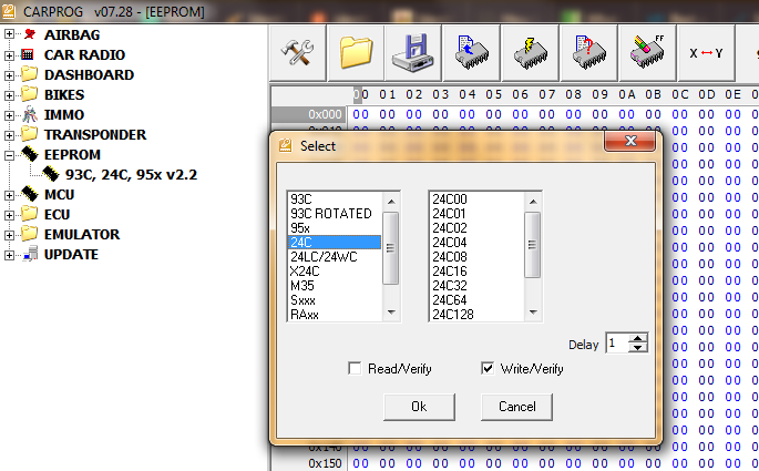

            One idea came to mind. I have a carprog lying around with 4 pin soic clip! Can I use it? How to identify the EEPROM chip code?

              Re: Samsung NP350E5C sometimes opens after 2 minutes of no screen
              Nope, won't work. In this screenshot I see support for "24C" type ROM, which are I²C. BIOS ROM are SPI, usually "25Q". However if you have a Raspberry Pi it is able to flash SPI ROM using flashrom. (you may be able to do it with an Arduino too).
                Yes you are right my Bios chip is also 25LC...Bought it for airbag reset but proved useless. I ordered a TVP2588U+ Bios Programmer locally so it arrives faster. Should I reprogram both chips?
