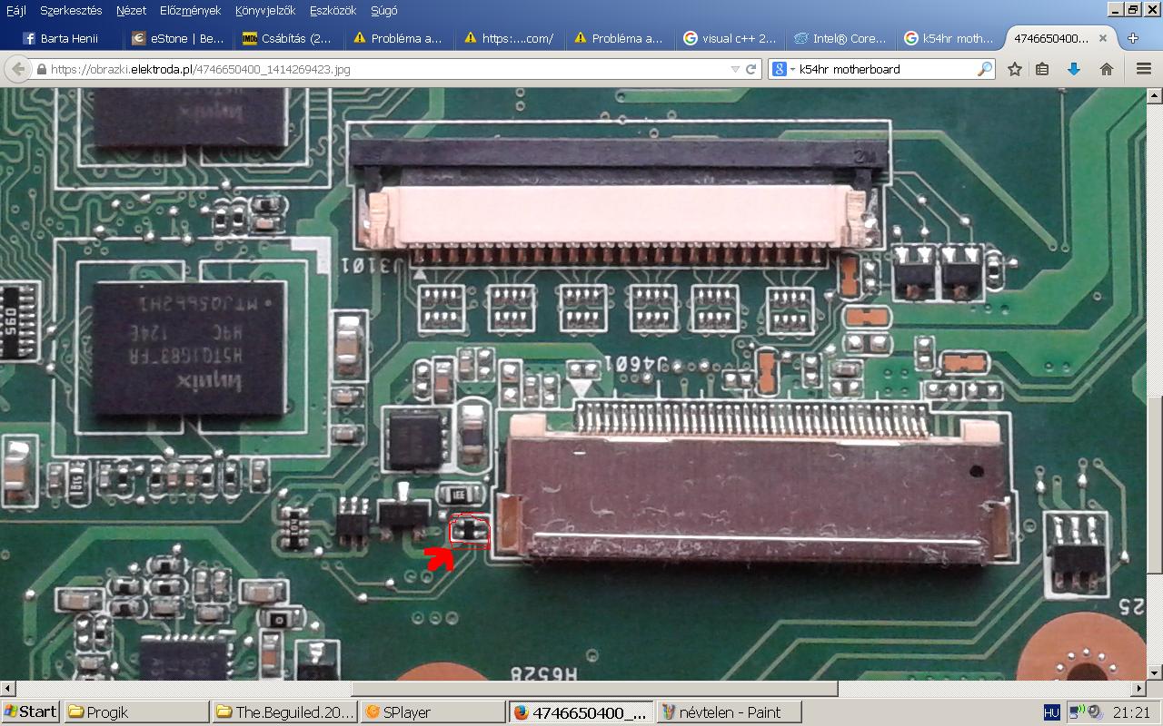

    Hello dear forum members!
    Does anyone has idea about what is this? (circled with red) I think maybe a transistor or some kind of diode.

    Re: Identify unknown component
    Resistor Network
    RES A 2.2K OHM 1/16W(0402)2R4P TA-I/CN22JTN222
      Wow thanks!
      But it has 4 legs ,so can I replace it with 2 black same sized resistor?
        Yes, make sure those are same sizes and values (2.2K ohm)

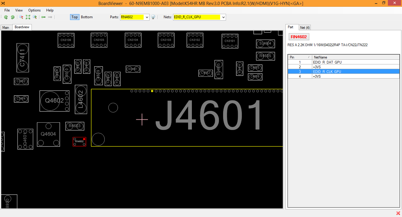

                I measured i have 2.2k resistor, but how do you know it must be 2.2k? Do you have schematic for this board? Because i measured all similar components and they are 4.7k resistors.
                Asus schematic only few present, many only for old mobo, AFAIK for new model (2010-2014 )only UX31A2, X552MD,K72JK,N73SV. Others usually only boardview. without labeling on PCB for part component even have schematic, hard to trace any line.
                Sadly have boardview but can't share for badcaps forum ( I'll eliminated from russian forum).
                Anyway, only screen shoot
                    The r4603 resistor is how many ohm? Can you send me the boardview?
