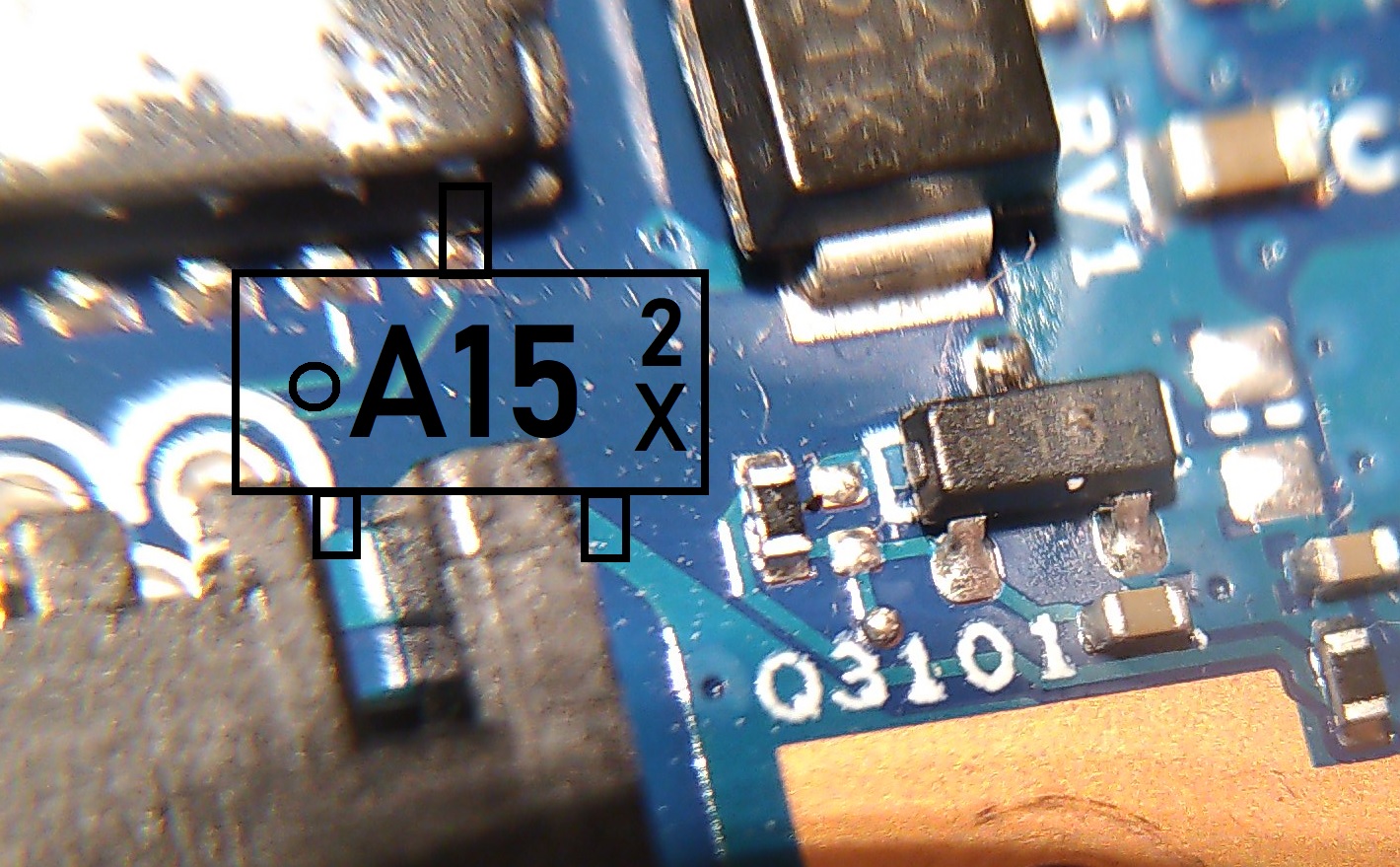

    i need to help with identify this sot-23 part.
    It is on lenovo laptop mainboard LV315KB - no schematics
    Qxxx marking on mobo - i mean that it will be transistor

    maybe MMBD1505A

      hmmm i have find this too but it is diode...confusing is "Q" on mainboard

        It might be a AIC1747-15GJ3, SC70-3 package 1.5v output

          It might be a Panjit PPJA3415

            Yesss...i have found another same on this mobo and it is really fet. Thank you

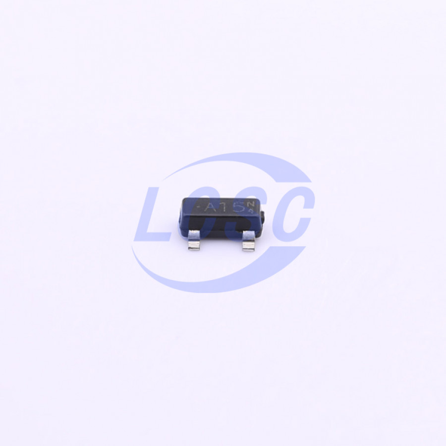

              I agree it is a PJA3415, here is a picture of one
