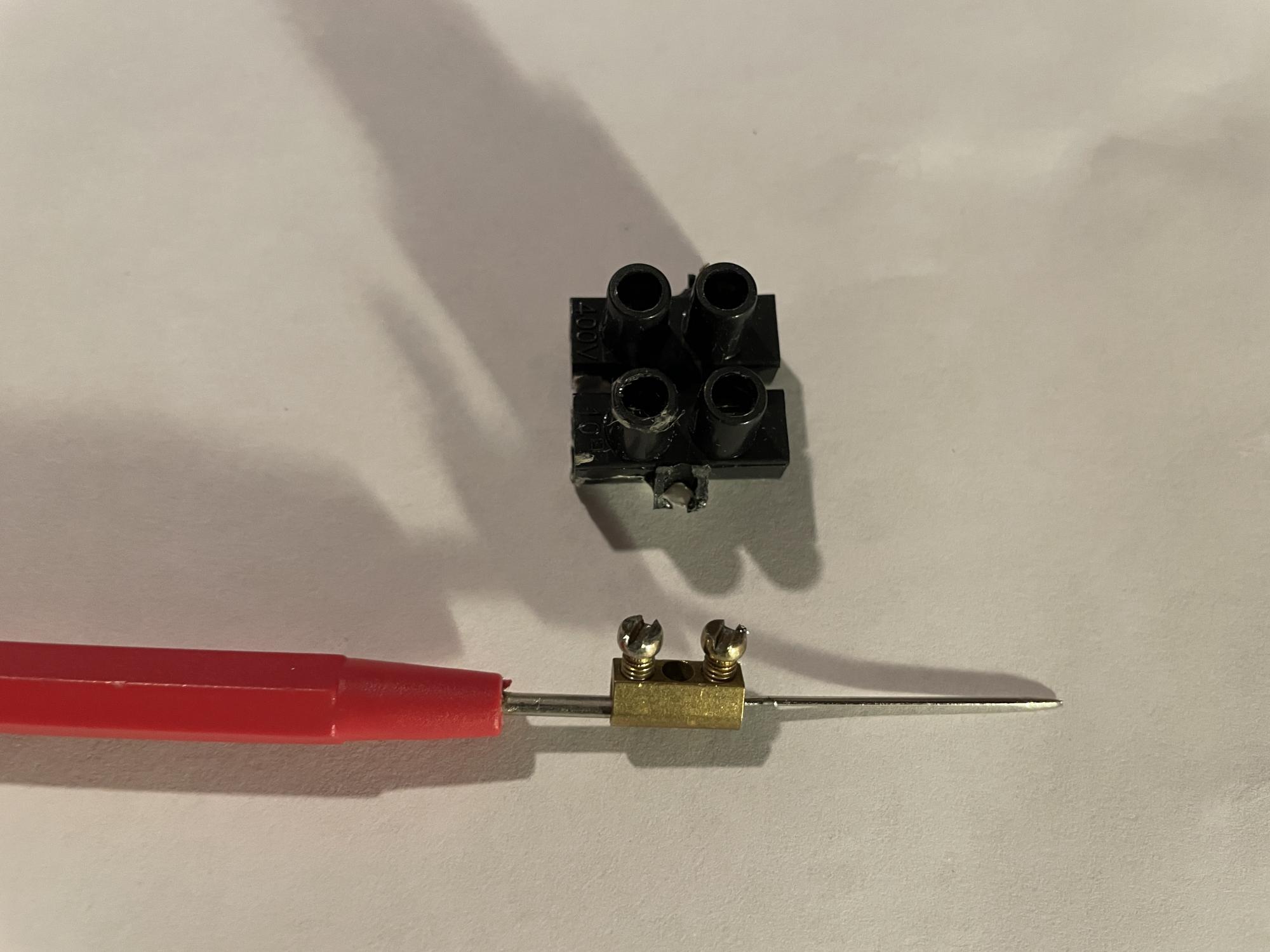

                                    Next time be careful , for the multimeter probe Connect wire connector to the front of the probe 1st screw probe 2 screw Swing needle so you can test pin point any pin IC look the pic

                                      There are needle sharp probes available in plenty for multimeter.

                                        Re: Acer 5740 no power
                                        Originally posted by Techtiger
                                        No worries this is how we learn Even I did this mistakes at the beginning
                                        Thanks !!!
