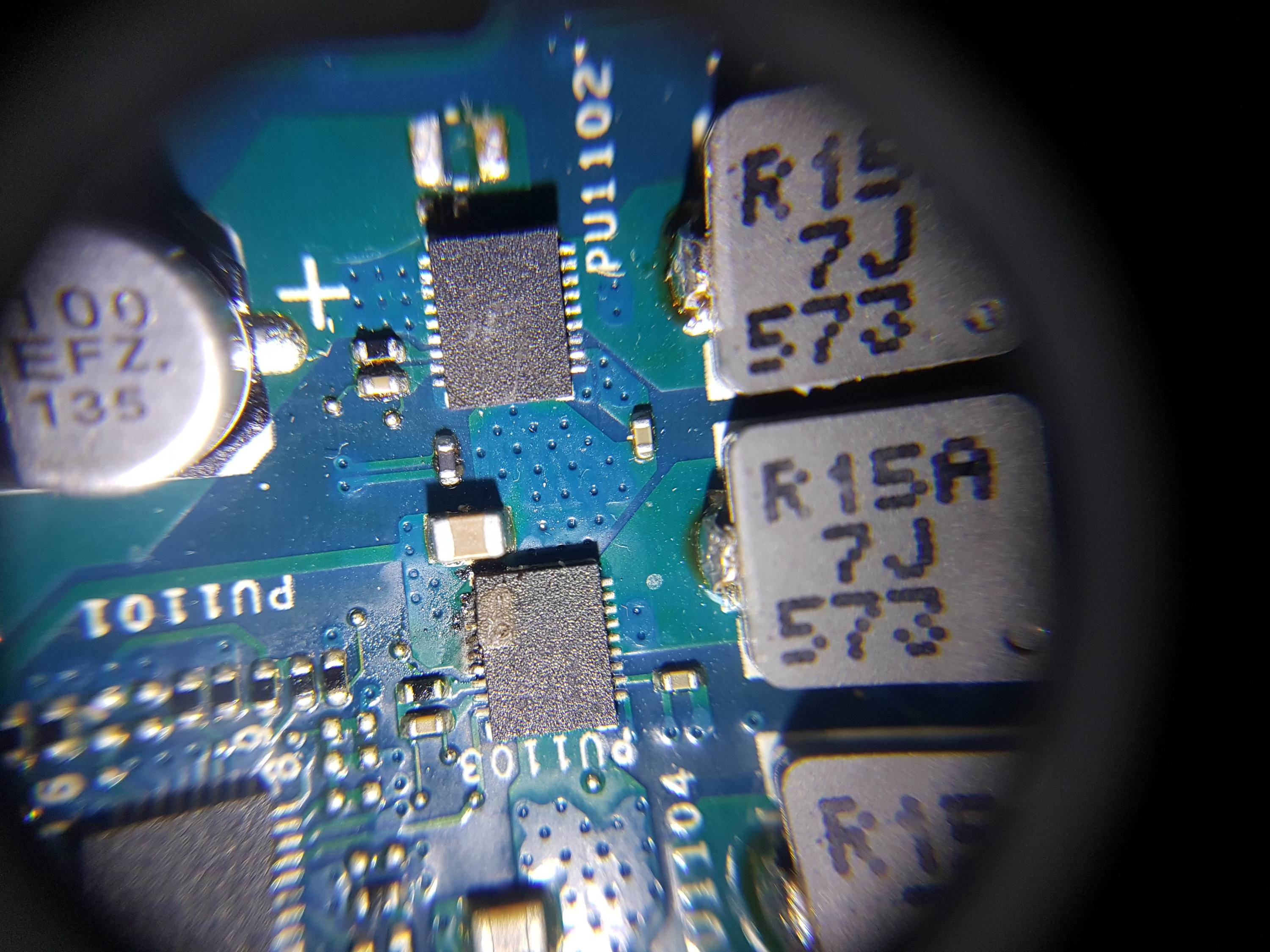

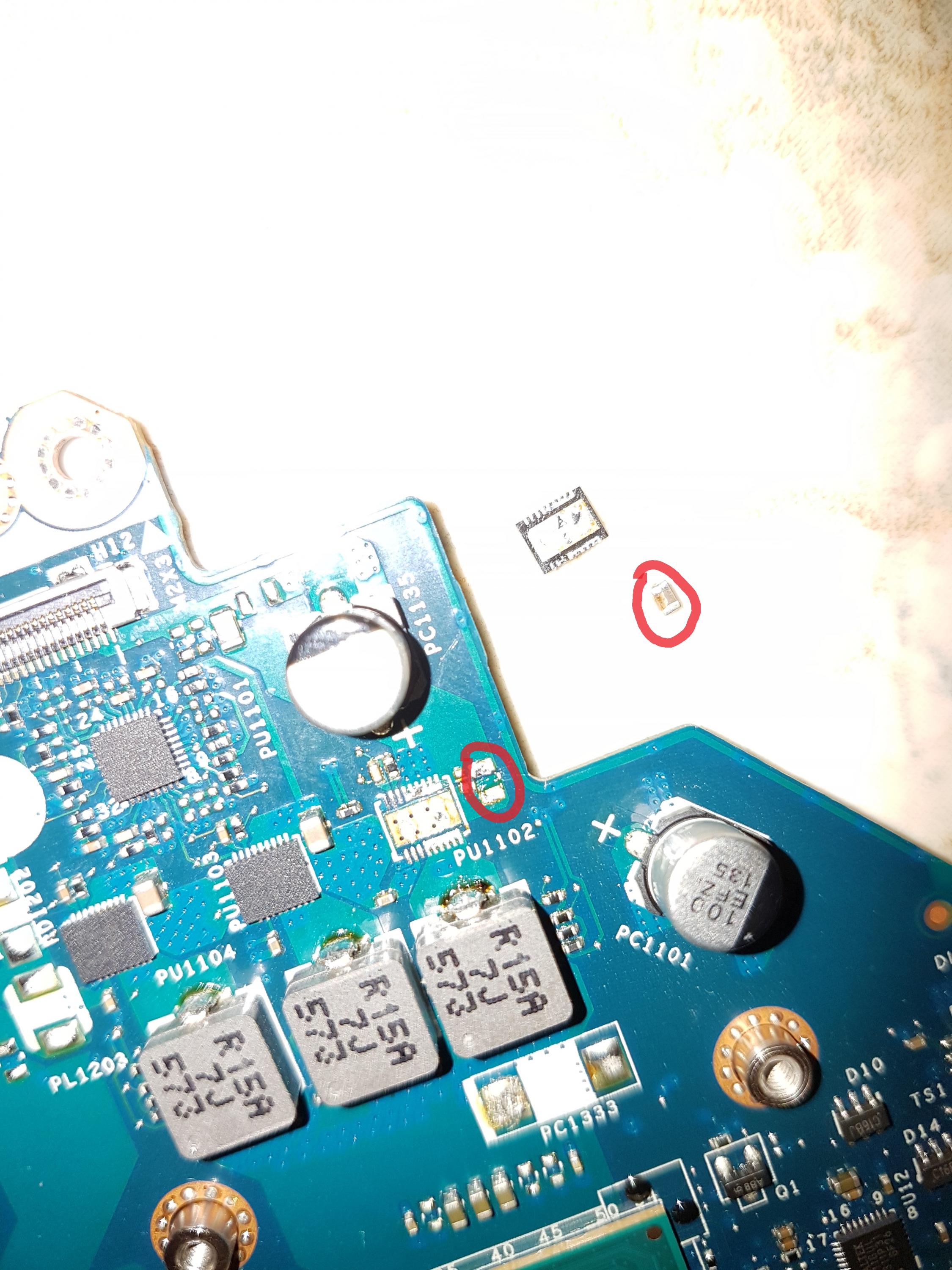

                            After a few more minutes injecting 1V, i found that PU1102 get pretty hot and keep heating up. PL904 and PC1135 get a bit warm (just a bit compared to PU1102).
                            Actually it's not my customer laptop, it's my cousin. And yes, it's my first time so forgive me is i often make stupid mistake.

                              - Remove PU1102, then measure resistance on PL301 vs GND, should be (hope) high value of resistance. hope we found the culprit.
                              - Also get attention to PL904 why become warm...:think:....
                              - Keep in mind don't apply power to the board till the shorted has gone.

                                  hello, i just removed the PU1102 but the the problem still exist. resistance between PL301 and GND keep showing just 1,3 ohm.
                                  So i inject 1v again to PL301, the board draw 1,34A from the PSU, and i start searching which component heat up. I found that the component beside PU1102 got pretty hot so i decided to remove it.
                                  After remove that component(i guess it's a ceramic caps?) PL301 doesn't seen shorted anymore, it shows about 5 mega ohm but the meassurements keep moving. i inject 1v again and my PSU show 0A drawn to the board.
                                  1. What component is that?
                                  2. Is this component the real culprit?
                                  3. is there any possibilities that PU1102 still in good condition? (at the first attempt PU1102 heat up also) or maybe both PU1102 and this component bad?
                                  4. does what i did until this step correct?
                                  i attach a picture of the component.
                                  Still. thank you so much for guiding me this whole time
                                  • meritosari
                                    • Oct 2010
                                    • 774
                                    • Indonesia
                                    Re: Lenovo Y50-70 Completely dead, no lights at all.
                                    1. I'm pretty sure it was ceramic caps 10U_0805_25V6K (PC1118 or PC1119, you'll see other one on top side mobo near PL1106).
                                    2. I think YES. Need more test/check to ensure it
                                    3. Put PU1102 back to M/B then check again resistance on PL301. Also check pin to other pin should have no contact (one by one) see datasheet for knowing the pin out.
                                    I think the possibility still good, maybe only impact when you was inject more than 1 min.
                                    4. Pray and test, try connect with original adapter, and see the result.
                                    original adapter have feature to cut out immediatly when shorted detected.
                                    5. Good luck.

                                      Hello my friend, i've put back PU1102 to the board(hopefully soldered well :p)
                                      1. it seems no more short in the board.
                                      2. Plug in the AC adapter, 20V can now past through PQ302
                                      charging light now light up
                                      3. Can i try to power up the laptop without that ceramic cap? is it ok?
                                      • didutgendut
                                        • Jun 2017
                                        • 20
                                        • Indonesia
                                        Oh man, i screwed up again. after few minutes charging the battery PU1103 seems blown up.
                                        1. Is it beacuse i plug the ac adapter without the ceramic caps on the board?
                                        2. i should remove PU1103 and check for the short again right?
