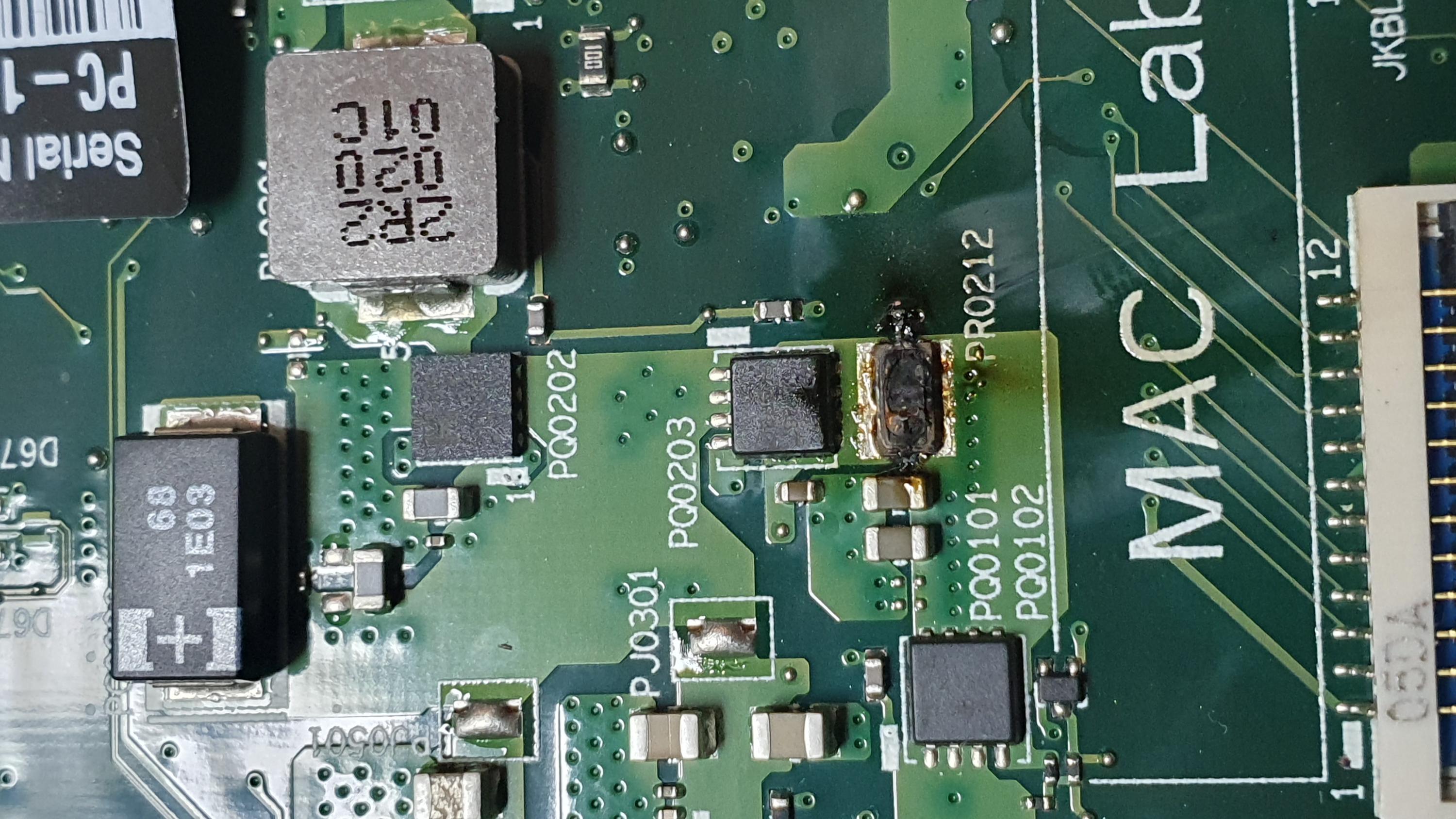

    Hello!

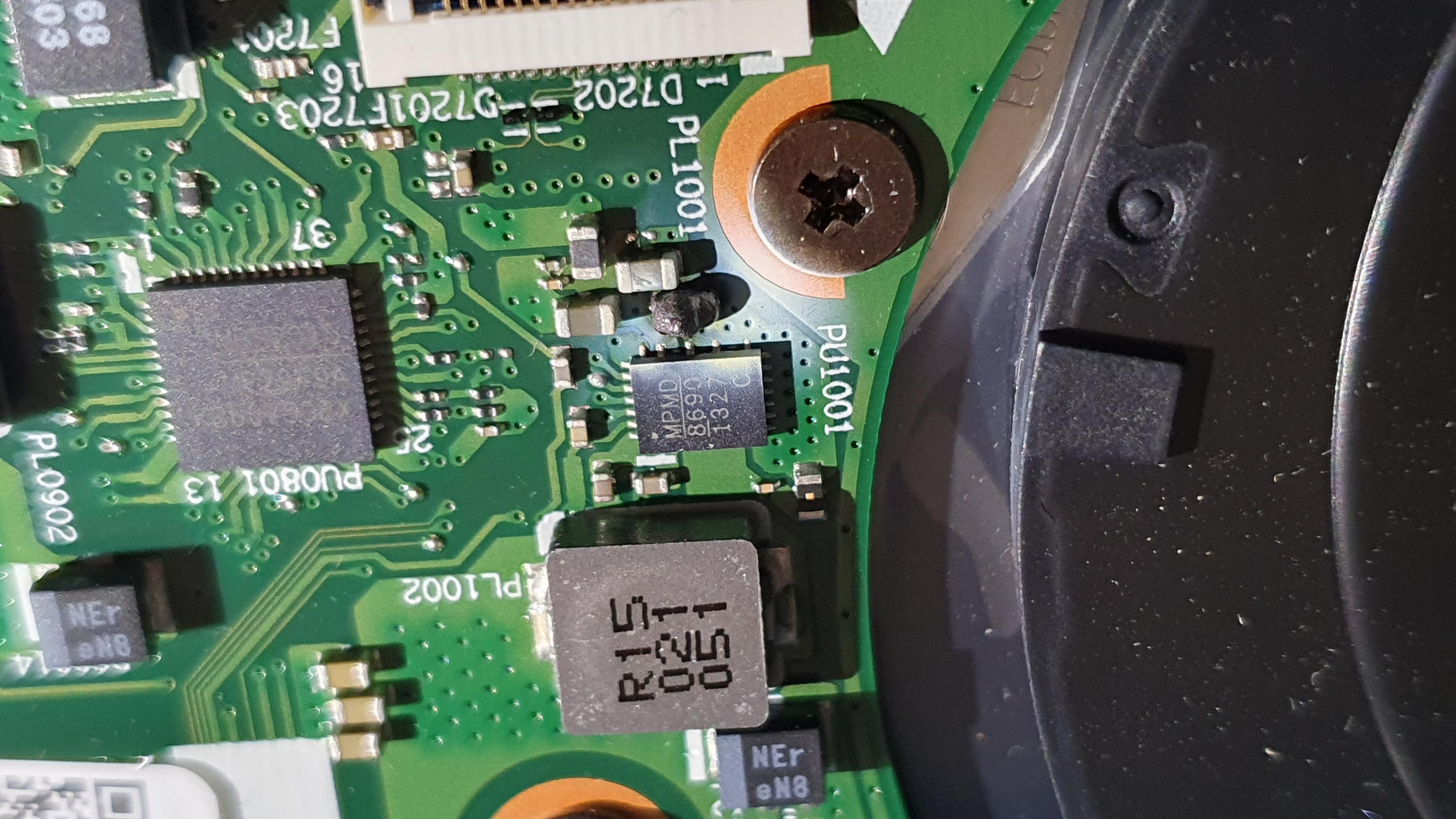

    I received a fantastic T490s that is completely dead, after i removed the back cover i noticed a totally fried cap (attachement) pic, i remove it and cleaned the pcb, seems undamaged, although the nearby caps are shorted, PU1001 looks physically undamaged.
    Any advice please?
    Thank you in advance!
    Scehmatics, boardview and damage picture in attachement.

    Also find fried PR0212.
    The fried cap was PC1002.
    The shorted caps are PC1004 and PC1005

      VSYS15 pretty much goes everywhere. You need to use 1V voltage injection and thermal camera. Feeds all DRMOS IC's for the CPU/GPU so you need to be pretty careful not to exceed a volt if any of them are shorted.
      PR0212 is a current sense resistor for the battery. Can't believe that is burnt up when it is rated at 1W and 10 milliohms.

          I plan to inject 1v and 1a at two pins of the burned cap.
          Is this correct?

            you can inject the voltage anywhere on the shorted rail. - on ground (screw holes do have a big ground layer for example). + side on vsys side on any cap or coil for example. inject more amps, start with 2.5 a and check if you can locate the shorted component with ipa or thermal cam. did you check the mosfets with diode measurements?

              I only checked the mosfets next to PR0212, no short with GND.
              I plan to inject 1v and 1a and try with thermal camera but if you want to check some mosfets first then t will be my pleasure.

                ok, so you do have a thermal cam, that's good. go for the injection, rise the amps until you can locate the shorted area(s)

                  I don't see anything heat up with 1v 1A
                  Should i increase or it's dangerous for CPU?

                    I proceed with 1V 2A and found PC1201 shorted.
                    Replaced them both but i can't find replacement for PR0212.
                    Any suggestions?
                    Also now the shortcircuit is gone, should i check any mosfet or anything else or we are fine?

                      PR0212 is bad? are you sure, measure resistance between both ends and tell us the measurement (no power/no battery). do the same with the mosfets (PQ0203, PQ0202: gate <-> source <-> drain <-> gate) nearby, but in most cases they should be fine. hopefully you fixed it

                        One end 150kΩ, the other 0.8ΜΩ.
                        Yes PR0212 was totally fried, check attachment above.
                        What can i do to replace PR0212, can't find anywhere 1w 10mΩ SMD resistance.

                          if you want to do it very dodgy do a solder bridge. no spare boards with this resistor? it's the same on every laptop (near dc in or battery).
