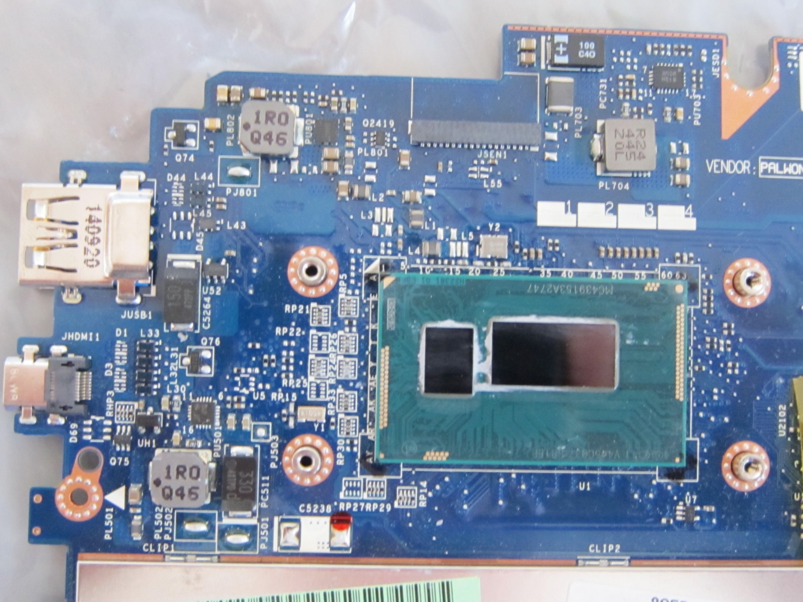

    i need request for bios clean for this.
    problem: No display and light only on keyboard
    Lenovo Yoga 2 13
    Mobo: LA-A921P
    5B20G19198
    Thank's

        It's 5 seconds LED on and I have a board with the same issue. If somebody has an idea what to to.. I would me more than happy.
        I checked 19v, 3.3v, 1,35v, 5v... all on.. CPU 1.68v is also coming up.
        It's consuming 0.06 till 0.010 Amps in IDLE. And while power on (till power off in 3-5 seconds) 0.280 amps.

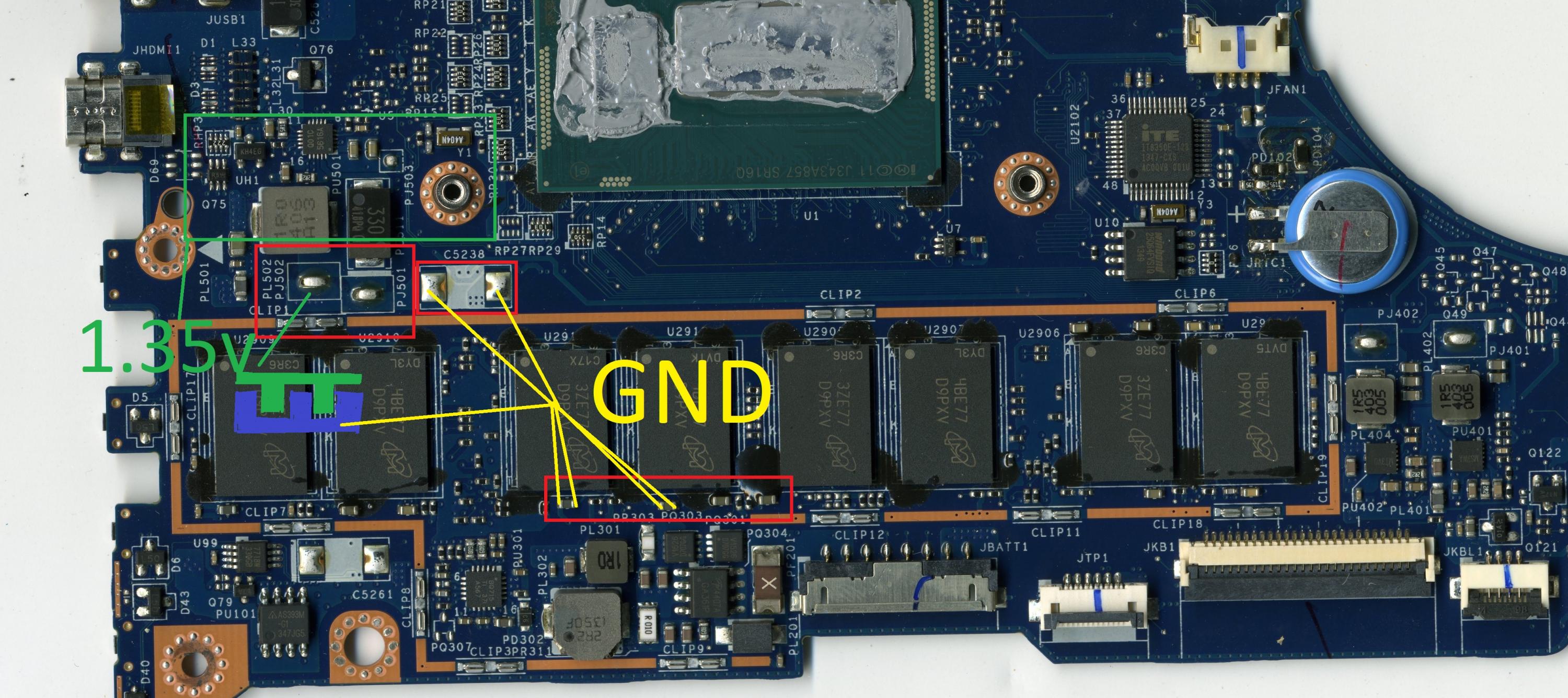

                              Re: Lenovo Yoga2 13- No display and light only on keyboard
                              btw. I think I was wrong about 1.35v rail. Sorry for the faulty hint.
                              I'm pretty sure it's shorted.
                              unfortunatly the ram is soldered.

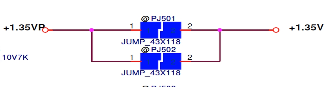

                              I made a picture with the powerline
                              There are 2 bridges (underneath they look the same) I removed them and than the short on the power supply side is gone (green).
                              I attached 1.35v and 3A to the grounded side (marked in blue) it draws 0.6v with 3A. I also tried with 5A (think it was 1v) but nothing really gets warm. Something should get warm but I can't feel it by hand or by evaporating alcohol. 5w should be enough to get something warm, but I couldn't find anything warm, so maybe it's really a RAM chip which can dissipate the heat too good?!
                              And of course more than the 4 caps in the red rectangle are shorted. They are just examples.
                              Any recommendations?
                                I dont think they are shorted as depicted in your pic-since ram is onboard they are showing short.
                                • Pferd5
                                  • Mar 2018
                                  • 68
                                  I messured the ressitance on the caps again and they are 0 Ohm. I also messured on a T440s (4GB onboard) and one some caps I get something about 100 Ohms. As far As I understand the repair logices (so far) there is a short on 1.35v. I'm more than open to test any recommendations what to do next.

                                        I think there is a caps failure in the 1.35v line. If ram chips had short circuits, they would have been warmed up. It should be very troublesome to control ram chips by removing them one by one. It should also find a guide to cancel ram chips.
                                        I'm not happy to be so strong. because it's not humanly
