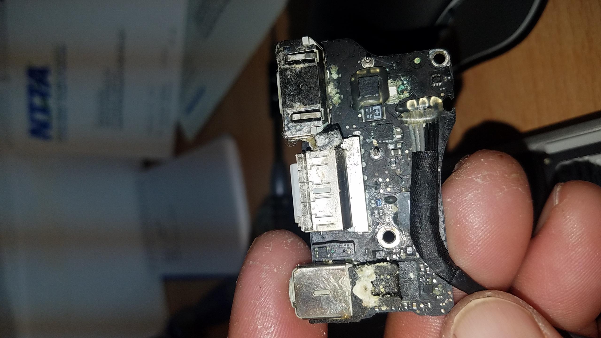

    Hello Fellas.
    First I know a good english writer but I hope you understand my problem.
    I have a Macbook Air A1466 (June 2012).
    This laptop belong to my niece that she spilled hand sanitizer.
    The laptop now is not charging.
    So far I check that the dim light on magsafe charger is off.
    and so far I check the next points.
    1. The voltage on i/o board get 15v
    2. The battery connector received 8v without connect to the battery and .2v with the battery connected.
    3. I proceed to change the battery and I get on same connector 8v with the battery already connected. (so battery problem solved, I guess)
    4. Now I still doesn't have light activity on magsafe and the laptop show not charging.
    5. I used another good conditions magsafe and light turn on for couple seconds and turn off.
    6. The magsage charger from my niece I used on my son laptop is working properly.
    So,
    What you guys recommend ??
    Change the i/o board only?
    Change the Logic board?
    Do nothing. (very expenses, special the logic board)
    You opinion is very important
    Thanks.
  • crdz66
    • Nov 2012
    • 242
    Re: Macbook Air A1466 No charging
    someone to know which component do I need to check on the rail g3hot for to make the magsafe turn the light on?
