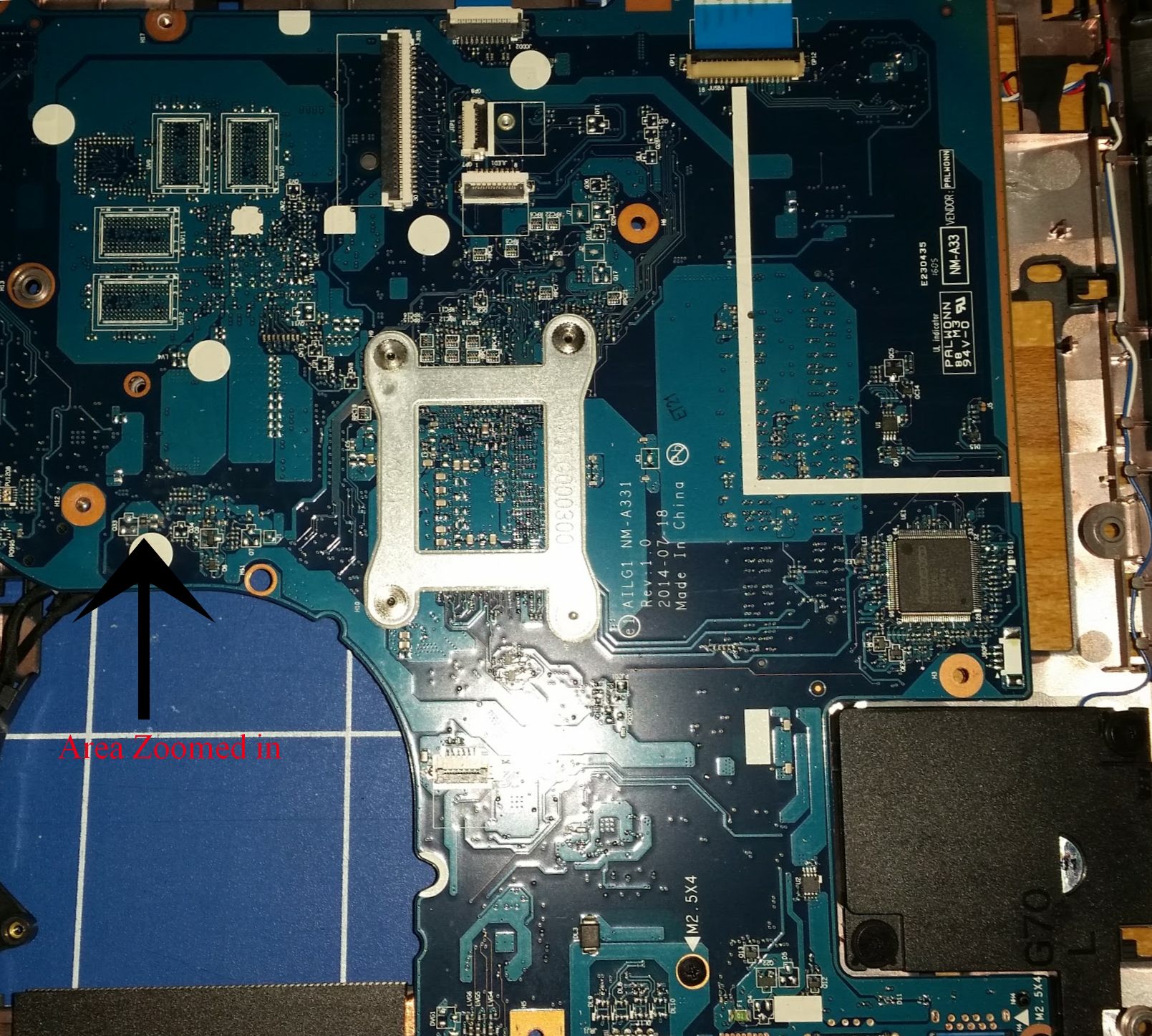

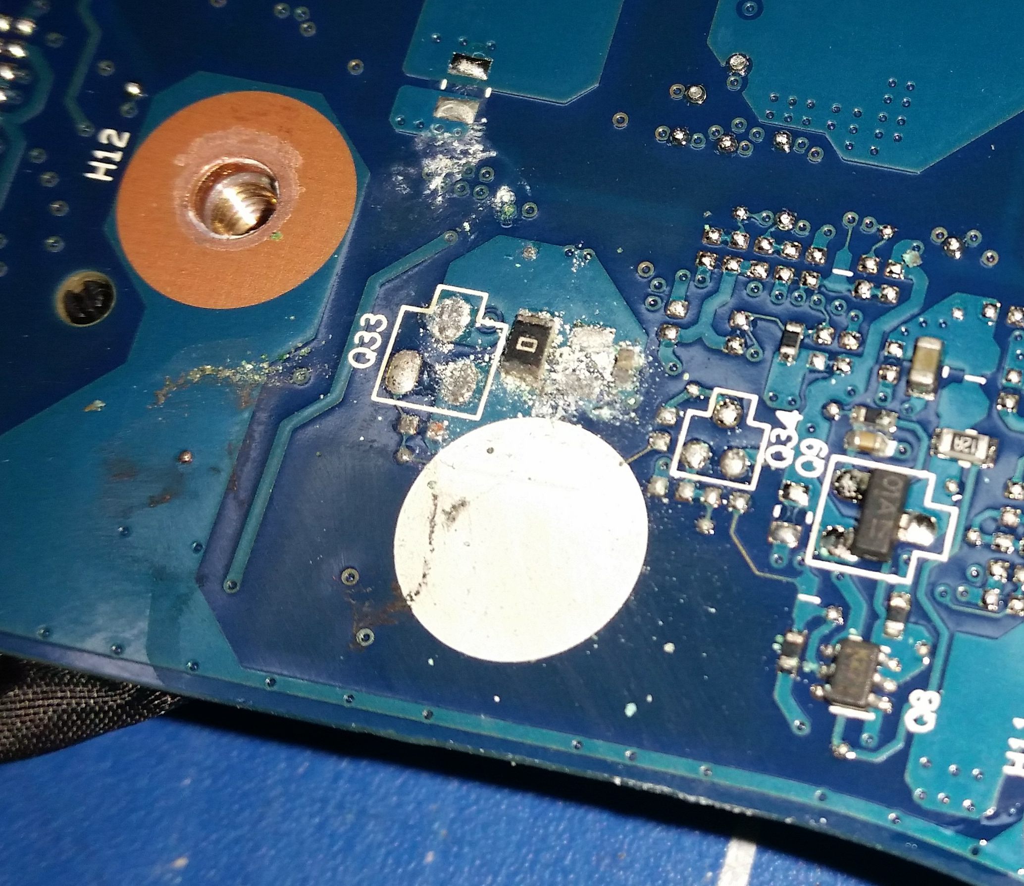

    Hi, i have an issue with a Lenovo G70. It has had liquid spilled on it and as a result there was corrosion over the components in photo. At first the screen would brighten when the on screen slider was pulled into the dimmest position and dim when the slider was pushed in the opposite position. After cleaning the area with isopropyl alcohol and a soft cloth very gently the screen is permanently dull and no adjustment is possible. On the other side of the board from the damaged area is the screen cable so i am assuming that the components relate in some way to the screen issue. I think it may be a damaged / blown fuse. Could i ask if anyone could help in identifying the components and whether the issue is in fact anything to do with a fuse or otherwise.
    Thank you in advance.
    Regards Dave

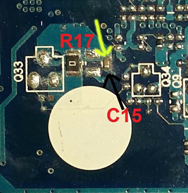

    Re: Lenovo G70 Screen backlight
    The fuse is the one with a 0 on it.
      Thanks for the quick reply, have tested and there is continuity? Cant be that that's the problem. I was thinking it was the one next to the arrow as this doesn't have continuity. Have you any iseas what may be causing the issue?

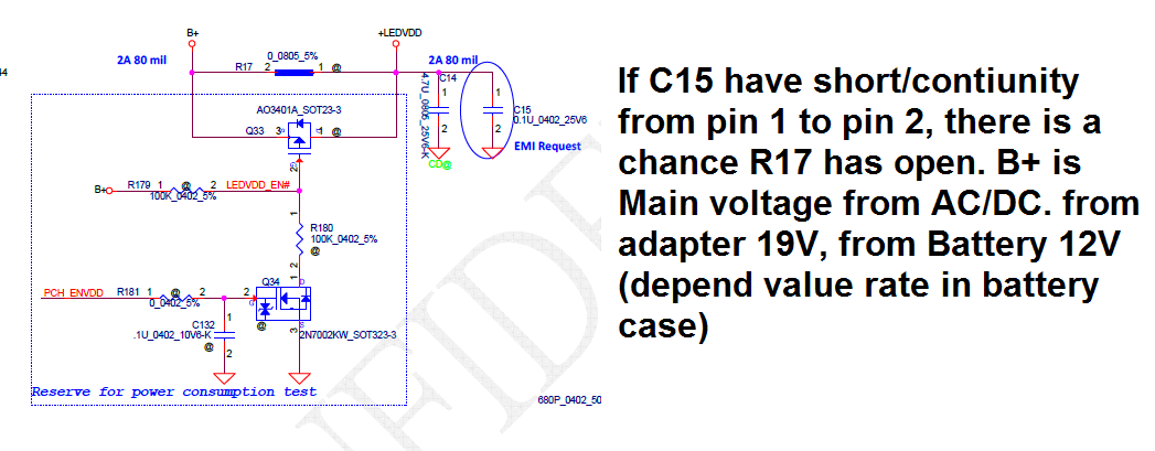

        That's a cap and clean up the board i have added a schematic goto page33
        and check.
            If C15 have short/contiunity from pin 1 to pin 2, there is a chance R17 has open. B+ is Main voltage from AC/DC. from adapter 19V, from Battery 12V (depend value rate in battery case)
            clean the board, remove and check C15, don't forget to check contiunity to the pad of C15 as well. if shorted has gone, replace R17 (if already open)
                I have thoroughly cleaned the board with isopropyl alcohol.
                Hi i have checked as best i know how. I have power to both sides of R17 and continuity. I also have power to the top side of C15 Yellow arrow but none at the black arrow side or continuity. Does this help at all. PS what do you mean by remove and check C15, i can remove but what am i checking for? Thanks again for your help.

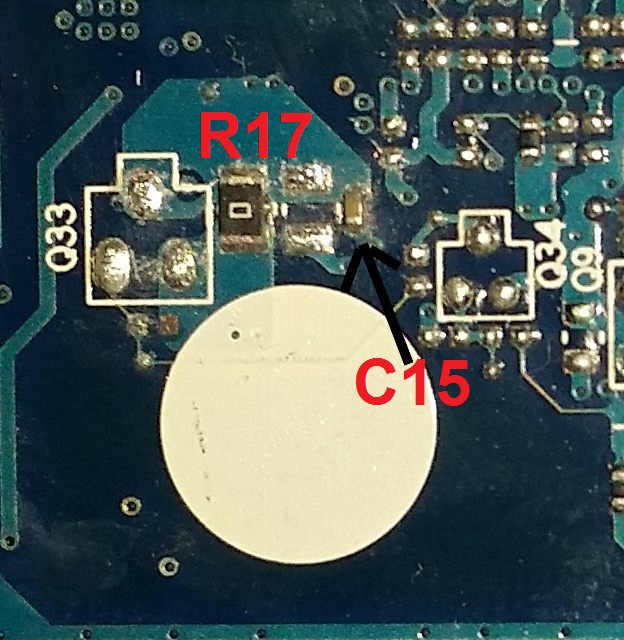

                  and check.
                  Hi, i have done some research and had help from another forum member. I have discovered that the capacitor (C15) is giving out a reading of 560 on the 2K scale on my multimeter. Occasionally it gives out 480, but very rarely. Could i ask what is the capacitors supposed value and if not correct where would i find a replacement.
                    Dave
                    So, B+/LEDVDD have no problems. Even without C15, the circuit should be working fine. Maybe the real problems was related with BKOFF# / DISPOFF# signal and INVT_PWM signal
                    you can read as reference here:
                    https://sites.google.com/site/lcd4ho...-led-backlight
                    https://sites.google.com/site/lcd4hobby/lvds-cables
