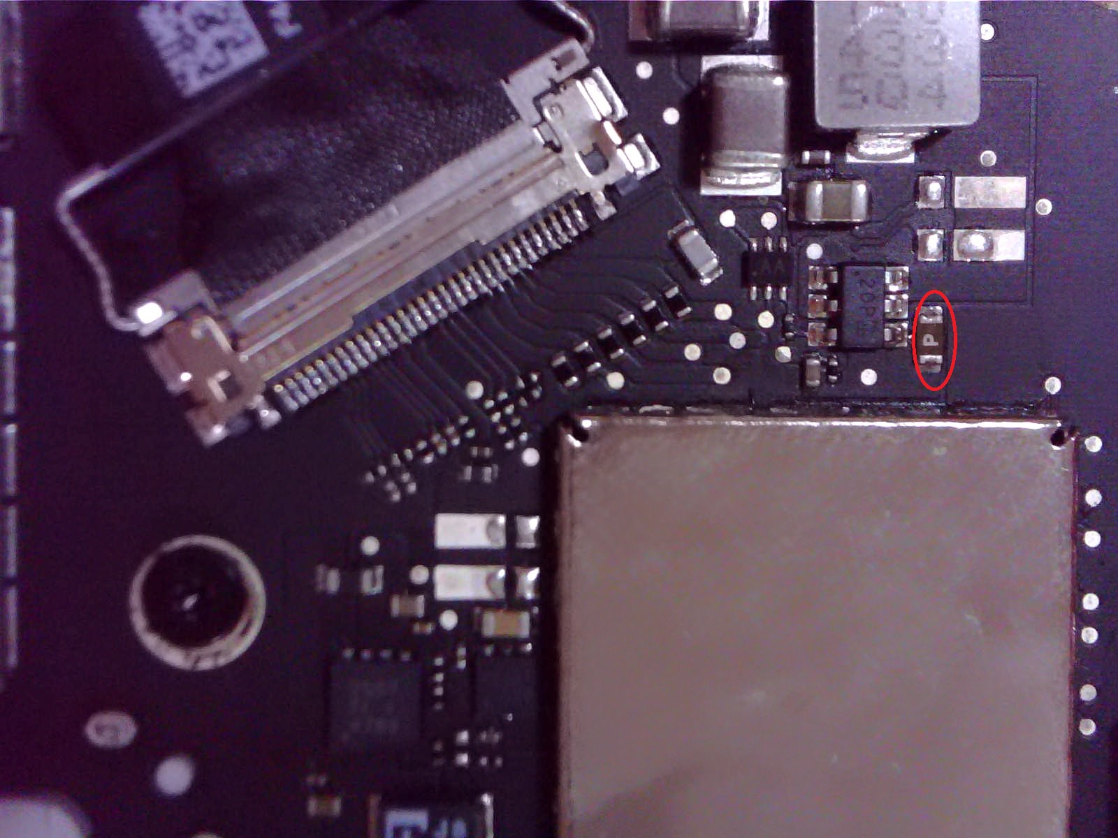

    I bought this dead mac with a No display faut, when checked i see that it's booting fine but with no back light .
    I found a Fuse (i think) near the lvds connector, but fuse is fine (photo).
    Any help about this issue is much apreciated.

      Re: Mac Air 2014 No Backlight
      Have you taken measurements off the LVDS jack?
      Is the backlight being told to turn on? Is there voltage to turn it on? What is the voltage?

        Do you have a boardview or schematics for this mobo ?
        Or which pin or component should i check for voltage ?
              It's usually not the fuse. Check out his video's on backlight repair ... led driver related. He's done several replacements of that driver, usually due to a feedback issue. Without feedback getting to the driver and/or an led driver issue, you won't get a back light.
              You'll need your 820 board number. And google ... you can find the schematics and probably a board view too. Watch this to give you an idea of what to look for. It's an older mac in the video, but same concept.

                All the others louis backlight problems videos, are with liquid damage boards, this one as not a liquid damage.
                What is your 820 board number ?
                  Liquid damage is not always the cause, and is not a requirement to have a fault. The video provided is a good reference for troubleshooting back light circuit problems.
                  You must find the "820-####" part number of your board. It's printed right on it somewhere. Then go google that number for a schematic/board view.

                      Have you tried another screen? you don't mention that test.No backlight faults are moust common on the screen because of faulty cfcls or leds depending of the type.
