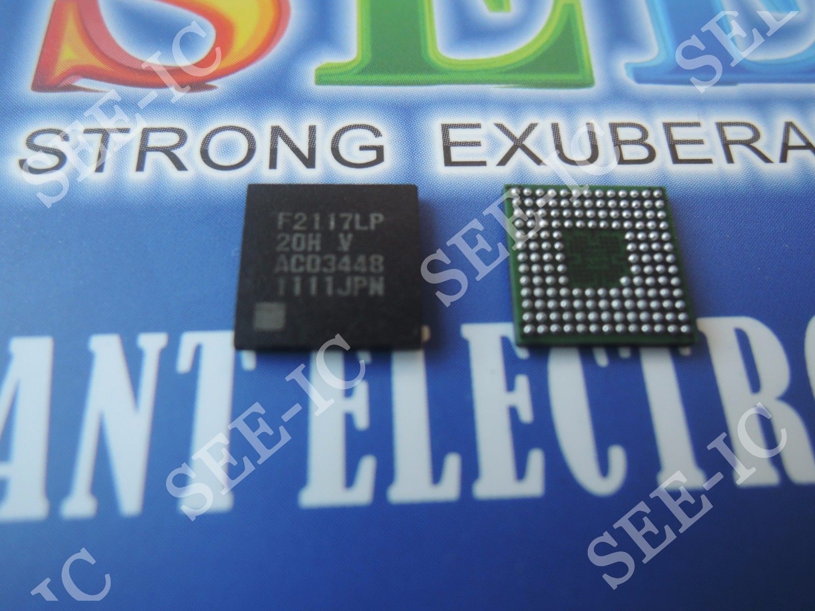

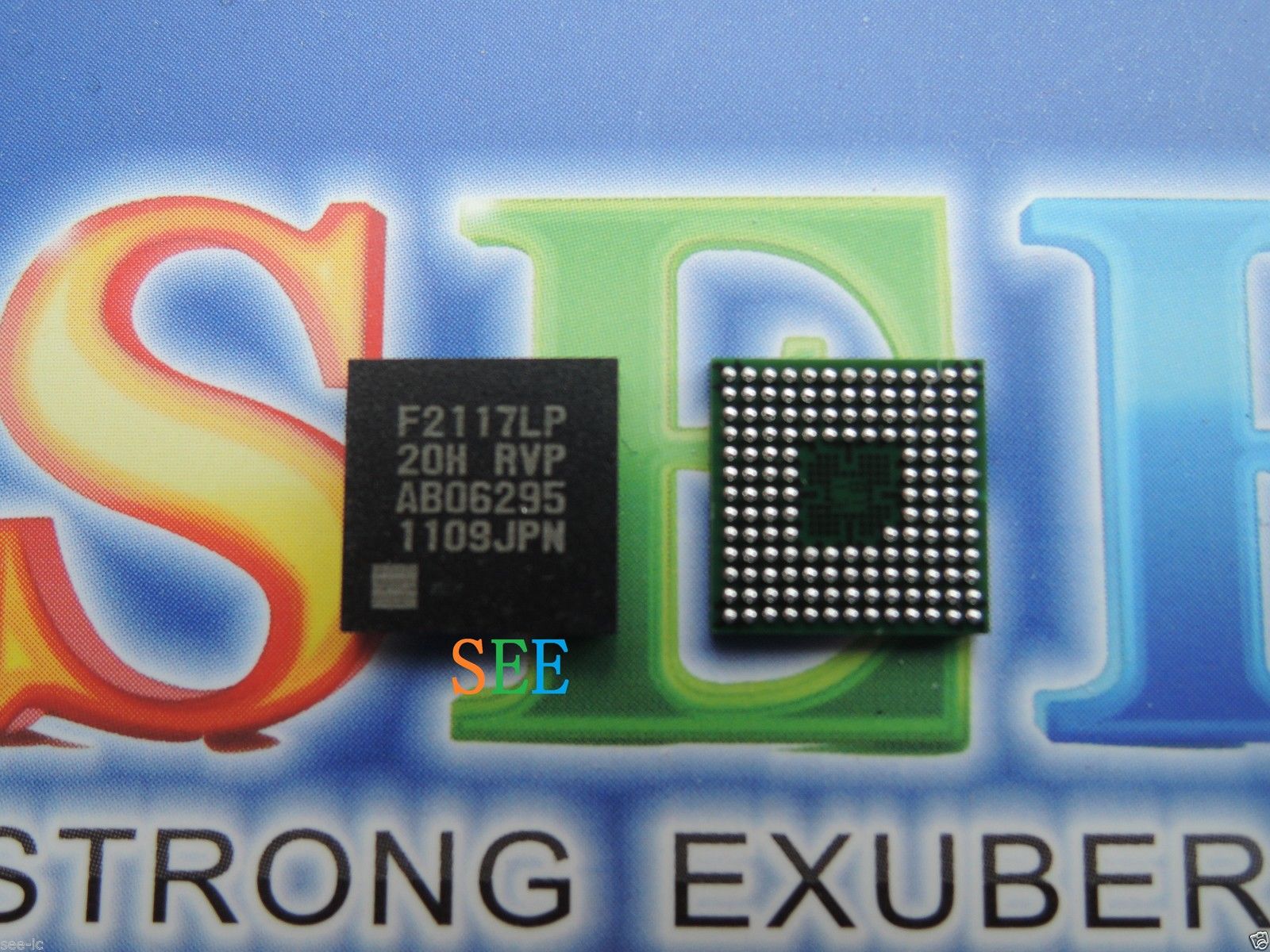

                                    • raajkumar
                                      • Mar 2015
                                      • 354
                                      • Srilanka
                                      Re: Apple Macbook Pro A1278 no Power
                                      I think i need to replace smc. Do i need to get pre programmed SMC and also i found two types is it same ? F2117LP20H V and F2117RVPLP20HV . My Logic board have F2117RVPLP20HV.
                                      • dellxps15
                                        • Feb 2014
                                        • 1588
                                        • italy
                                        it could be a bad smc. u need a second hand smc from a spare board.
