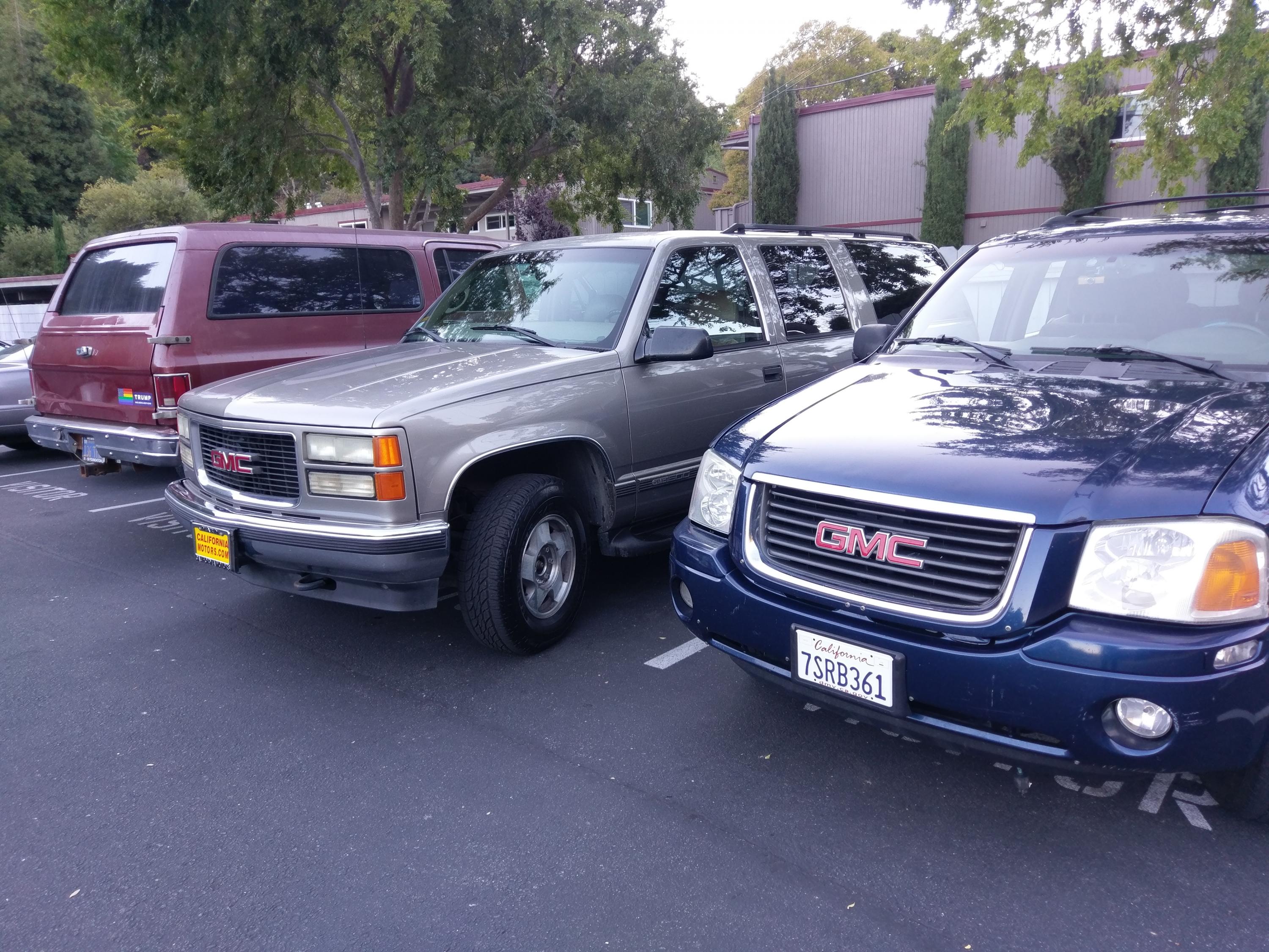

i can't ATTACH FILE
  • masud
    • Jul 2011
    • 317
    • Bangladesh
    i can't ATTACH FILE
    Noe a days i can't attach any file.
    any idea/ advice please
  • ala_borbe
    aka Donald
    • 1625
    • Malta
    Re: i can't ATTACH FILE
    write to admins
    Im Back... sort of...
    • shovenose
      Send Doge Memes
      • Aug 2010
      • 6575
      Re: i can't ATTACH FILE
      Are you getting any error in particular? It seems to be workign OK.
      • masud
        • Jul 2011
        • 317
        • Bangladesh
        Re: i can't ATTACH FILE
        says invalid format while attaching any file
        • selldoor
          Slow Learner
          • Dec 2010
          • 7870
          Re: i can't ATTACH FILE
          Post the name of the file you are trying to attach and the size - may give us a clue.
          Try and attache a small picture of anything to your reply.
          • ala_borbe
            aka Donald
            • 1625
            • Malta
            Re: i can't ATTACH FILE
            it must be supported format to attach
            see list
            Im Back... sort of...
            • m1ch43lzm
              Notice to users of XGecu TL866II Plus / T48 / T56 / T76 programmers regarding BIOS backup file size
              by m1ch43lzm
              Hi everyone
              I noticed on the Xgpro software the BIOS backup files have extra bytes at the end when reading some chips, this is because the Xgpro software also reads the OTP region of those flash chips, and by default will append that region to the saved file
              Programmer models: XGecu TL866II Plus / T48 / T56 / T76
              Example: GD25LQ128D (1.8V), IC size is listed as 0x1000000 Bytes (16777216 bytes) + 0xC00 bytes, those extra 0xC00 bytes will be appended to the end of the saved file by default, resulting in a file size of 16780288 bytes
              There's also an extra OTP Secu.R...
              09-06-2025, 05:47 PM
            • Forest79
              Lenovo ThinkStation P520 BIOS file needed
              by Forest79
              I got a Lenovo ThinkStation P520 (Type 30BF) from a friend, asking me for a repair. Windows 11 offered a firmware upgrade as an optional update, and it failed.
              The emergency flash procedure from the hardware manual has also failed. So, I asked an acquaintance with better skills to flash the BIOS directly.
              However, the chip (a Macronix MX25L25673GMI-08G) has a size of 32 MB, and the BIOS file from the Lenovo website (extracted with UEFITool) has a little more than 16 MB. Thus, the software my acquaintance used (SiberiaProg v1.45, with a CH341A Programmer)...
              07-23-2023, 07:39 AM
            • elmoori
              .FD BIOS file for AN515-56
              by elmoori
              I’m trying to recover my Acer Nitro 5 AN515-56, which currently has a corrupted BIOS and won’t boot. I’ve searched Acer’s website and all I can find is the official BIOS update .exe file.
              Inside that .exe, I managed to extract a file called abobios.bin, but there is no .FD file available — the one needed for Acer Crisis Recovery.
              I’m looking for someone who has the original .FD BIOS file for this exact model, or any guidance on how to extract it safely from the official update.
              Today, 05:34 PM
            • hazem3636
              need Bios Bin file Dell server 220
              by hazem3636
              hi everyone
              i need dump file for dell server r220
              i have download Flash BIOS executable file but i dont know how to conver it to Bin file
              i have check on youtube there is some programs are doing this method of creating Bin file from ExE file .
              if anyone has this method please need his supporting .
              all the best
              EXE file is attched and Original Bin file from the Bios Chip is attached also
              and dell website "https://www.dell.com/support/home/en-us/drivers/driversdetails?driverid=mrxv...
              11-05-2022, 06:20 AM
            • Sebastian Codrean
              BIOS file for ASUS F542UN laptop
              by Sebastian Codrean
              Hello to all of you! I need help with a BIOS file.
              The BIOS chip is fried on my Asus F542UN laptop, and I bought a new chip that needs programming. I have a CH341a programmer but I need a .bin BIOS file. On Asus support page the firmware has another extension, .310 and from reading on this forum I understand that that file is not complete BIOS.
              So, in short I need the "complete" BIOS .bin file to flash on the new chip. Another issue is that on back of the case the label says F542UN but on the sticker on the motherboard it's X542UN.
              02-20-2025, 10:25 AM
