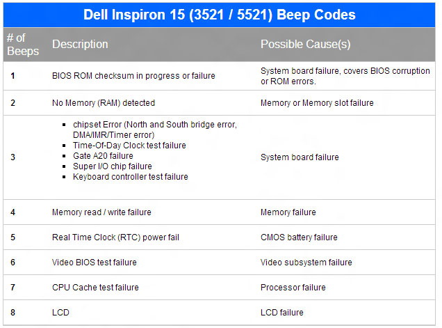

                      Changed SIO, laptop turns on with 3 beeps. Looks like PCH is dead.

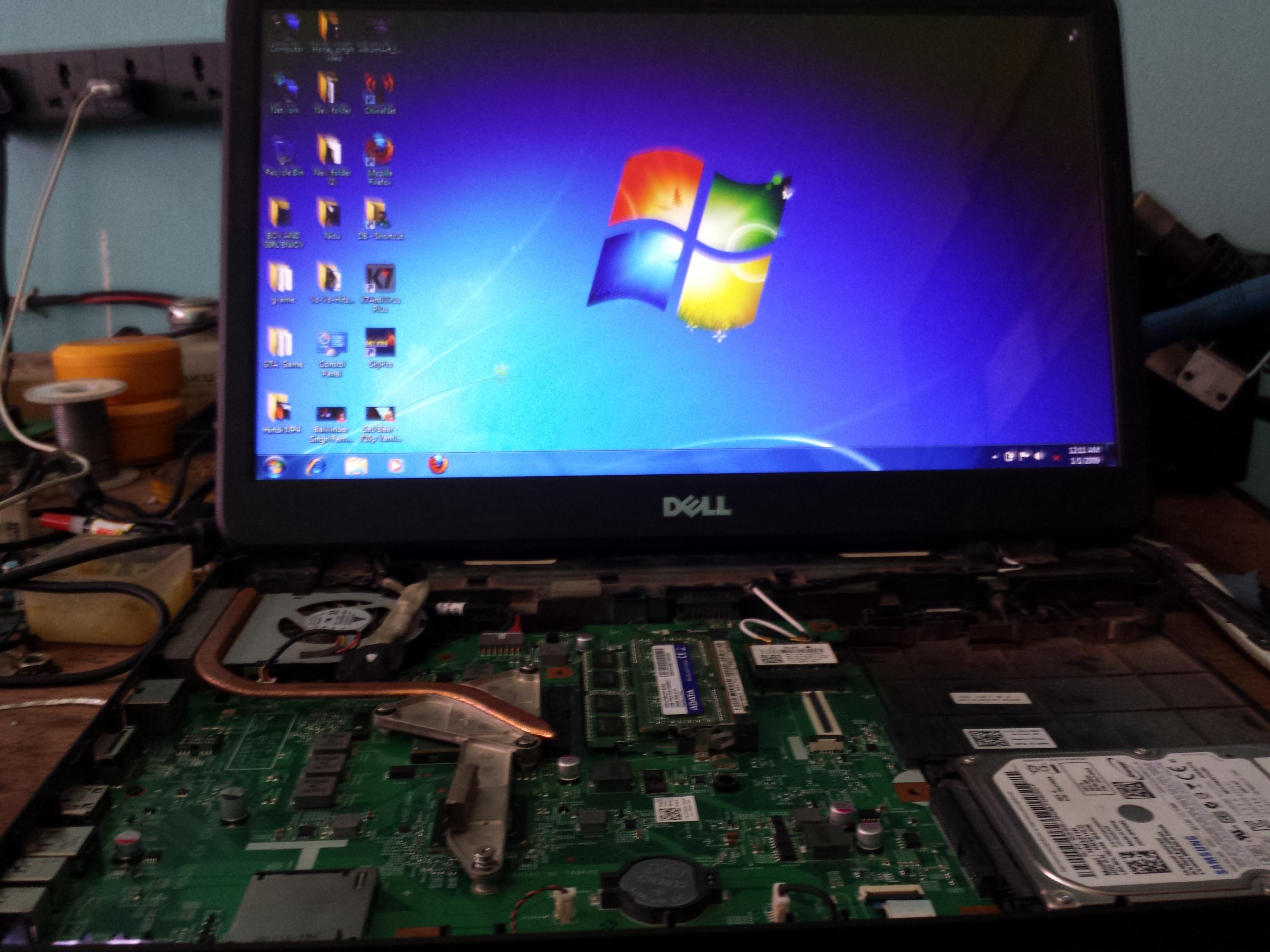

                          KBC new @ridamouh, all pins were good but I will look into it again.
                          Thanks btw.
                            Re: Dell Inspiring 15R
                            @ridamouh
                            You were right, thanks everybody specially @BlueMidnight
