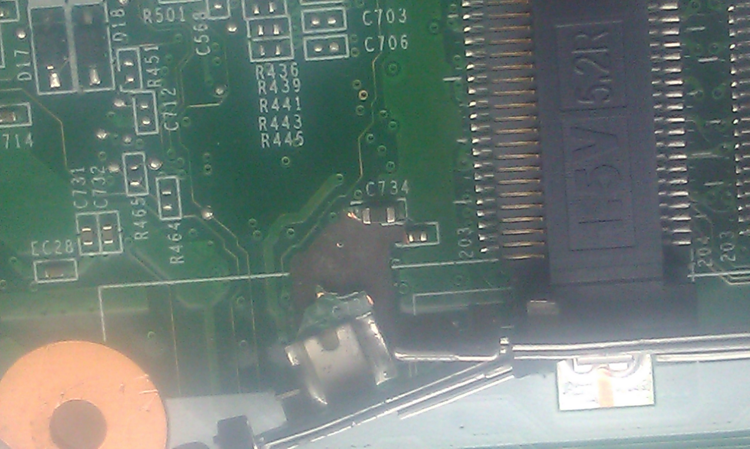

                            discovered a damaged piece on RAM socket, it looks like I can fix it.Let's hope so.
                            • bicalov
                              • Nov 2014
                              • 294
                              • Netherlands
                              Re: Palvilion G6-2000 will not turn on
                              Board fixed, no change in operation.
