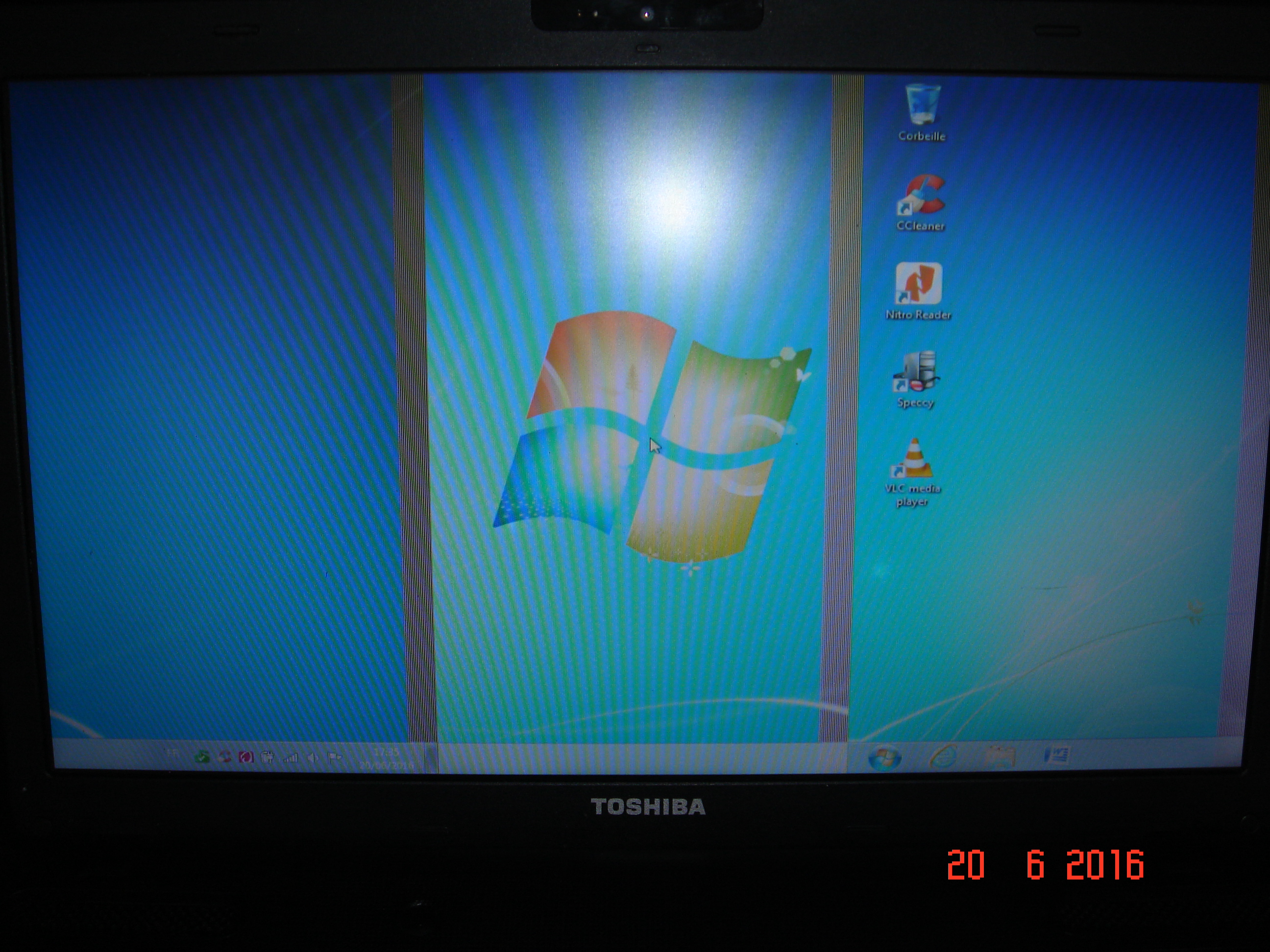

i have here a C660-13C, PSCORE-00300EFR with a wierd symptom, the main screen is divided on 3 parts (check photo)?
When received, i was getting a black screen, flashed main and ec, and pc turned ON.
First time the screen was fine, after a second reboot, i got the divided screen, reflowed BGA, this machine is uma, only HD graphics from Core I3 ship.
Is this a lcd screen problem or GPU related ?
For 2 ou 3 times it rebooted fine, no divided screen
It works fine on external (VGA)
