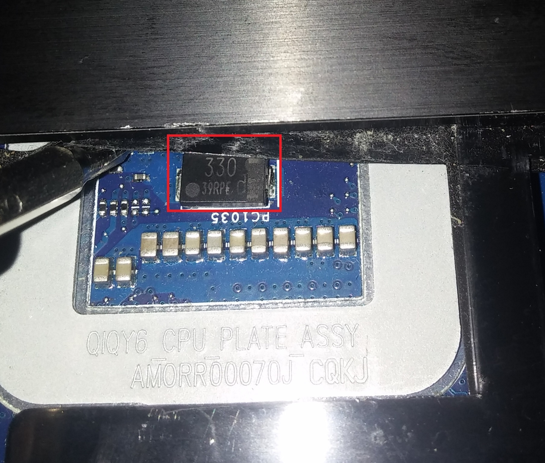

    Please Identify this (Levovo Y510P)
    broke a smd part on the laptop while disassembling. want to replace it
  • rievax_60
    • May 2012
    • 897
    • australia
    Re: Please Identify this (Levovo Y510P)
    It looks very much like the 330uf capacitor that some of us use to replace failed NEC/Tokin capacitors in many Toshiba models. search for 2R5TPE330M9 2.5V 330UF POSCAP. If you choose something else, be certain that the ESR is low, like 9 milliohms.
    • keyboardcowboy
      • Apr 2006
      • 73
      thanks, 2R5TPE330M9 shows positive polarity on the capacitor, but the part on the board only shows a thick white line on the right, does that line indicate positive?
      • TossDon
        AKA Masood
        • Jun 2013
        • 26
        Yes it is...
