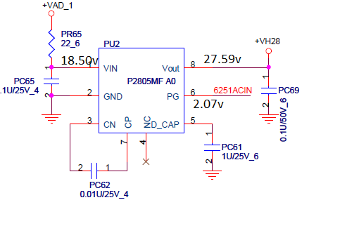

    HP G62 Quanta AX3 No power
    Have power until PQ47 (p. 25), 19v at drain but nothing else. N-channel fet needs high voltage to gate, correct? What components determine the voltage to the gate? Looks like PQ51 (have 4.8v at pin 2), PR155 (0 on both sides), and PR158 (29v on one side, 0 on other side). Would like an explanation if someone can. Thanks

        Re: HP G62 Quanta AX3 No power
        Yeah - maybe not in your case. ACOK# should be low to pull PQ47 gate up to 28V.
        Check DCIN, ACSET and EN pin voltages on ISL6251.
        Do you have a correctly working HP adapter (center pin AD_ID) should be about 7V when connected to mainboard?

          Have voltage on following pins of PU6
          1-VDD-5v
          2-ACSET-2.1
          3-EN-1.1
          8-VREF-2.38
          23-ACPRN-0
          24-DCIN-19
          Also have .9v on pin 3 (AD_ID) of DC_IN connector
          What should my gate voltage at PQ47 be?
            PQ47 gate should be about 28v when PQ51 gate is low.
            Check PU4 pin8 output.

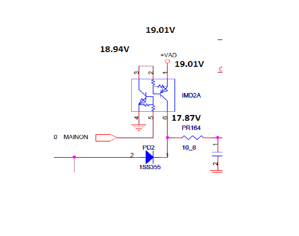

                      Can I put voltage to gate of PQ47 with my power supply? 28 volts?
                        i would remove pr155 and see what happens.
                        pq50 and pq47 gates are connected, so check pq50 also.
                        I don't like ad_id so low voltage.
                        Is any current drawn from adapter?
                        3.3V and 5V rail resistance not very low?
                        Does the machine work from battery?

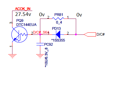

                            PR155 and PR160 and switch (PQ51) make up resistor divider which determines where the high voltage will be, depending on the switches state. Same for PR158 and PR155 and PQ7.
                            PQ 47 gate is driven by two signals:
                            #ACOK (that is at correct level coming from isl6251)
                            ACOK_IN (driven by #D/C signal through PQ7 coming from EC)
                            by removing PR155 you eliminate the other signal from control and you should have PQ47 open. What happens then will remain to be seen.
                            Strange is that the #D/C signal comes from EC, which should not be powered on yet and you have 0.9v on AD_ID, it should be higher.
                            So it could be a bad power brick, dead ec and so on.
                            You have not provided the current consumption, how much is it?
                            Also do you have any voltage on 3.3 rail - PL8?
                                        The source of the 26V on PQ7 is the +VH28, the voltage comes through PR158 and PR155 and then ACOK_IN either gets low or high value depending on #D/C signal status which is applied to PQ7 base.
                                        The marking # means that it is an active low signal - for example if we are talking about ISL6251A pin 23 - the ACOK# means that the AC is ok if the signal is logical low.
                                        The opposite would be ACOK meaning that AC is ok if the signal is logical high. What does the D/C means - not exactly sure, it is an output from EC.
                                        If you have tried another adapter and the AD_ID was still 0.9V then look at it closer - D16, R62, R61. Take comparsion from the working board.
                                        Measure current drawn from the + and AD_ID pins - use your multimeter current measuring (you can cut the wires from the dcjack if it is connected with cables to mainboard).
