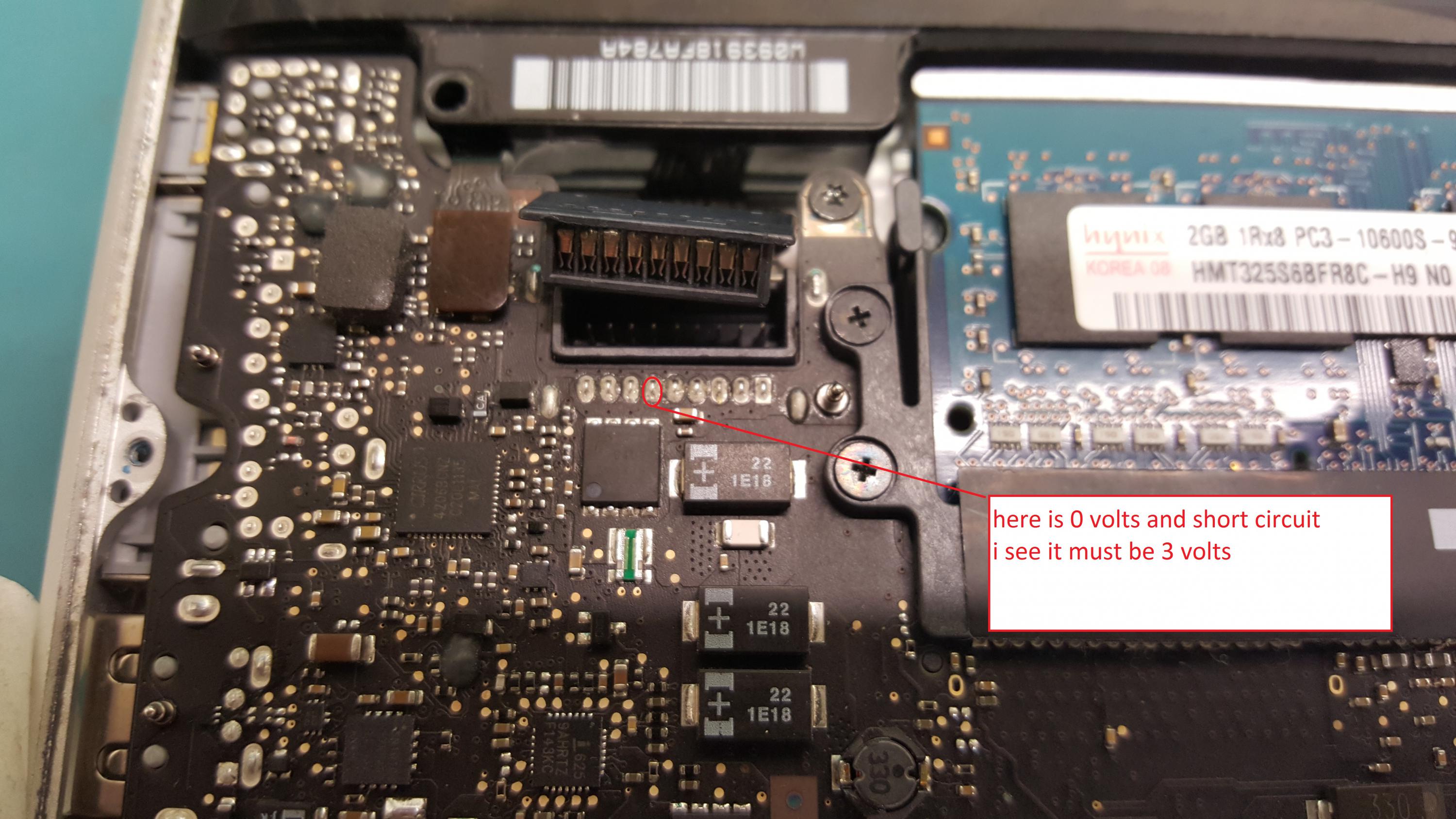

    UPDATE:
    there is a short circuit, please see picture

              Re: a1278 board 820-2936-b doesn't charge
              SMBUS_SMC_BSA_SDA is short circuit... 0 volts
              where can be the problem with it?
                correct schematic.
                check pin 10 of u7000 "SMBUS_SMC_BSA_SDA" if shorted.
                remove "BIL" cable and check again.
                if still short remove u7000 and check if still shorted pin 10 u7000.
                  pin 10 was shorted, removed u7000 the short was gone so i replaced u7000 (from another board) and now same short on pin 10
                    the short is made now from the bil cable, but if i disconnect it the led is same green and there is always the x on the battery icon
                      remove c6952 and check again.
                      if still short remove d6950 and check again.
                      edit: check also r6950 value if it's 10k.
                        the short is linked to the bil cable... i have ordered a new one.
                        but the led is still green
                          voltage on battery pin ?
                          r6950 ?
                            voltage on r6950 is 0v
                            pin 4 3.5 v
                            pin 5 0v
                            pin 6 3.5v
                            pin 7 12v
                            pin 8 12v
                            pin 9 12v
                            measures taken with battery connected
                              how many ohm ? and 0volt both side ?
                                10 k ohm and 0v on both sides
