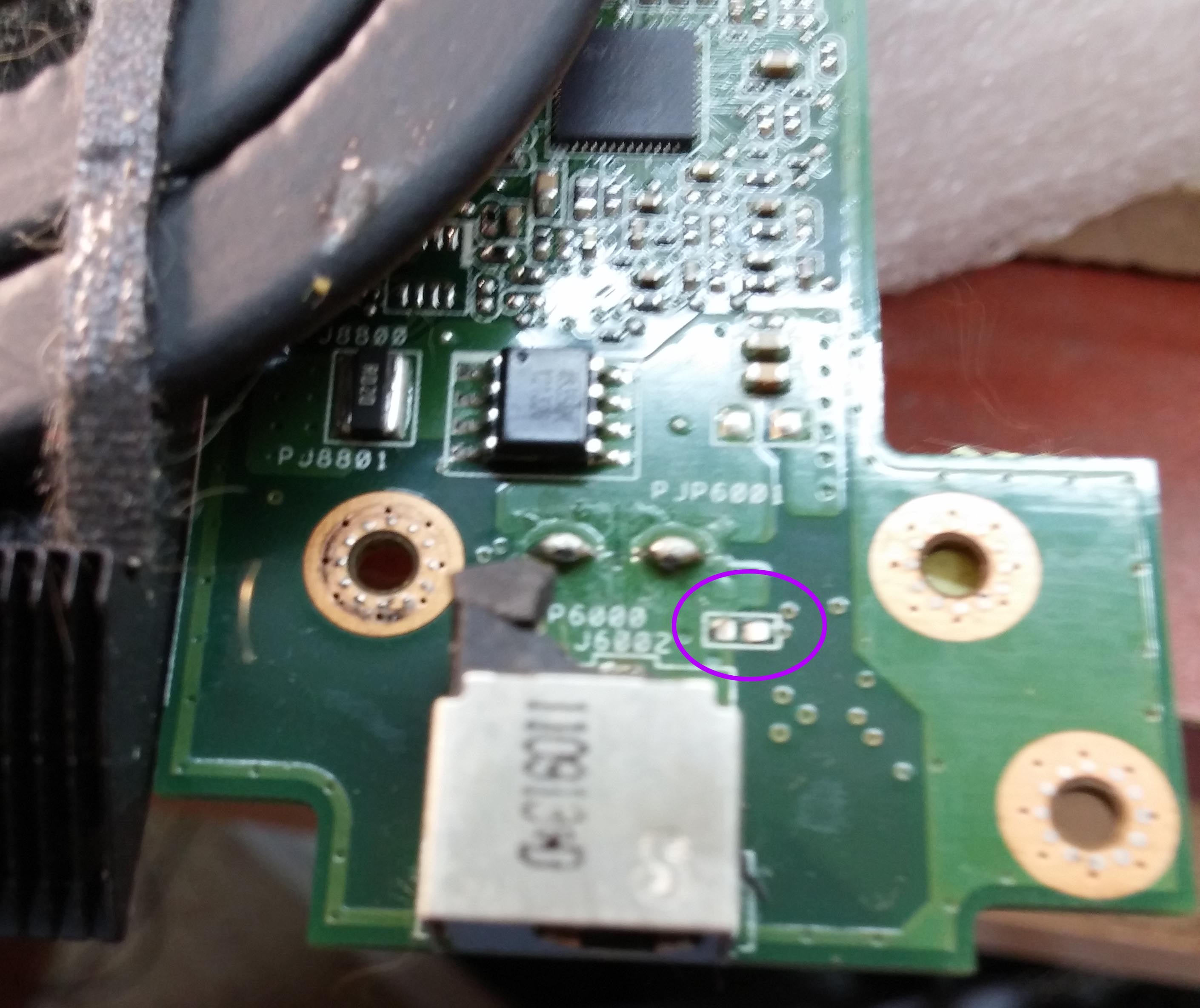

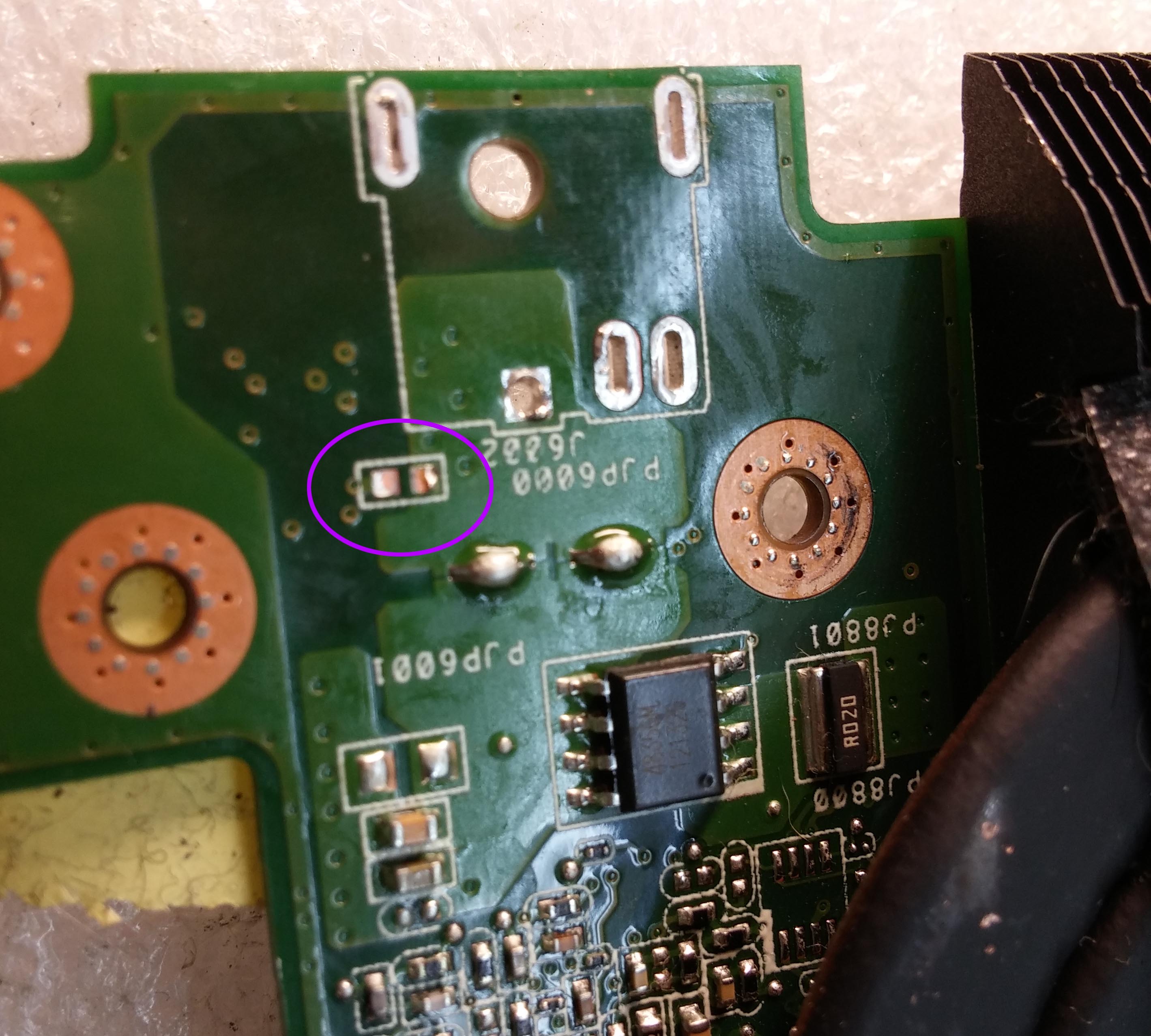

    missing part on asus u31sg-rx061v
    hello i have a broken jack and it broke a part from my board can some one
    tell me what is that part please ?
    the motherboard is u31sg

    Re: missing part on asus u31sg-rx061v
    can i use the motherboard without the missing part ??
      Most likely yes.
        Maybe is a capacitor.

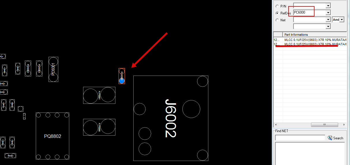

          pc6000 - 0.1uf/25v
            thank you kotnatan will order the part and test .
