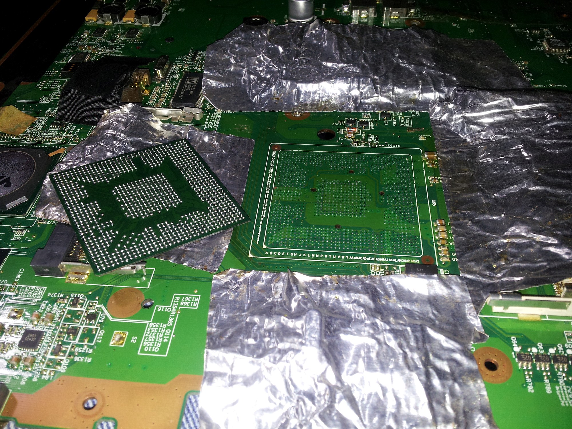

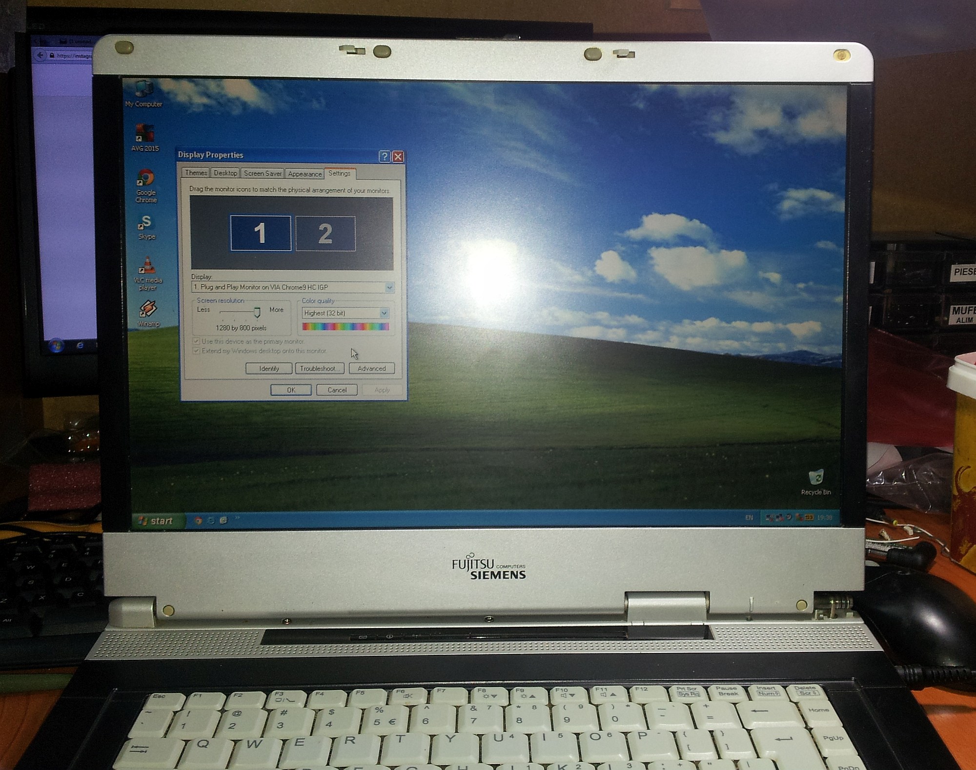

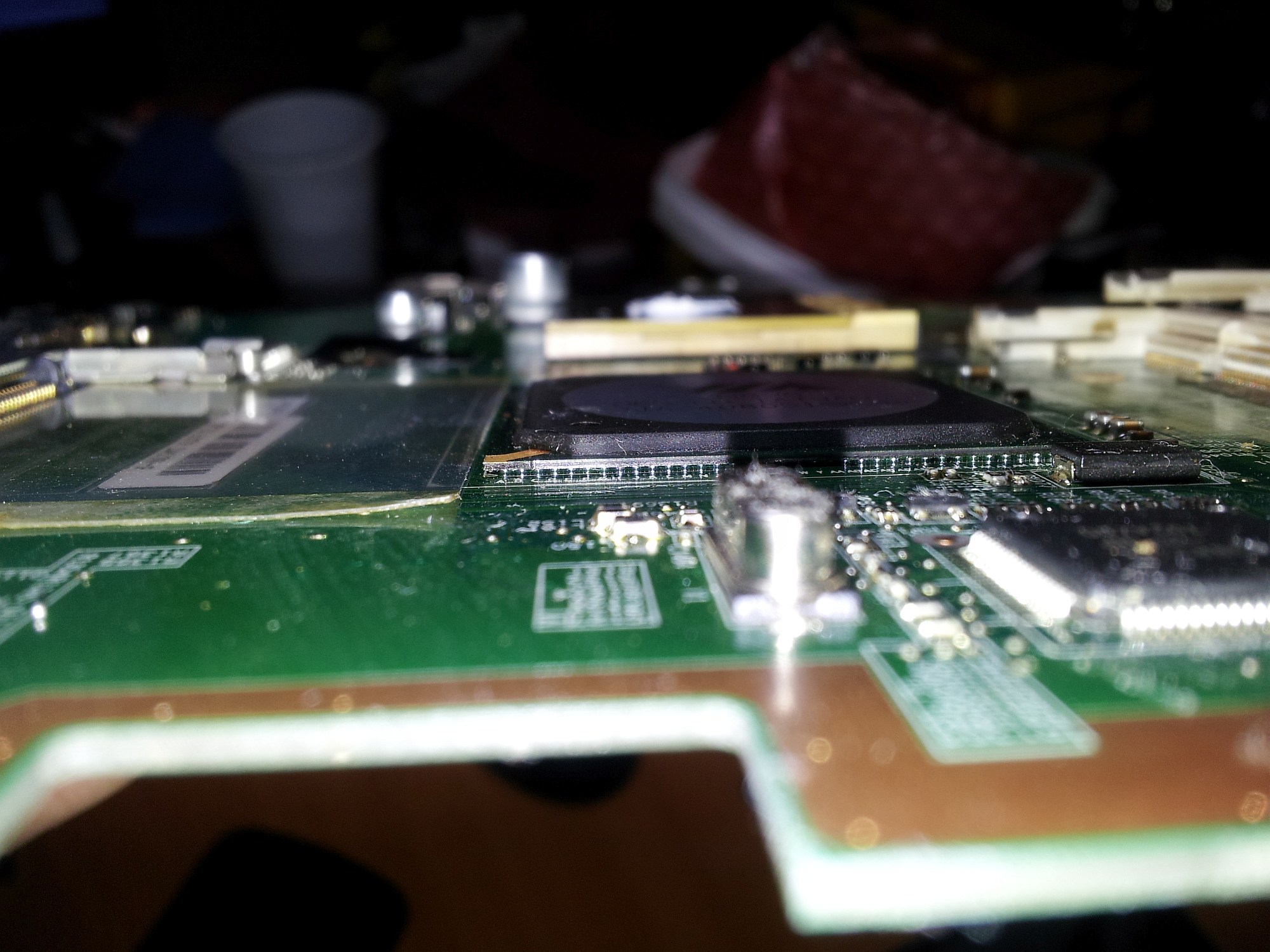

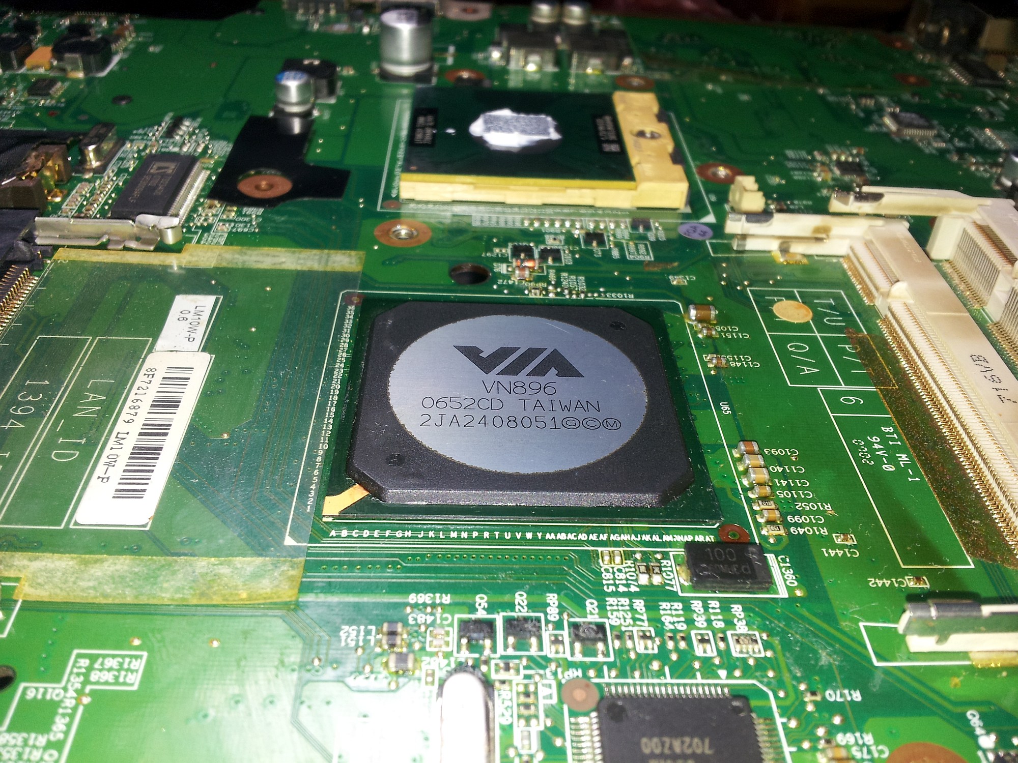

    Reballing Fujitsu Amilo Pro V3515 VIA VN896
    Sometimes, one of those piles of turd comes in where the repair costs more than the laptop is worth, but the owner wants to fix it anyway. So i fix it. This is a fairly troublesome chipset being both very large and very fragile. Fortunately, it all went smoothly and the machine is up and running again.

    Re: Reballing Fujitsu Amilo Pro V3515 VIA VN896
    nice work,
    btw do you use leaded solder balls when reballing?
              Actually this has been done on an IR machine. I still use the hot air wand for attaching the balls to the chip though.
              I have changed workplaces 2 months ago. Much better pay, more space and all the tools i need at my disposal.
              The rework station isn't anything to write home about though, it's a Puhui TX-999. I had to do some mods to the bottom as it took bloody ages to get the board to a reasonable temperature with the bottom heat alone, but other than that it does OK. It's still mostly manual as it does not support profiles, only holding a set temperature once it is reached.
              It's got this weird kind of "lamp" for the top heater that produces no visible light, only heat (IR), it does not use a ceramic plate for the top heater. The top heater is surprisingly mild compared to say an ACHI. No blistered or warped chips so far.
              I'll be adding a camera and light to it soon so i can supervise the process better, without having to stare at the chip from close by when i reattach it to the board.
                    Originally posted by Uranium-235
                    you use stencils?
                    Direct heat stencils, always.
