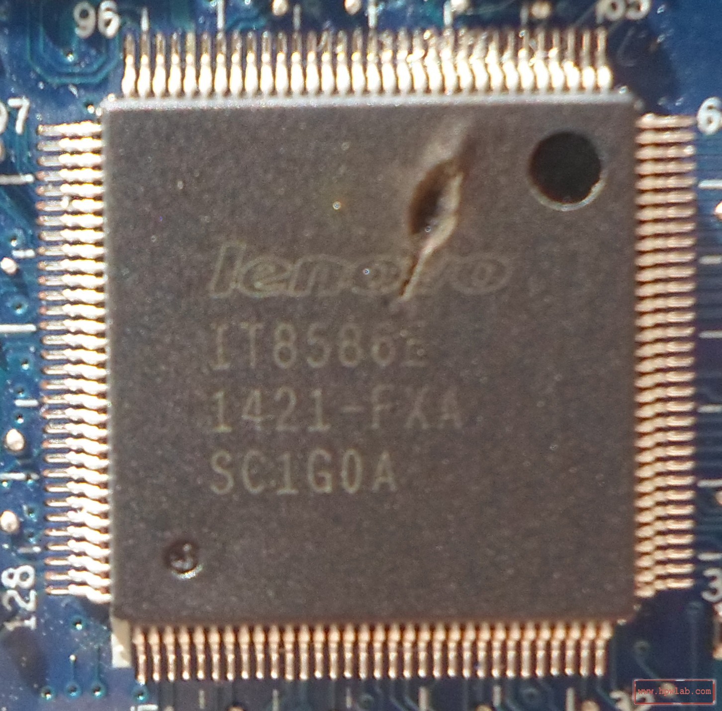

i need a replacement -compatible- IT8586E LENOVO

    LENOVO G50-70

        Re: i need a replacement -compatible- IT8586E LENOVO
        You can follow two ways to change IT8586E. you can plug in the it8586e chip programmatically. or you can program it after plugging in with Svod programmer.
          thanks for the promptly reply..
          I have a RT809F (w/ extension PB board and cable..)
          I can save the old EC and program a new one with
          that .. although I have been just "buying" pre programmed
          chips for the price so far..
          But that is not best solution.
          There are a bunch of vanilla chips (not branded LENOVO)
          and.. my doubt is *IF* I can just put one there and
          re-program the chip hoping for the better...
          Paul
          • mcplslg123
            • Jun 2015
            • 7262
            • india
            As long as the chip number is IT8586E, it works after programming. have replaced many many chips with success.
                  Do you know if FXS and FXA versions of IT8586E are interchangeable? Thanks
                      This is mixed bag. You can try but on some boards FXS/FXA are not compatible. Better to swap with the same suffix.
                      I've used IT8586E without the lenovo logo and it worked perfectly.
