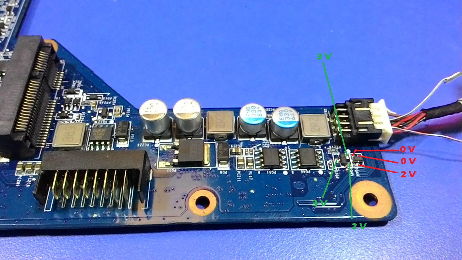

    i Have repair hp g6 no power. if i plug the charger have no light indication. if i press the power on switch. the light indication blink then off, only if the battery inserted.

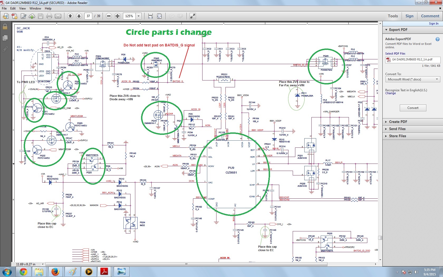

    i try to measured the voltage.
    i have a good unit to trace and i swap this parts i circled green
    can you check

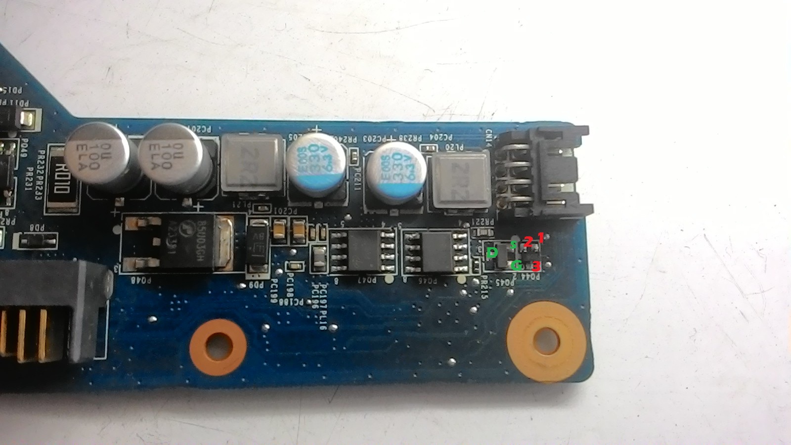

                Re: HP Pavillion G6. no power
                This is a good and working one. i test the voltage of 2 parts
                show up this
                Prove set 10v Voltmeter. tap the black on GND then The red inject to pins 1- 2 -3
                PQ44
                pin1 - 0V
                pin2 - 0V (gnd)
                pin3 - 2V
                PQ45 mosfet
                pin1 (S)- 3V
                pin2 (G)- 2V
                pin3 (D)- 3V
                see below
                here's the prove check board have problem
                PQ44
                pin1 - 0V
                pin2 - 0V (gnd)
                pin3 - 2V
                What happen to this? PIN1(S) and PIN3(D)
                PQ45 mosfet
                pin1 (S)- 0V
                pin2 (G)- 2V
                pin3 (D)- 0V
                how to ix this?

                        Wait. I think you started the wrong way.
                        When you want people to help you write the model of the board and if you have a schematic share it or point to the location of it, Mitu Sharma probably is looking at the wrong schematic and gives you wrong information.
                        Mitu Sharma and Lezsimply, lorins core described in his problem that when he attaches the battery and presses the power button the light indication blinks (that is the laptop tries to start) which in my opinion has to do with a short somewhere and not bios.
                        I will never advise a person to flash the bios before i had checked that everything is ok (I have always voltages and the ec controller functions) and I do not have data signals from the bios ic (although in this situation may be a faulty chipset - very rare) or the laptop starts but it fails to boot (although in this situation may be again a faulty chipset).
                        I got sick of seeing people asking for bios dumps. Flashing the wrong bios or a bad bios file may make the problem more complicated.
                        Check pins 8 and 17 of PU3 and PL21, PL20 for resistance relative to ground without power plugged in and voltage when you plug in the adaptor.

                          you are right atsio
                          i am looking wrong schematic
                          sorry for that .
                          lornis please send me proper model no of motherboard
