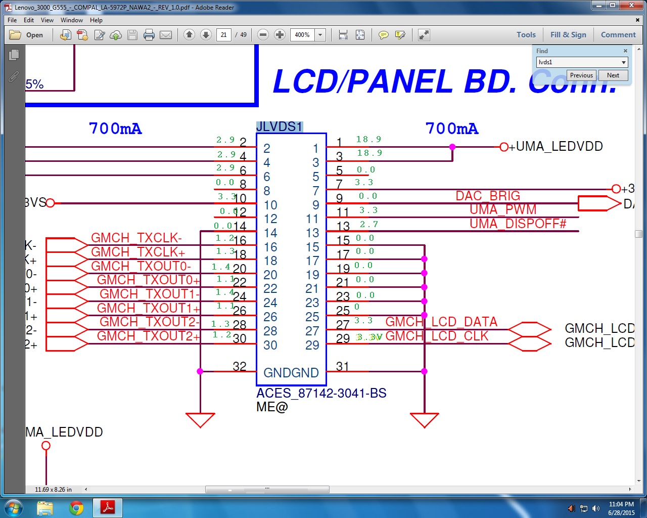

    Hello. Have this lenovo g555 with ATI igp. problem is that it display only on external. i replace aTI IGP with new working one but nothing changed.
    lid sw have power. it is UMA version

            Re: Lenovo G555, only external display working
            here is schematic

              Please post voltages on lvds connector.
                here is measurements of lvds connector
                  You seem to have a problem with KBC. Try to inject 3.3v on the dac_brig pin.
                            rightness is regulated from UMA_PWM. ENBL signal is for VGA
                              I just noticed that you have an 15.6 ccfl screen (although schematic mentions led)
                              From an inverter datasheet:
                              There are two control signals that come form syst
                              em to control lamp brightness. One signal is
                              named DAC_BRIG, which limits curr
                              ent to meet LCD lamp current specification. Another one is
                              named PWM, which adjusts lamp br
                              ightness. This invert
                              er brightness is adjusted by PWM burst
                              mode. The PWM burst mode is that turning on and
                              off the lamp at rate of 150Hz. The effective
                              brightness is a function of the duty cycle.
                              ENBKL signal is raised from Northbridge and goes to KBC
                                but i dont have problem with backlight. i have problem with no lcd daa. i can turn on backlight but still no data or bad data
                                  flashed bios, no change
                                  for me it looks like bad clock signal or something like that. the image is distorted but i see that is something displaying but its lines
                                    You have to remove Northbridge and check lines to lvds connector
                                      Ilast time i have sb off the board i checked these connections and it was al good.
                                      What is lcd clock frequency? Now dont have scope to chrck it.
                                        What is SB has to do with GMCH_TX*** lines?
