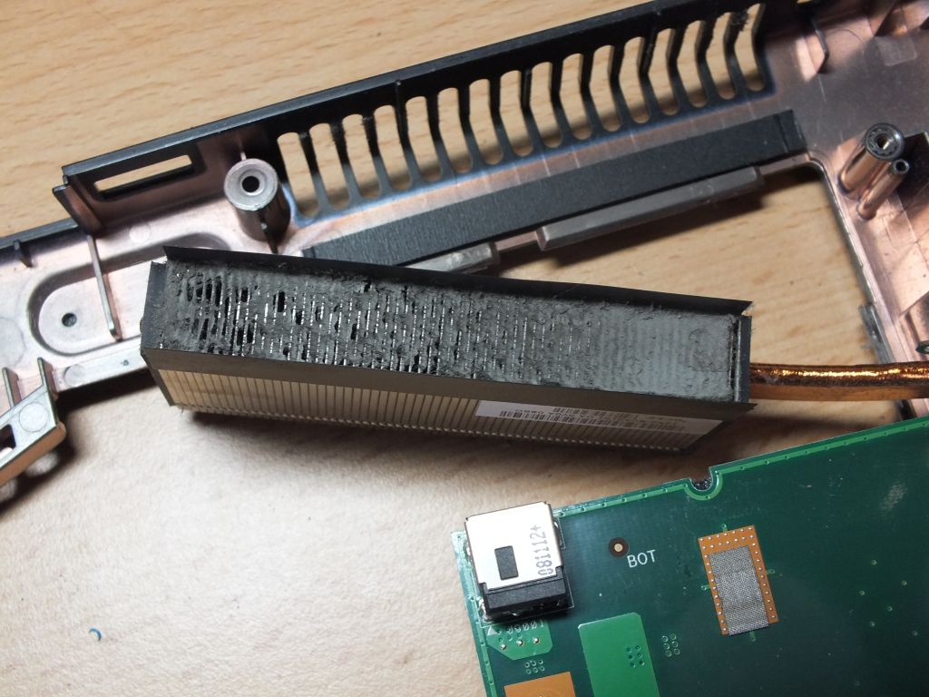

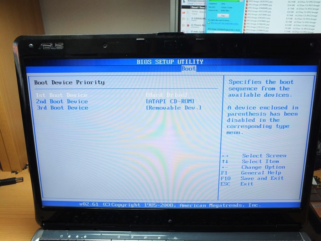

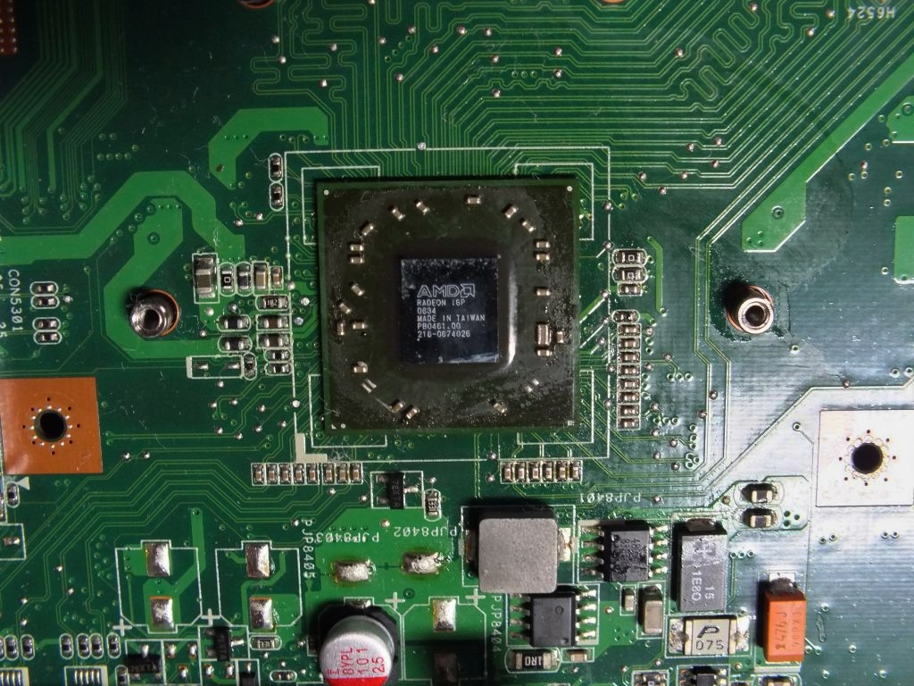

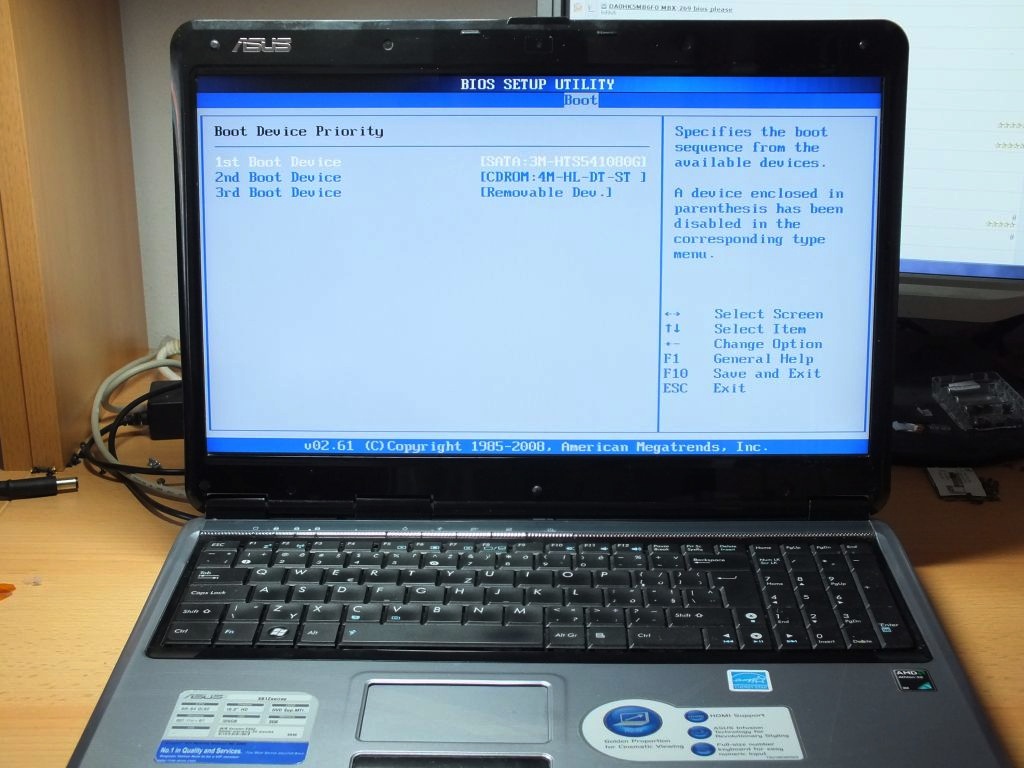

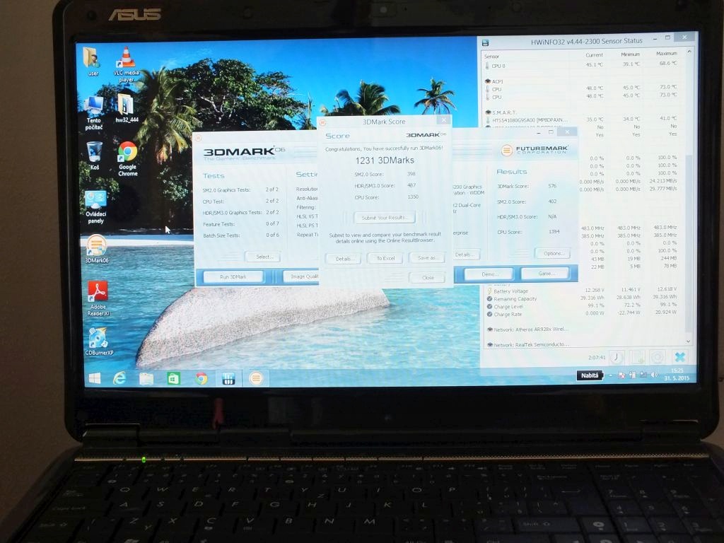

I had interesting problem on Asus X61Z. Based on AMD RS780 and SB700. It boots to BIOS, but no SATA devices were seen so it cannot boot to OS. My first idea was to reball or change SB, but when I saw heatsink I changed my mind and do reball NB. After that both SATA devices were detected in BIOS and OS succesfully boots and passed tests. See pictures.
Asus X61Z no HDD issue
