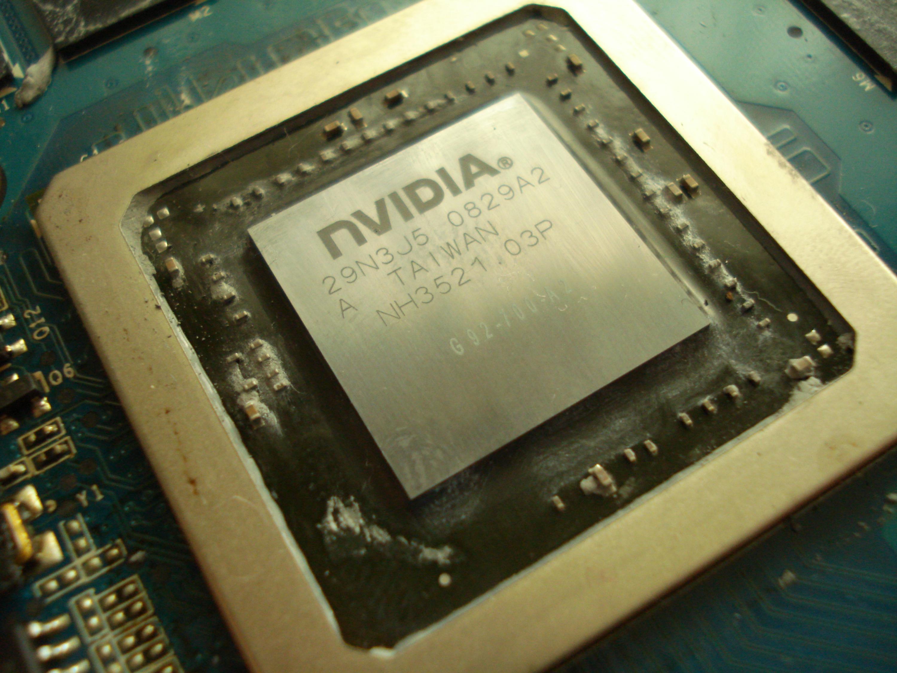

    It was not my fault, i have some blister on G92-700-A2 CHIP, is it possible that the Chip will work??

            Has anyone test it a chip with blister to reball, and put it back on the board??

                How did it get blistered?
                If it was popcorned due to reflow/reball attempt you can safely say its dead

                  Re: Blister on Geforce 8800 GS CHIP ?
                  Picture no Problem!! But i dont know if you can see this on pic...
                  I have buy this shitty Imac for 40 euro and then i have seen this shit
                    No, don't see it but if that is conductive silver paste then clean it off around those tiny SMD parts.
                      Measure across the SMD capacitors on the top of the chip. If any of those read <2 ohms (short) then the chip is dead. This is only valid with dedicated GPUs btw, things like northbridges sometimes have unused sections shorted out on the board, but if you measure the chip after you lift it from the board, it is no longer shorted.
                      I have had several blistered chips that still worked. But most of them do not.

                        @Th3_uN1Qu3
                        The Bigger SMD's shows 3ohms mos of them...??
                          what shit? i dont see anything wrong.
                            I have not seen thermal paste which is conductive electrically. The surroundings looks like the chip has been reflowed, so probably it has died once again...
                              Is a G92-700-A2 changeable (aquivalent) with a G92-150-A2 or G92-720-A2?
                                Both should work. I haven't done many G92 swaps myself but i've done plenty of G86. Even upgrading the G86-703-A2 (8400M G, 8 SP) to G86-731-A2 (8400M GS, 16 SP), or replacing G86-630-A2 with the older G86-620-A2 because that's what i had on hand. All of them worked. Also in the case of the 8400M G -> 8400M GS upgrade, the driver actually picked up the extra shaders and made the laptop faster.
