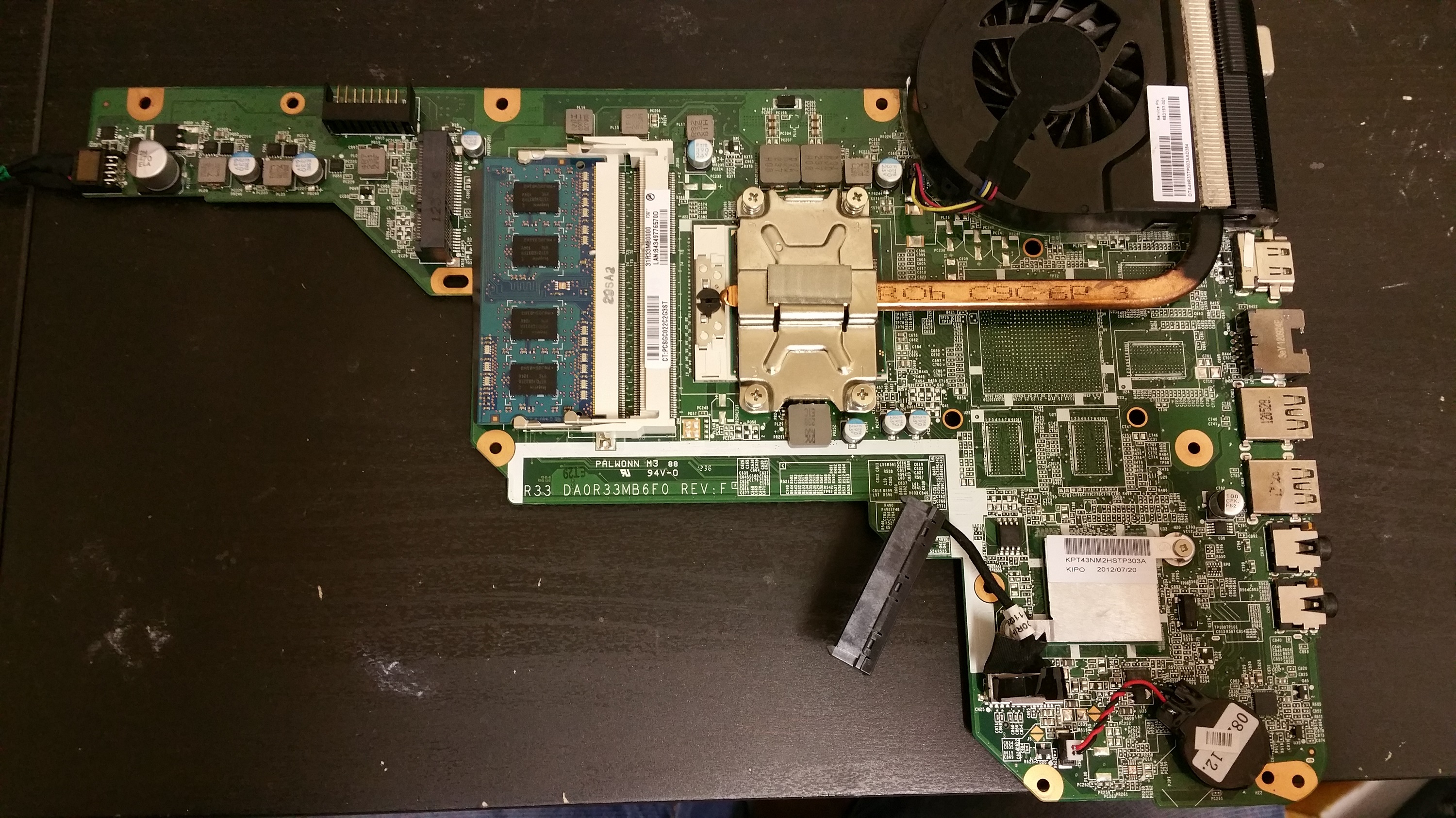

    Hi guys . i have a HP G6-2210SA with no power .
    I don't have schematics if anyone can share them.
    Thank you!

            do you have light on power supply connector on pc ?
            • claudyu07
              Claudyu07
              • May 2014
              • 164
              • Ireland
              Re: HP G6-2210sa No power
              no. no lights at all

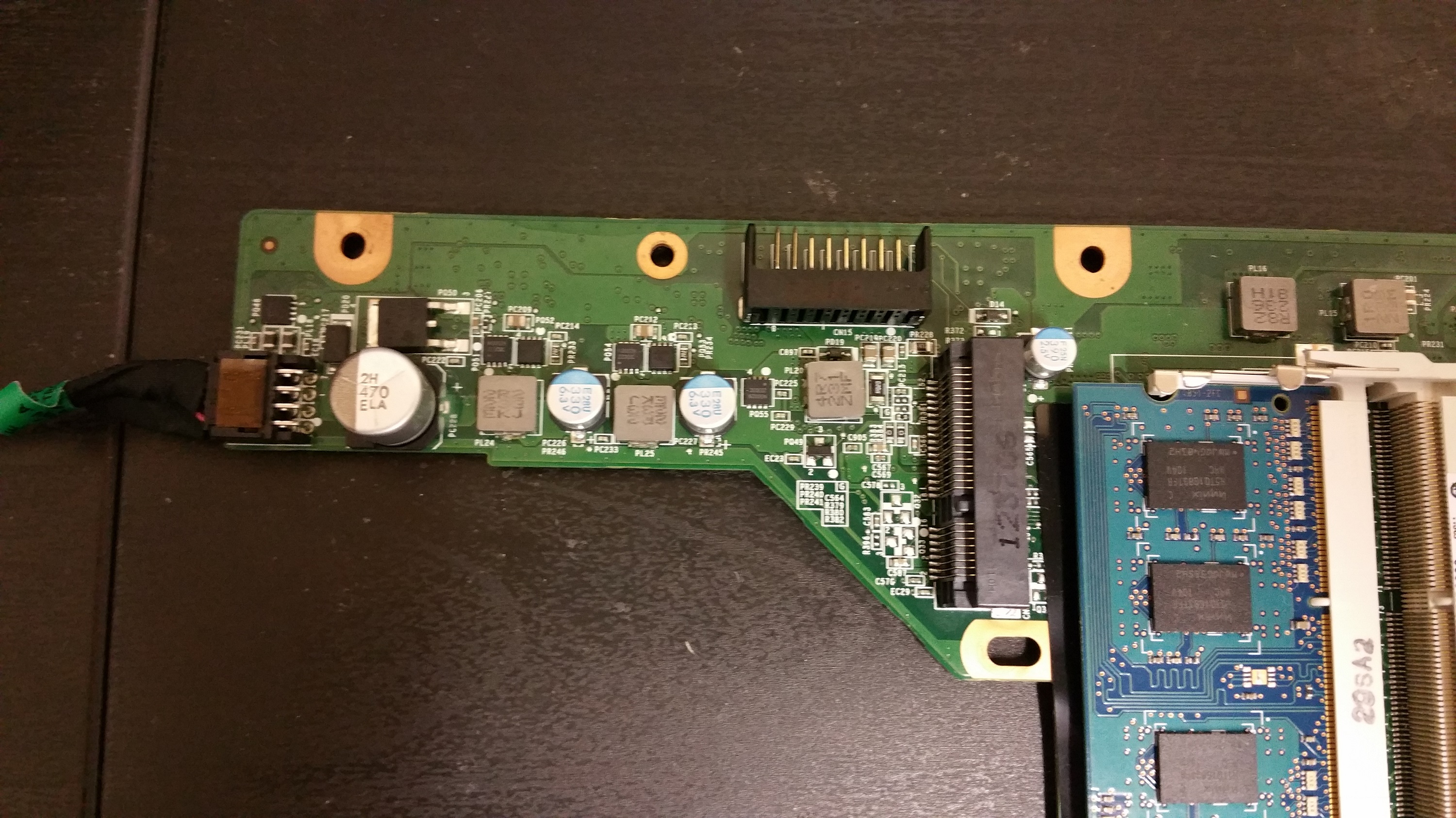

                Have you replaced the dc jack if so did you check the it was wired correct as I have done one and they sent the dc jack wired wrong

                    charger is grand . i have on DC-IN connector (CN16) pins:
                    1 & 2(VDD) - 19v
                    5(AD_ID) - 0.65v
                    7(power led) - 0.04V

                        Originally posted by cyberhack
                        PQ50 voltage?
                        Pin 1- 24V
                        Pin 2,3,4 - 19V

                          3v and 5v : pu8
                          oh does it work on battery
                            no. but i don't know if battery is charged or not .
                            When i plug in the AC adapter and quick press the power button lights come on for fraction and goes off.
                                  PU8 3.3ok , 5v ok , 19v input ok.
                                  @cyberhack is universal charger that i just used now with 3 different laptops and it's working.
                                  @dellxps15 i have an EPZ2010 bios programmer . don't think the bios on this board is compatible with my programmer.
                                  UPDATE.
                                  When pluged in, power button flashes every 5 seconds
                                        did you try to power the board outside the case?
                                        like put the board on the table take the power button out from palm rest , connect the dc cable and power it up on external.
                                        last week did a flash on hp and forgot to put the sticker on top the bios and it did the same power of half a sec the off.
                                        the board was on short because of that sticker missing
