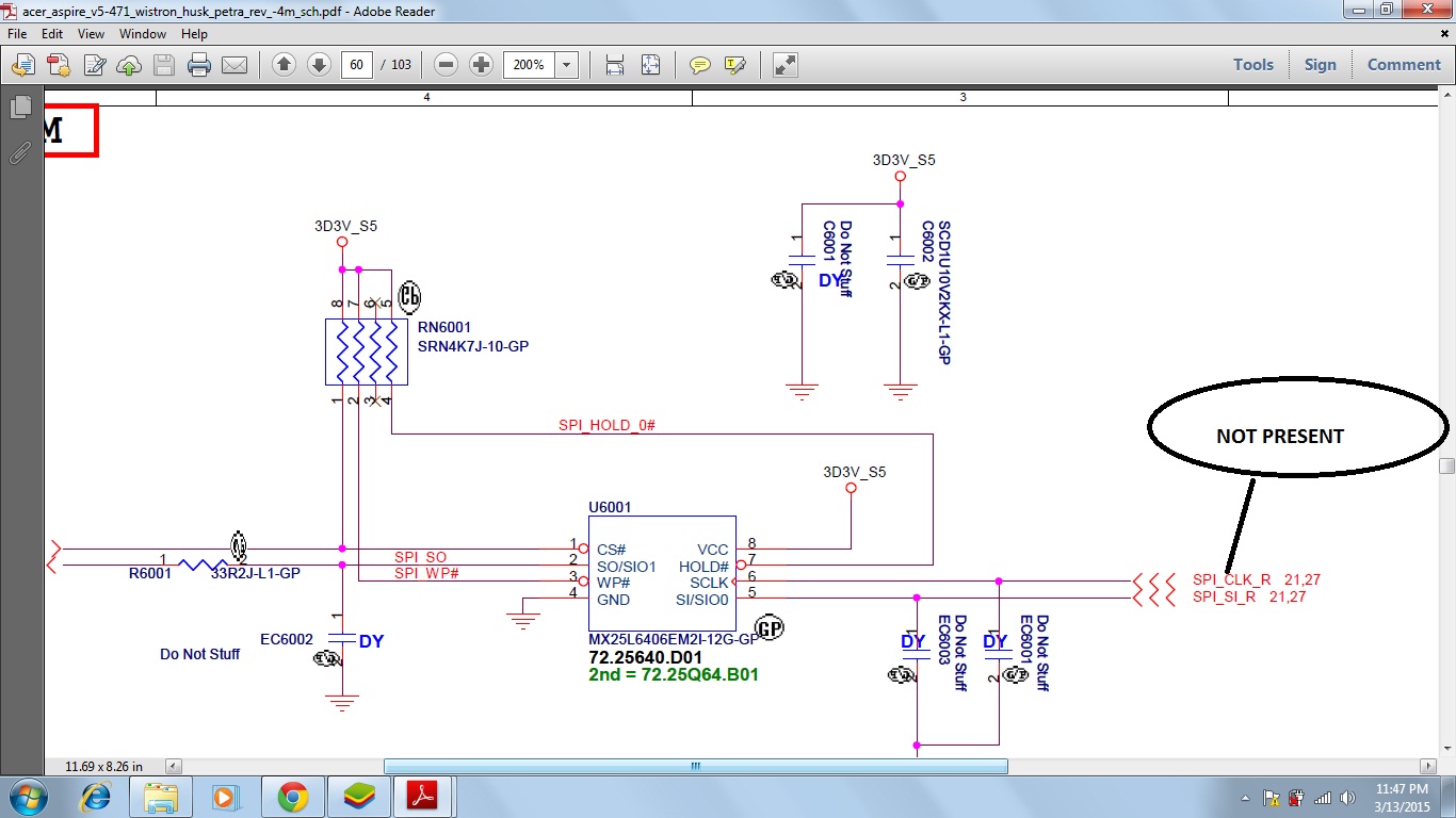

    Sir, what is SPI_CLK? And What is the purpose of this signal?

      Re: What is SPI_CLK?
      http://en.wikipedia.org/wiki/Serial_..._Interface_Bus
      Without clock signal there will be no data transfer between master and slave.
      (EC can't read bios from SPI flash).

        on my laptop motherboard.. acer aspire v5.. the bios ic pin no. 6 show that it has SPI_CLK.. but it is not present.. the problem of the motherboard is no power.. what is the cause?
          What bios, EC or main? If main, maybe it will not need to be powered before power button pressed. If EC bios, then need to find why 3V ALW not present on EC.
          SPI_CLK will be present only when data is moving, if EC will be read once, then after reading there does not have to be signal on SPI_CLK before power is cycled again.

            here is the photo sir
              From shematic seems only one BIOS, EC might be already preprogrammed.
              Does the bios have vcc? If not then no need for SPI_CLK also.
              Does the EC (U2701) have 3.3v on pin 19?
                SPI is a 3 wire communication protocol, similar to i2c. There's a clock wire and a couple of data wires (one for input, one for output)
                Basically, each time signal goes high/low (change in the state) on the clk wire, the chip makes something available on the data wire or reads what's present on the wire (one bit).
                These chips can work at up to 75-100 Mhz (if you have a cheap scope you may not even detect signal on that clk pin) so it's possible the bios chip is read into memory in a second or so at boot and from that point you won't notice any signals on those pins.
                Here's a datasheet for some random flash spi based chip (16 mbps, very common) :
                  EC (U2701) 3.3v on pin 19 is present sir..
