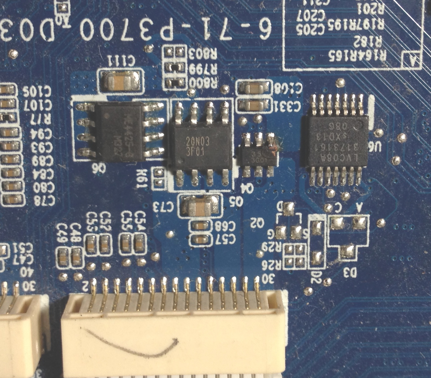

    I have a customer who tried to install an LCD (LED backlight) screen in his Sager laptop. He thinks the cable connector was in a little crooked and tried to adjust the cable with the laptop powered on! He smelled smoke! He quickly turned it off! But now there is no backlight on either his old or new LED screen (the original screen was cracked with a working backlight).
    I disassembled the laptop down to the motherboard and found this burned chip. Part of the chip is missing so I can't get a part number from it.
    Can anyone tell me what this chip is? It's near the LCD/LED connector cable on the motherboard - so it must be related. What are the chances that this chip will solve the backlight problem, or is there most likely more damage I cant see?
    Thank for any help on this in advance!
    John

      When asking such a question to identify a burnt chip then your best chances getting a good answer is that you provide the PCB platform model and revision. The name and model of your laptop is sometimes crucial too. The chipset model.
      The chip you are referring to is the Q4, try to get schematics for your motherboard and then its solved. I would definitely start by changing that chip at first.

          Thanks for the replies. Sorry for the missing information - I'll provide that now. I was hoping that since some of the part number is showing (35__ 3G01), someone might be familiar with backlight circuits and fill in the missing remainder of the number.
          I have looked for schematics or even a clear picture of the motherboard so I can see the complete number on the chip - so far nothing. But if anyone could help, it would be appreciated.
          The Laptop is a Sager P370SM (appears to be manufactured by Clevo). The motherboard part number is 6-77-P370SM3A-N13
          Again, I know this is a long shot, but I felt I would ask here because I've had great help in the past. This is an expensive motherboard and I certainly would like to make an attempt for my customer.
          Thanks again....

            Please Check it this schematic.

              Wow, that is amazing. Not sure how you found this schematic, but I can't thank you enough!
              Now I just need to find a MTS3572G6. Mouser and Digikey don't have it. Any ideas where to find this chip? According to the spec sheet, it's a N- AND P-CHANNEL ENHANCEMENT MODE POWER MOSFET.

                      Its quite rare not because of the voltage ratings of the N and P side, any other NP enhancement fet would work fine if the voltage rating is around +/- 30 for both sides. The problem for you is the pin configuration cause the pins 1-2-3 are G1-S1-D2 for your chip, whereas the vast majority of these NP fets have other pin configuration, as of the pins 1-2-3 are G1-S2-G2.
                      So as for you try at first to find the chip with pin-pin configuration then as for the voltages 30 on N side and -30 of P would work perfect.

                        By the way, have you ever thought using separate N and P mosfets ( compatible voltages, amps ). I would definitely try that using SOT 23, or may be better sot-89 package if that dual NP is hard to find. Need some tricks soldering but surely doable.

                              Your original chip is a TSOP-6. The SOT89 would be great with proper voltages/ amps. Just make sure that you don't solder with switched pins. The S(source), D(drain) and G (gate) should be soldered to respective place according to original chip. The N mosfet and P-mosfet accordingly too. try to download the datasheet of the part and from part drawing you find out the pin configuration and which of sides is N or P. Its actually easy done but need some hand skill in soldering.
                              On the other hand if you find an item with pin-pin compatibility and around 30 v on both side with acceptable Amperage in range then I would go for that option first.
