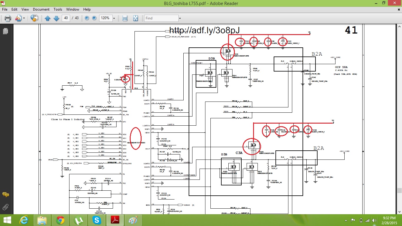

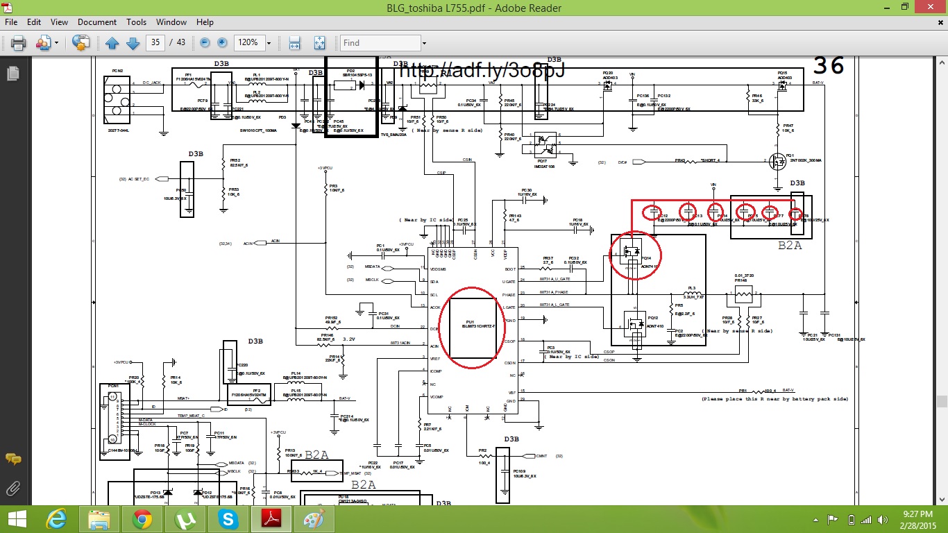

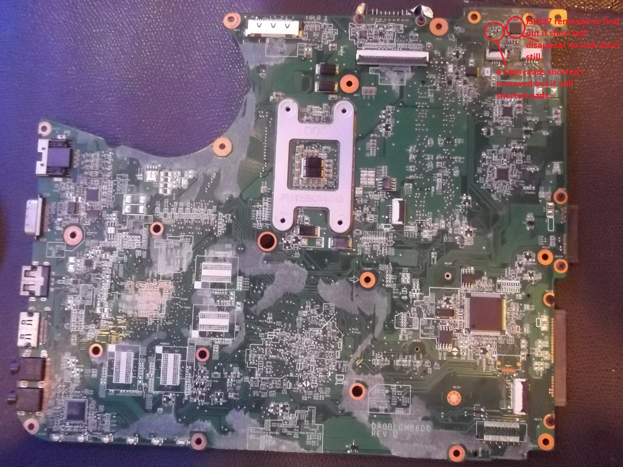

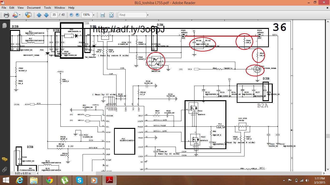

    hello everyone i need your help.
    i got this L755 i3 laptop with no power. can't find right schematic diagram (DA0BLGMB6D0).
    I found shorted fets nikos P1203ED replace with new one but it still get shorted too.
    pls. see attached picture of some test i made.

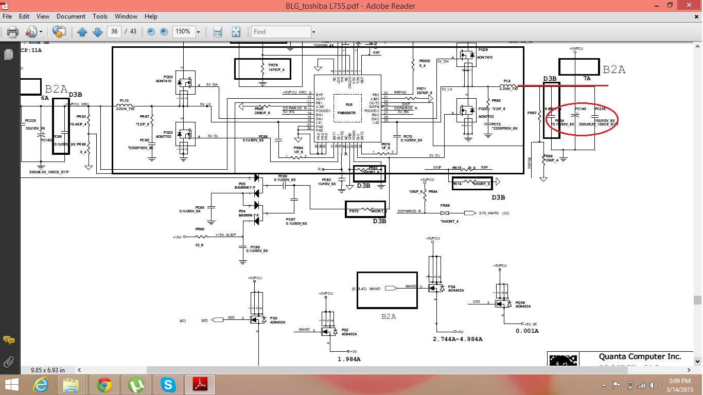

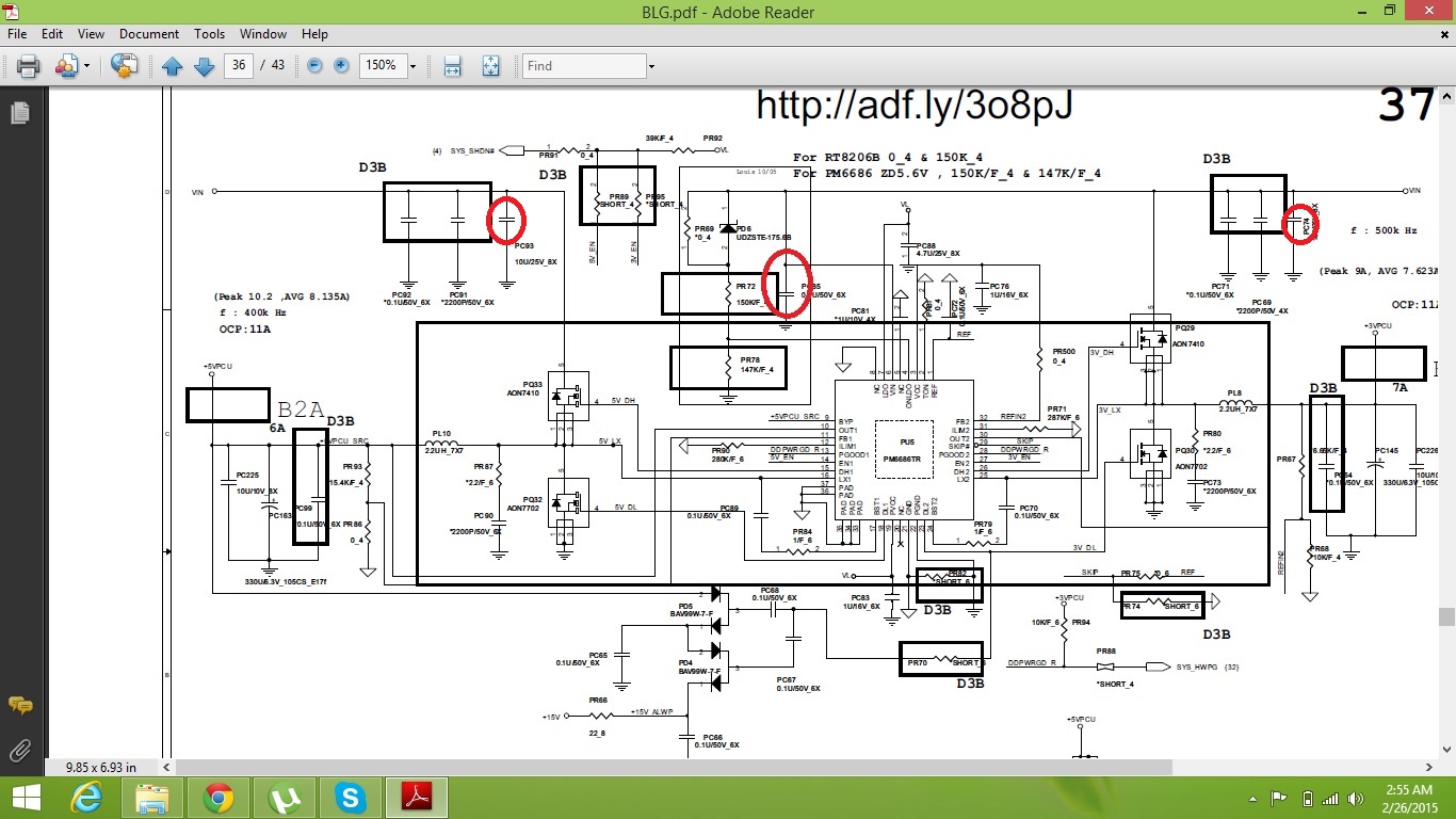

        hello guys i found shorted line that suppose to be not.
        on page 36. system 5v/3v PU5 pin 6VIN is shorted
        i already remove PU5 it still shorted
        i also remove some caps PC85, PC74 on the same line still got shorted. dont no were to find more.
        need help tnx...

          Re: Toshiba L755-13N no power.
          so 19v all short-circuit path. try searching in the scheme of the word "vin". from page 37 onwards. so many caps in the vin lines.
          I saw in the scheme have been marked with a line box D3B

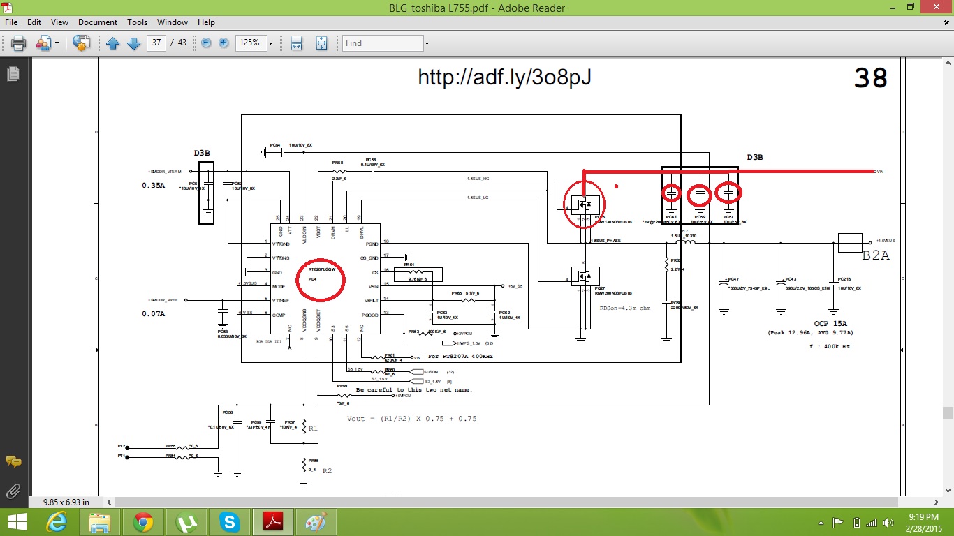

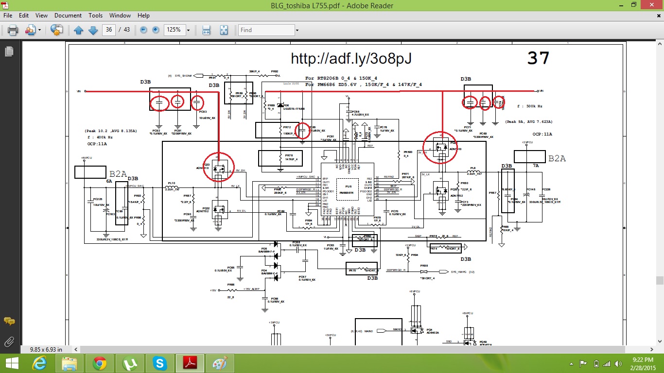

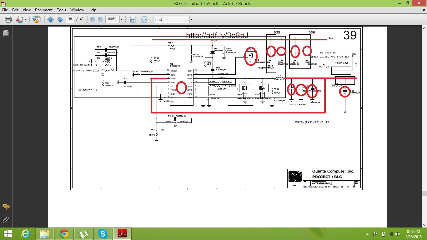

            i still cant find the fault component. here i attached file on page 36,37,38,39 and 41. i mark red line that are shorted and even though i removed all caps in the line including ics U3, PU4 PU1,PU8,PU5 and mosfets that mark O.
            any idea. gu
              +vtt rails short?
              did you try isolate by remove PL4, so we focus on vin rails?
              maybe pq13,pq18, pq23 are short too
                Originally posted by meritosari
                +vtt rails short?

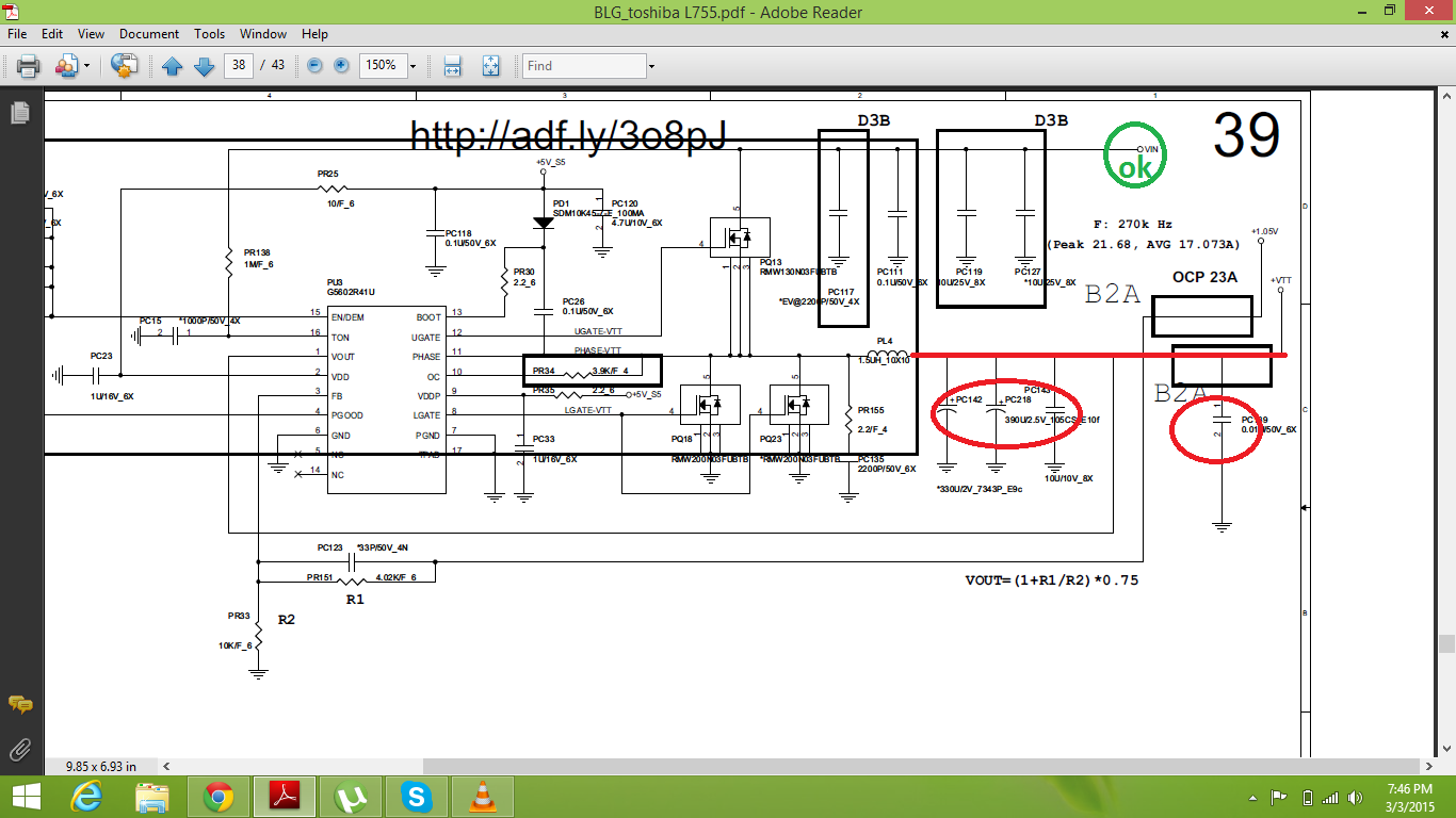

                +vtt is short
                yeah.i removed that also but the short is still on +vtt line
                PQ13, PQ18 PQ23 is not shorted.
                  I still can not understand, if from page 36 to page 41 + vin has a short-circuit, should pq20 on pins 4 and pq15 on pin 3 is also a short-circuit
                  quickly find a short-circuit path usually use a PSU that has a current and voltage limits
                  to isolate pu8 of rail + vin try to lift pr42, because small parts I used to simply shift course and avoid the loss of these components. I often use two pieces of solder to slide

                    its really confusing why it still shorted even i removed everything in this line...
                    from PQ15, PQ20,Pc136, pc132, pr46, pr47, pq1....

                            vtt is for cpu so remove processor and coil
                            • rickybucalan
                              • May 2013
                              • 322
                              • philippines
                              cpu romoved and PL4 including Pc142, pc21, pc143 and pc 139 and its still shorted to ground.
                              it could might be +1.05v line?

                                How many ohm you call is short, if like 0.010 ohm I think its ok for +1.05V rails
                                Try search on this forum about +1.05 rail

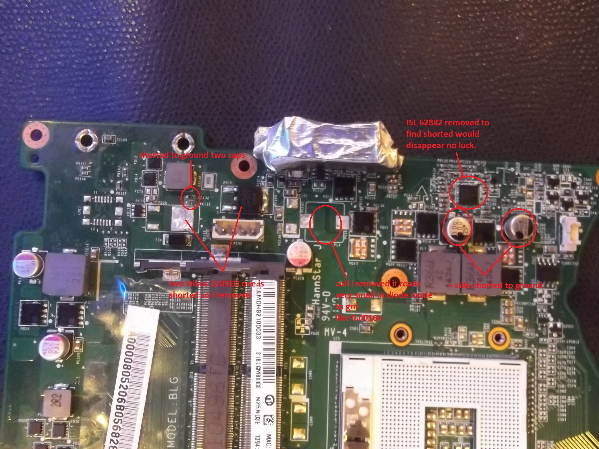

                                  im using digital multimeter. checking Caps
                                  when testing in diode mode from ground to pin it reads 0.009v and 0.000v other side.
                                  when testing in continuity mode from ground to pin its beeps both end
                                  in ohms mode it reads from ground to pin 022.5 ohm and 000.0 ohm
                                  which one is the best way to find short?

                                    again after i found shorted caps on VIN line and tested it. it short again this time in PL8 get shorted. lifted up short goes to +3vpcu
                                    removed Caps pc145 and pc226 still shorted.
