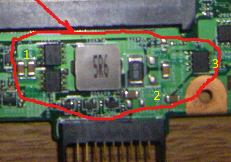

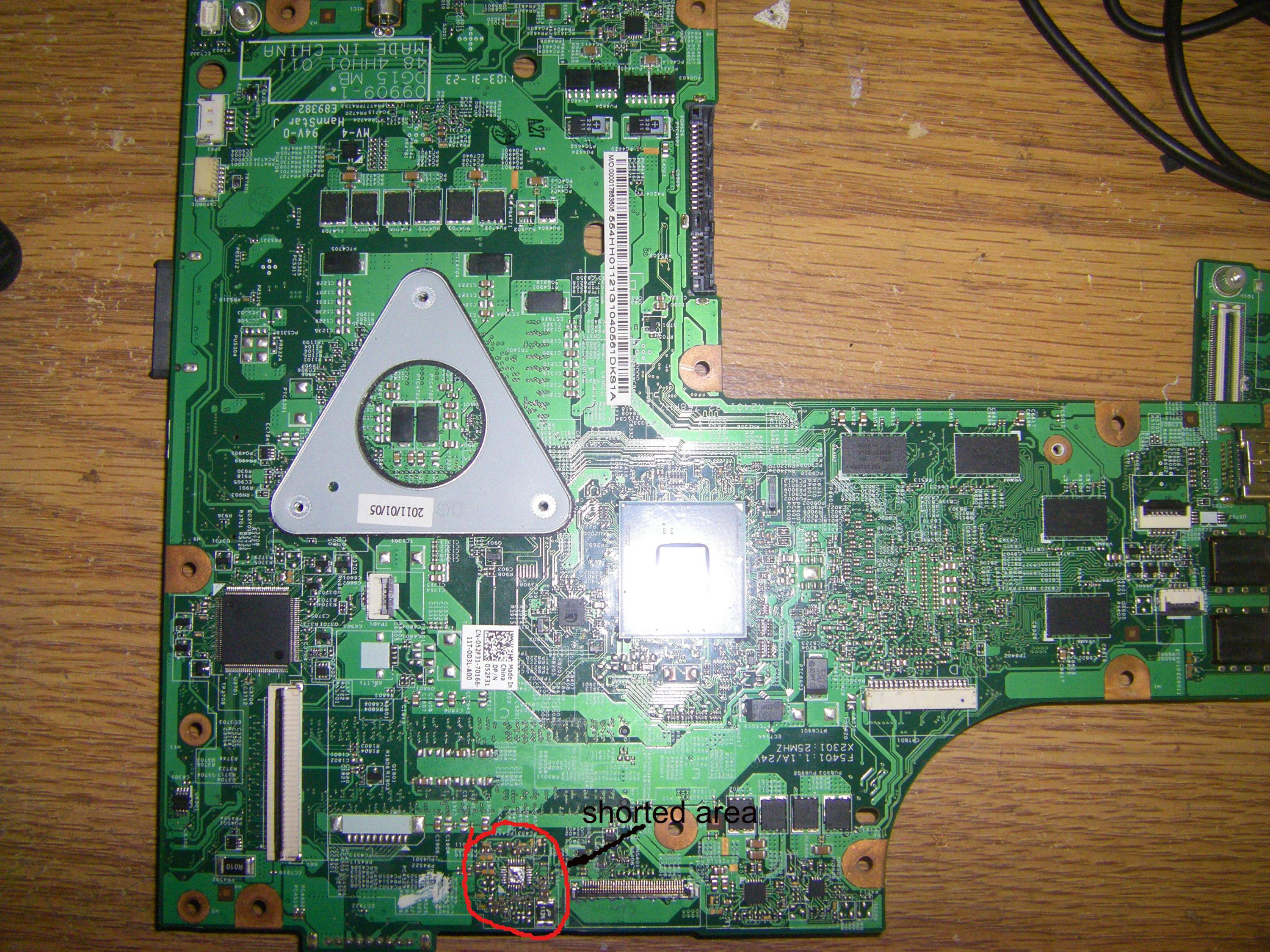

    Hello, I have a Dell N5010 that has a shorted area on both sides of the board in the same (reciprocal) area. The section in the schematic belongs to the battery charger management. All the components in the two areas are shorted. I am not sure what is the best way to proceed. I was going to remove components one by one to see if the short disappears. I have already removed the buck controller (PU4501) as you can see in the picture but the short remains. I thought the next suspects would be the mosfets (PU4504/5/3) and my plan was to remove them one by one and test for the short at each removal. Is this what you guys would do? Any suggestions would be appreciated. I don't have an oscilloscope and wouldn't know how to use one anyway. I was going to bin the board and buy a new one but the costs are too much.

    Short can be between 2 points, it is meaningless to say that area has short. Show points. Do not apply power without buck controller on board, it may damage the board...

      Re: DELL N5010 shorted area
      But every component within the area is shorted to ground. They all get scorching hot.
        So you got 0 ohms to gnd from all 3 points?
        • sparker1
          • Sep 2011
          • 343
          Well, nearly 0.
          At Point 1 =2 Caps (both read the same) = 0.3 ohms and 7.6 ohms at other end
          At Point 2 =Cap = 0.3 and 2.9 ohms
          At Point 3 =Mosfet:
          pins1, 2 and 3 =7.6 ohms
          pin 4=134.9 ohms
          pins 5,6,7,8 =2.8 ohms
          My DMM is set at the 200 ohm scale and shows 0.4 ohms when the probes are touched together.
          Continuity meter gives a beep for everything in the area to ground. I was thinking there is a component within the circle(s) that is causing the entire circuit to show as shorted. My first guess was the buck converter but its removal didn't help. Appreciate your interest Khaahk. A palindrome!
            Start removing the mosfets, starting with 4505, then 4504 and see how resistances change. I reapeat my suggestion: do not apply adapter power without buck controller, the situation may become worse. (if it hasn't already).
                OK. I removed both mosfets and the short seems to have gone. Here are the measurements with the mosfets removed:
                Point1 (2 caps) = 0.3 and infinity
                Point 2 (cap) = 0.3 and infinity
                Point 4 (mosfet) = pin4 is 0.207Mohm all other pins infinity.
                I'll replace those two mosfets and the buck converter and see what happens.
