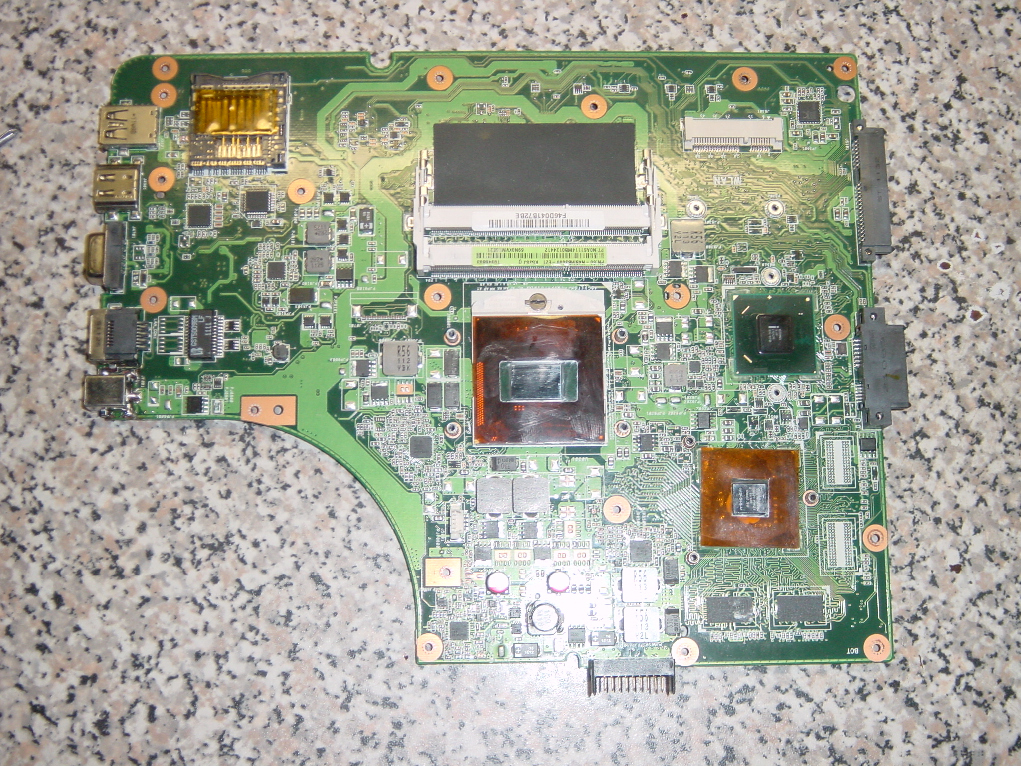

    Hi Guys,
    I have an Asus A53SJ who stopped working, no video on screen and hdmi.
    When I plug in the power, some led's light up, including the power switch led.
    The powerswitch is overruled and does nothing, can't switch off the system.
    For the rest everything is dead. After a while the fan comes on when the cpu gets good warm. Tried another CPU, no change.
    Tried to recover the bios, but that does not work. This laptop does not have a automatic device selection sequence. Normally, if you want to boot from the usb, you have to select that in the bios and it only works once. Since I can't get in, this recovery can't be done.
    I can't find any schematics, only the board view. Mobo is K53SV V2.3.
    Can someone pls tell me how to approach this problem?

                  do you got pictures of the board?

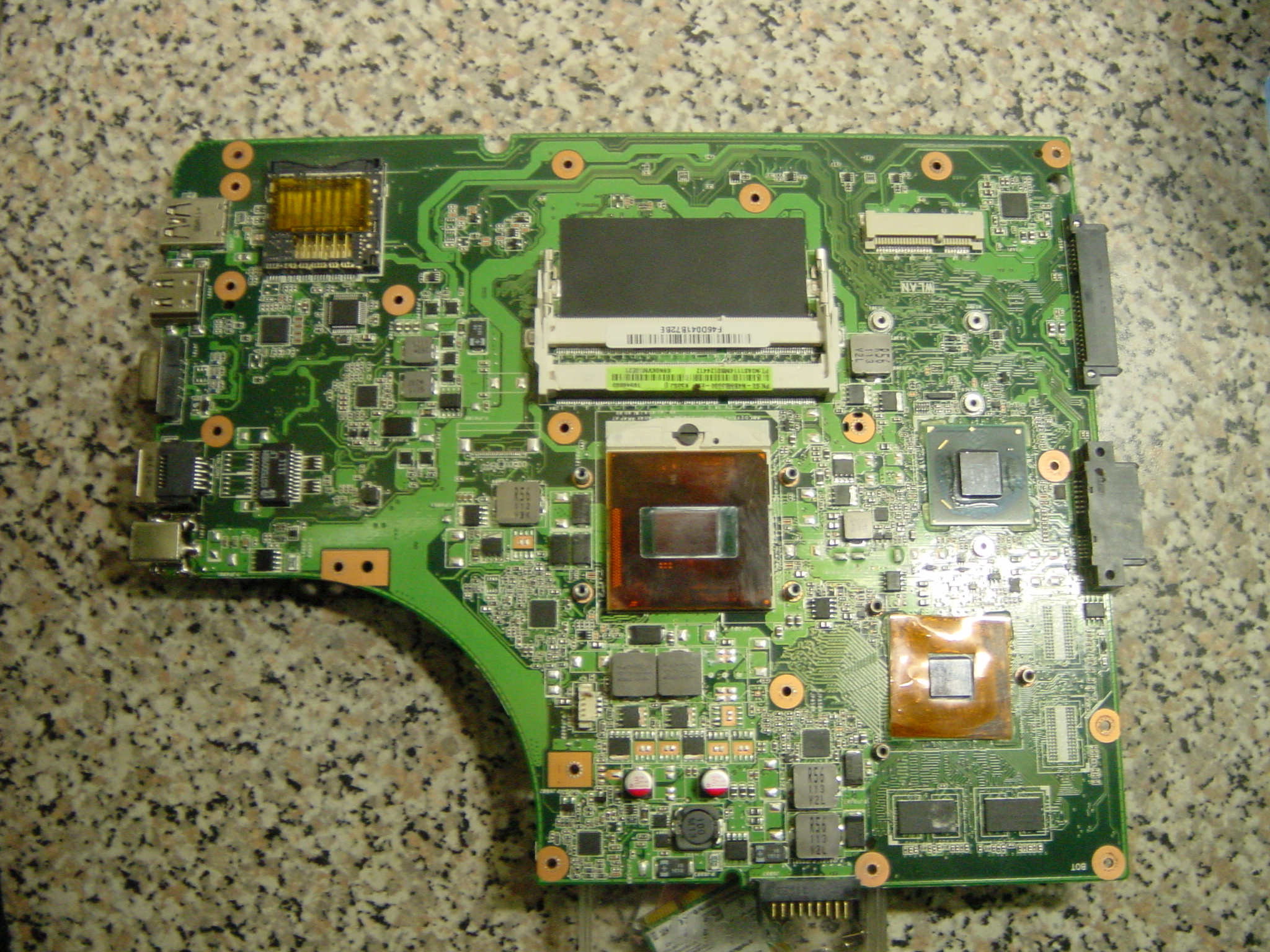

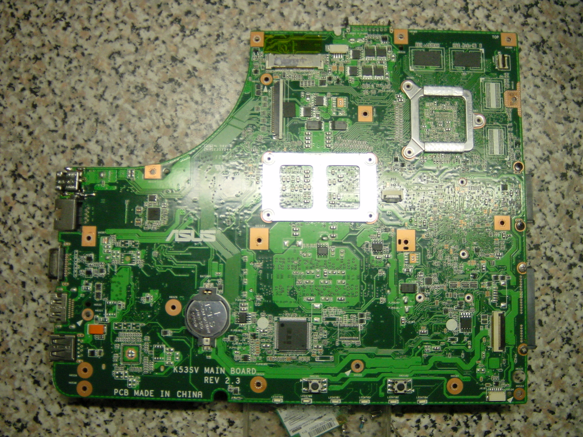

                    • hansie55
                      • Dec 2013
                      • 254
                      • Netherlands
                      Re: Asus A53SJ-SK230V stuck..
                      hansie
                      Herewith, quality is not all that, I hope good enough.
                        do you got any signal on hdmi ?
                        connect the fan adapter memory and power button and see if you got signal.
                        if yes go for a reflow even if not go for a reflow.
                        cook the the whole board! :>
                              no signal on hdmi, also not with your items connected.
                              Thinking about the reflow
