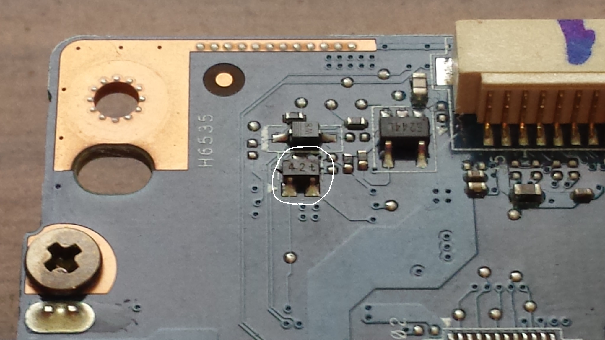

    Diode code
    Blew a diode while measuring voltage on an lcd connector and the only marking on the diode is 42t. Can anybody point me in the right direction on how to get more info on this thing? Where to get one? Or 2? Lol Thanks

      Re: Diode code
      dont have schematic?

        Re: Diode code
        These Satellite L775 boards are an ass-whip, AMD or Intel, can't find a schematic for either of them. And very little on the board is labeled. This board is an Intel.

          Re: Diode code
          Here is the datasheet
          Here is the link for 42t markings smd
          http://www.s-manuals.com/smd/42

            Re: Diode code
            Awesome, thanks
