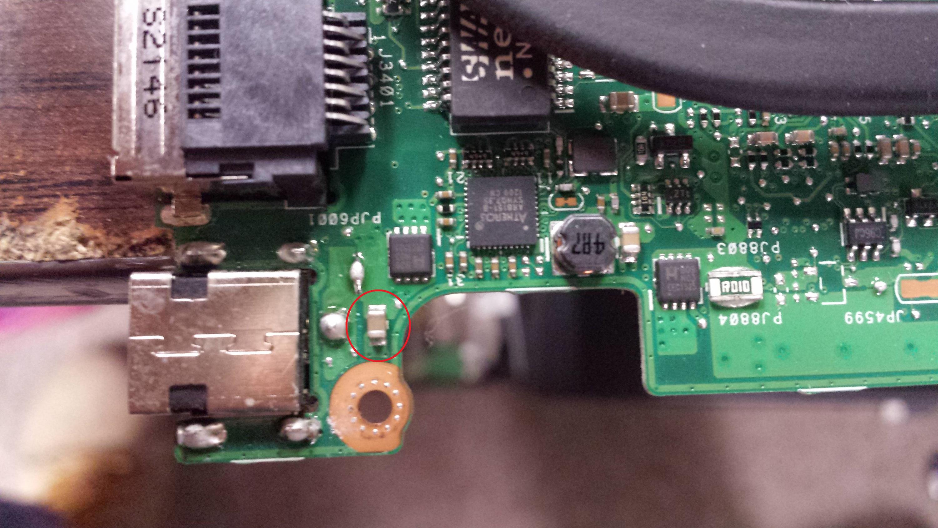

    Got a laptop in with an odd power issue. When the power supply is plugged in the green indicator light on the power supply goes out. Tried a new power supply which does the same thing. Removed the motherboard to check for power jack or component damage and found nothing, but when I plugged the power in I found little wisps of smoke coming from one of the components. Tested the resistance on the component which read 1.1 Ohms one way and .7 Ohms reversed. Any ideas?

    it just capacitor on main rail. u can remove it and it should work.
    or u can replace it with same size by any capacitance. its capacity is not important

      Looks like a shorted capacitor - old dell 505s used to have a similar problem removing it seemed to get them working. If you cant find the value try something a similar physical size
      and capable of standing the voltage on the pads

        When I remove it do I connect the two pads with solder or leave them disconnected?

          Leave it disconnected. or replace with another capacitor.

            It is not critical. It's best to replace it with a capacitor of the same size taken from a similar location on a scrap board, but it will work without that capacitor installed. Shorted ceramic capacitors are way more common than you would think, especially if the laptop has been used in an area with high humidity.
            DO NOT bridge the connections with solder - you've got a direct short across the power adapter, you're trying to remove the short, not make it worse.

              Wanted to report that the laptop is in good working order now, thank you very much everyone for you help.
