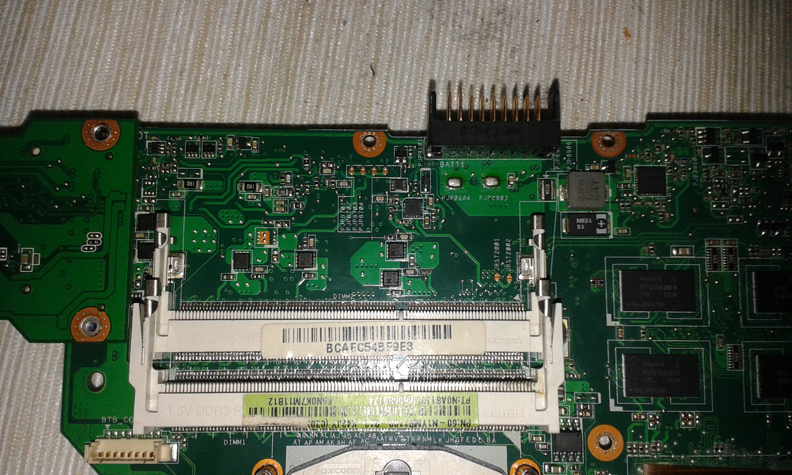

    hi all
    i have asus a42j core i5, problem no power, no led, nothing, someone can help me?

    Re: asus a42j no power
    Do not connect the adapter and laptop battery.
    check if there is a short circuit on the 19v lines.
          now can live with using batt, but using the adapter can not be, anyone can help, where should I check
            check first two mosfets right after power connector for voltage on its legs. go for traces. if is dot on trace look on other side

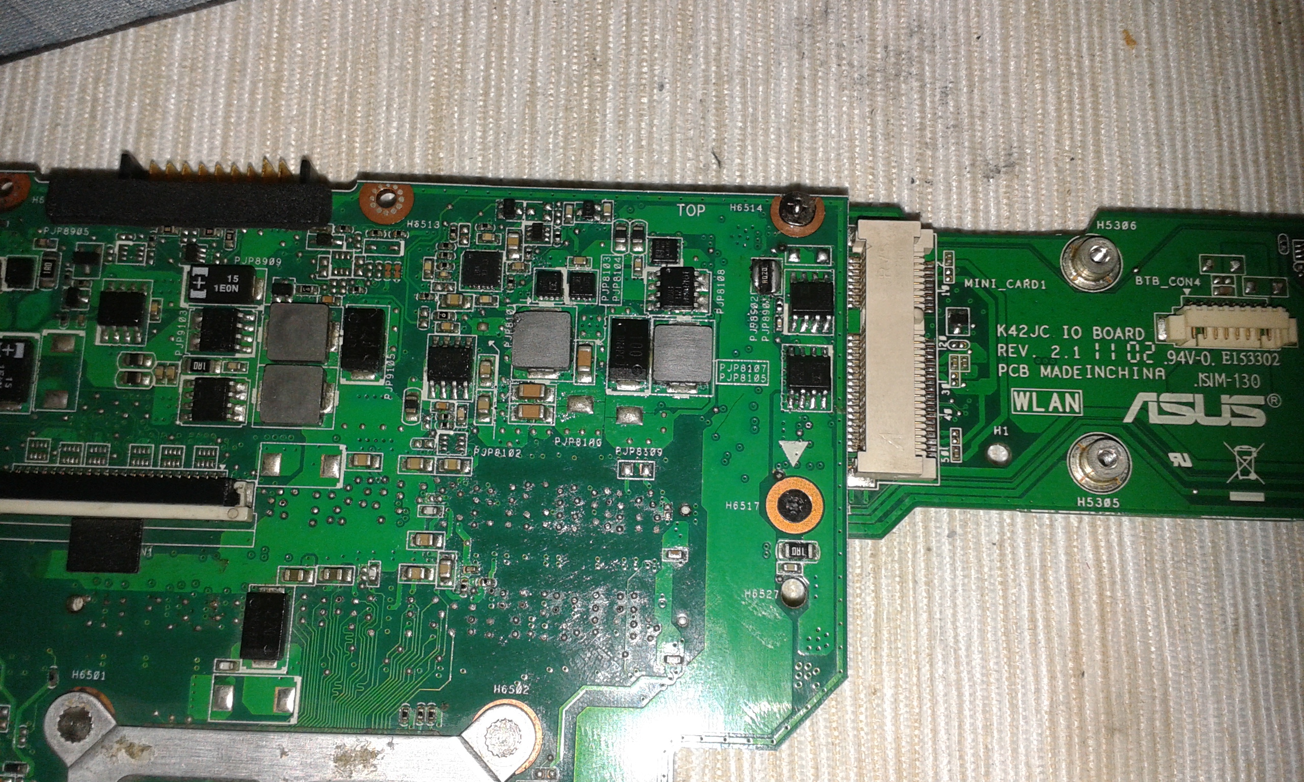

              check the three components that have been marked, the p-channel MOSFET
                PJP8101 looks damaged top left corner
                  Thank U all for help me
