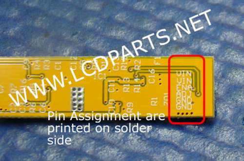

    Well didnt notice battery was still on chassy , and removed the bloody lvds connector , now it turn on , i can see very barely in the deep of the screen the images , but cheked yesterday LCD VCC was 5.8 volts , today i lifted pq20 and pq18 , to test them , and reinserted them and i got now different values.
    page 22 of schematic cheked the LCD switch circuit , cheked that PQ21 i got the 3.3 volts from VPCU on pin 3 . and also got the 3.3 volts on the gates of pq20 and pq19 .
    once i press on , the LVDS_DIGON will send a 3.3 volts signal do the gate of Q21 making the +3vpcu to drop to 0 volts , once that happen i got 13.76 volts on pin 3 of Q20 and PQ 18 i got pin 1 3.3 volts , pin 2 13.7 volts and pin 3 - 3.3 volts .
    so since i dont have here the LCD to test it out . my question is LCD VCC should be 19 volts as usual right ?
    Also noticing that RM1 hall sensor and backlight switch on the same page 22 , i got 3.3 on pin 1 and 2 . with or without machine turned on
    any toughts ?
    thk in advance

    Re: l755 imag very dim after big stupidity
    post schematic, because i dont have it.
    start from inverter by pinout from image.
    vcc - 19V
    ena - 3.3V
    adj - 0-3.3/3.3 is full light/
        pin 22 and 23 of lvds connector i got 19.6 vlts
        pin 20 i got 0 volts with or withuot turning it on ,
        pin 19 i got 3.3 volts.
          Pin 1,2 =3.3v ?
          • highpulse
            i hate HP
            • May 2013
            • 1489
            • portugal
            yes
              well guess that not having pin 20 at least 3.3 than screen will not turn on , only thing is concerning me is lcd vcc beeing 3.3 volts !
              cheked pin 6 of nuvoton and its 0 . will try inject 3 volts on that rail and see what will move forward
                  check all components on page 22, block LDS
                    Sio problems , replaced and all good
                        eheheheh , well its a open eye even that we do all this steps tausands of times , somethimes when to much pressure , we allow us to make mistaque but we shouldn't , but well , i simply lost to much time due to a stupidity .. thinking that lcdvcc should be 19 volts .... since beggining not having pin 20 i knew KBC was faulty .. my only problem was pin 1 and 2 of lvds ... and i wasw wrong since the main feedline was at pin 22 and 23 well , it was a good error to remind me few basics steps
