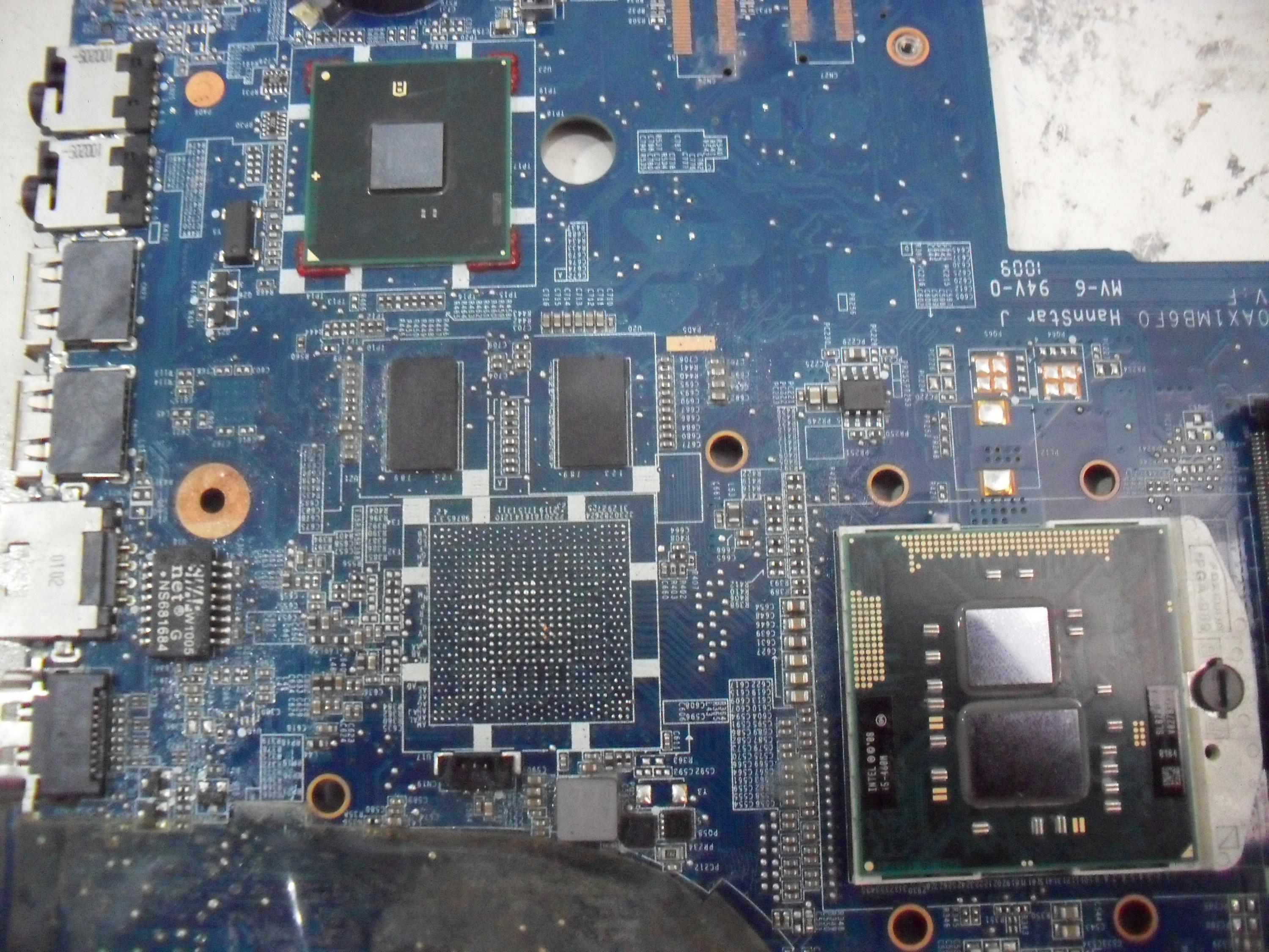

    hi all, I want to ask, is there ever tried to remove ati display in CQ42, if it can be if not longer wear ati graphics, using only onboard, without ati display

    Not possible. See the blank spots next to the CPU? That should have been the power supply for the video processor integrated into the CPU. It's missing. So it's never going to run without the ATi chip.

      I have a motherboard again without ati chip, exactly the same motherboard, so I asked, maybe there are've done it before ...
