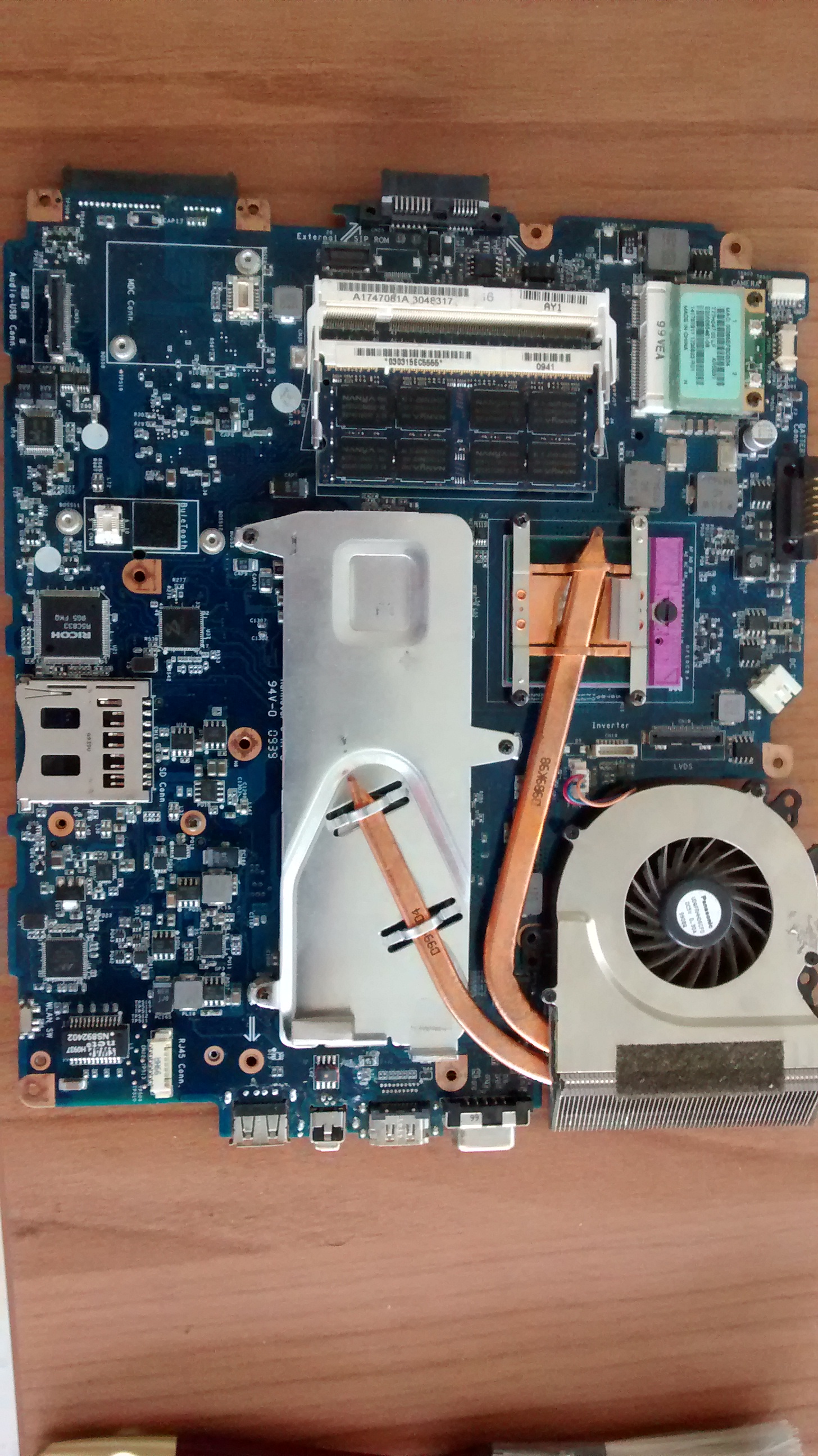

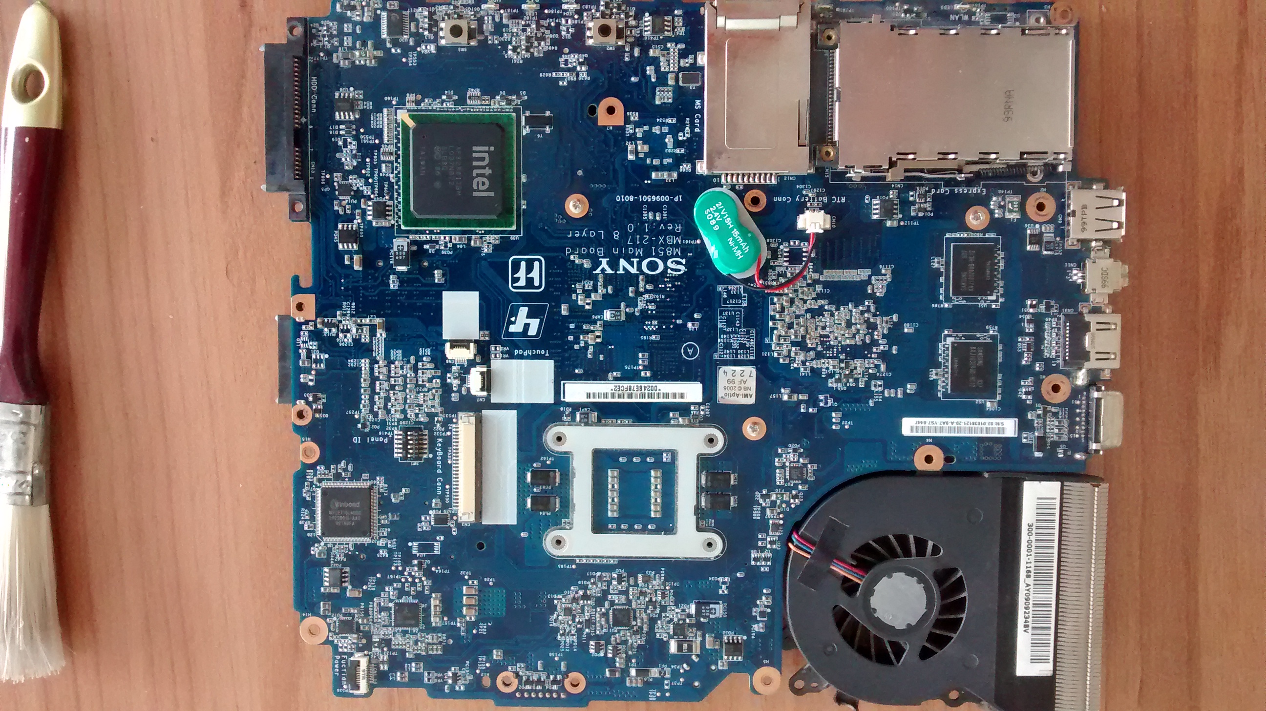

    I have a sony 7182M which doesnt power on. I checked of course ac adaptor and jack.
    I measured mosfet pq24 & pq25 which are ok also on pu1 I have on vref 3.3V
    Can someone tell me how to continue checking because I don't know how to move on and if someone can give me general directions on such cases (I have basic-medium skills on reading schematics) what to check first(voltages, fuses, vref etc). Is there an online guide or a book to start with?
    I am attaching schematics and both side board
    Thanks in advance.

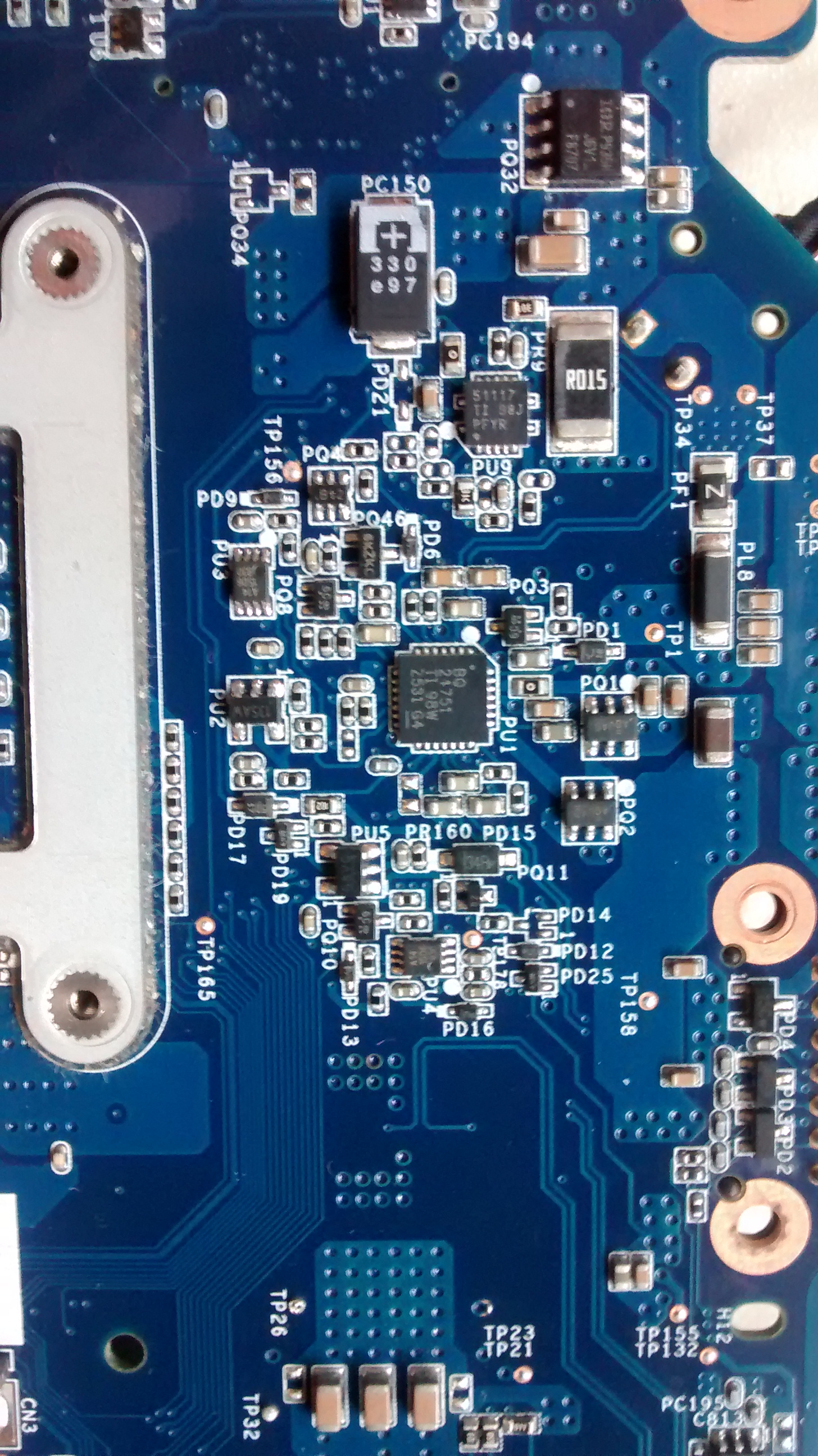

                              Re: Sony 7182M no power at all
                              I am attaching a picture of the board. Can you please tell me which one could be PC25 because I can't find it and I think it maybe not writen on the board and could you indicate me which one is PR9 becuase I measure the big one but now that I saw it more careffuly maybe this isn't PR9
                              • p1muserfan
                                • Apr 2014
                                • 184
                                Don't see PC25, not everything is labeled, it should be in PQ25 PR9 area. PR9 is just below PQ32 with the marking RO15 on it. But if you have no voltage on the one side of PQ25 you won't have anything on PR9 either. PC25 is gonna be small, like PC194 which is right above PQ32
