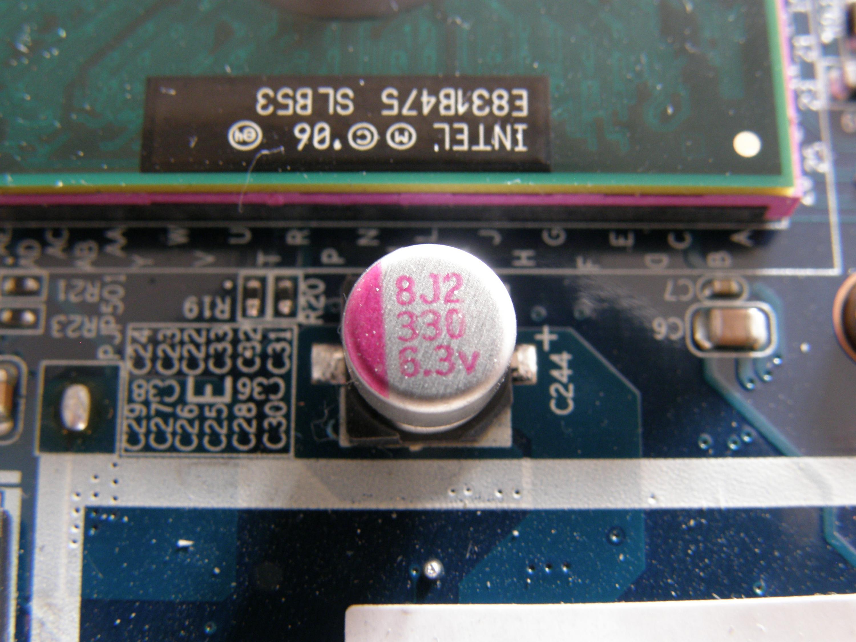

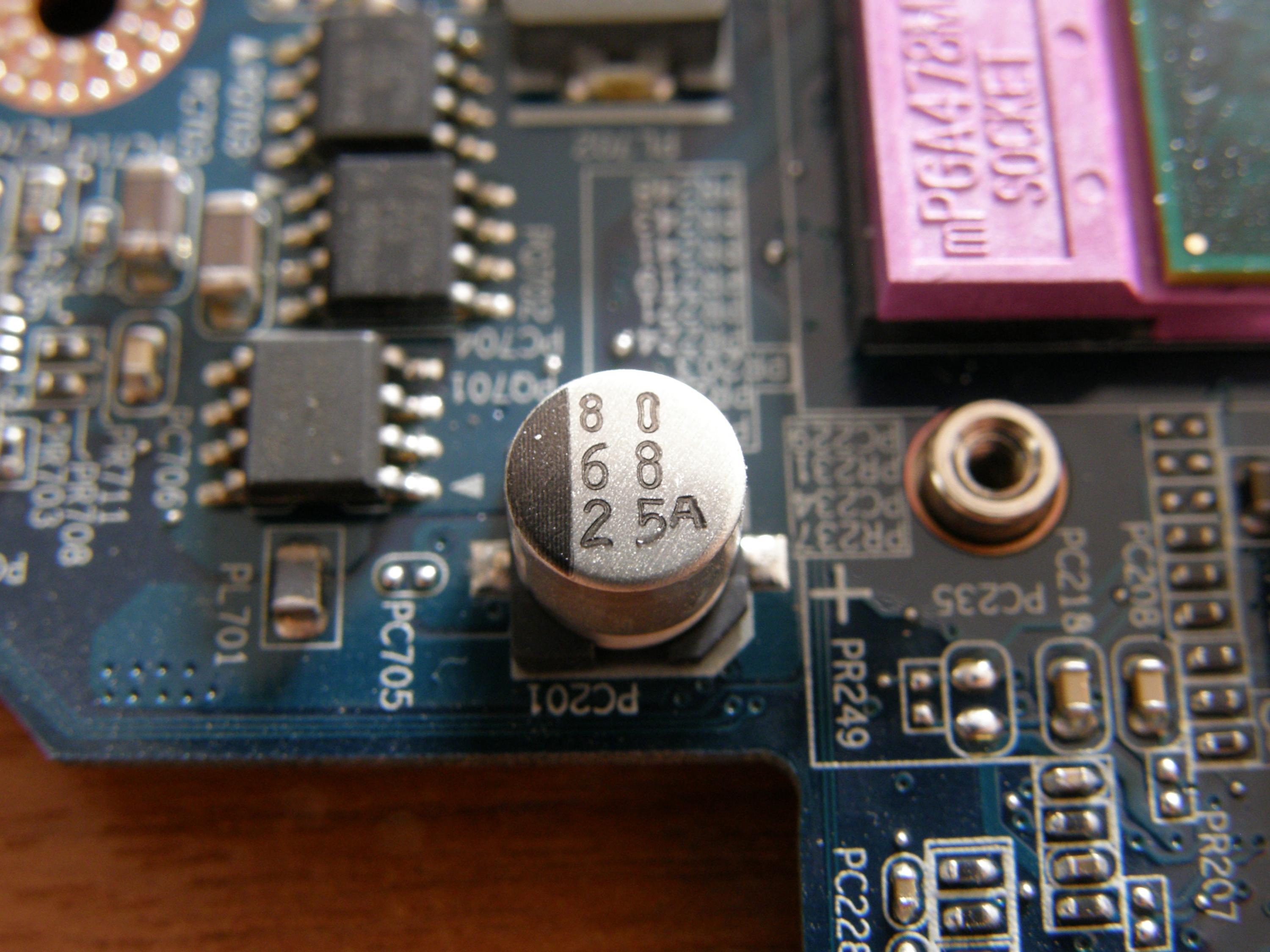

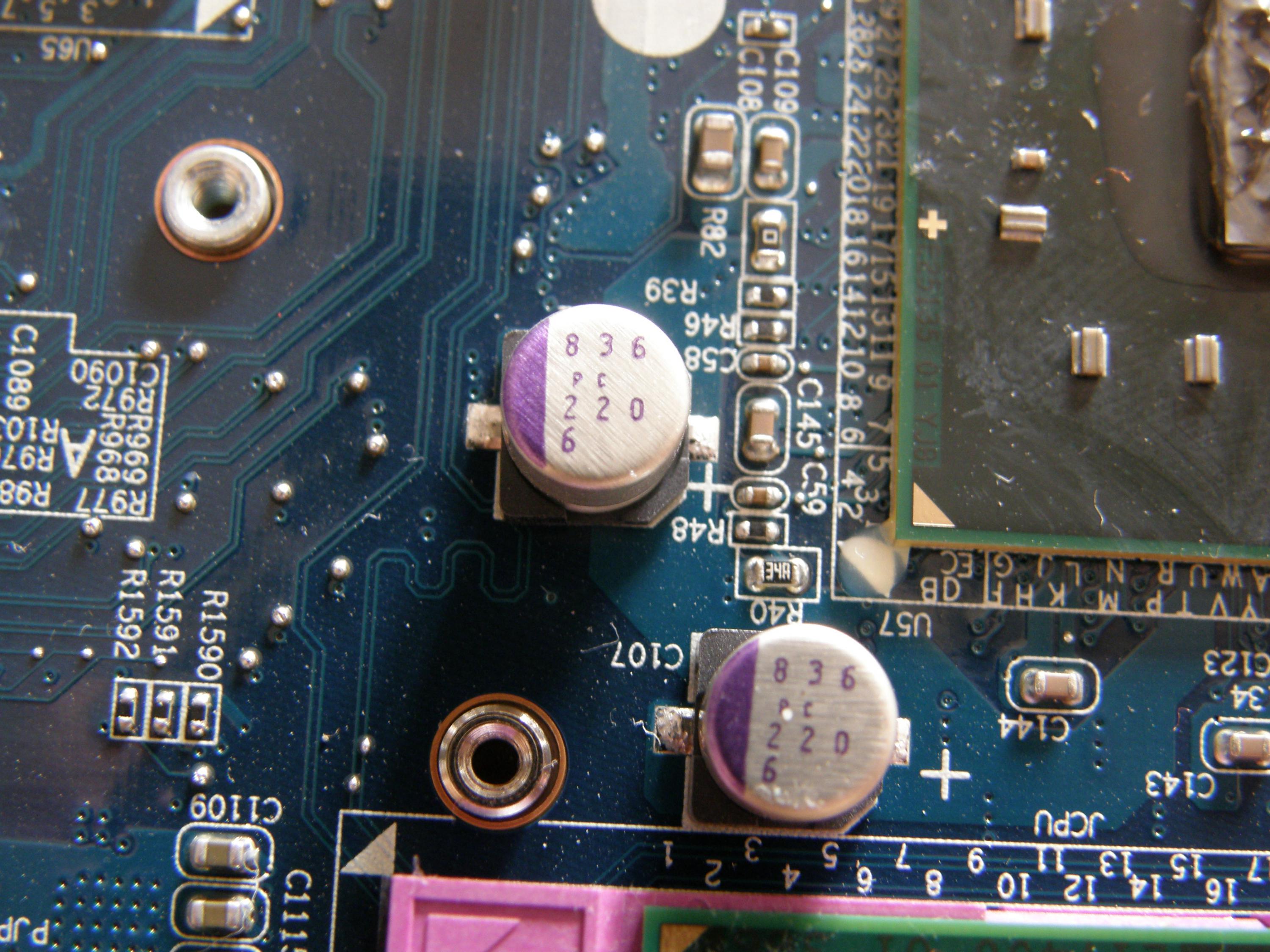

    Can anyone help me identify the following caps from a HP DV7 1130ev laptop?
    There are 6 caps with 836/pc/220/6 marking, 2 caps with 80/68/25A marking.
    and 2 caps with 8J2/330/6.3V marking.
    Alex

    what do you want to know?
    These are definitely 220uF 6V , 330uF 6.3V and 68uF 25V SMD capacitors.
