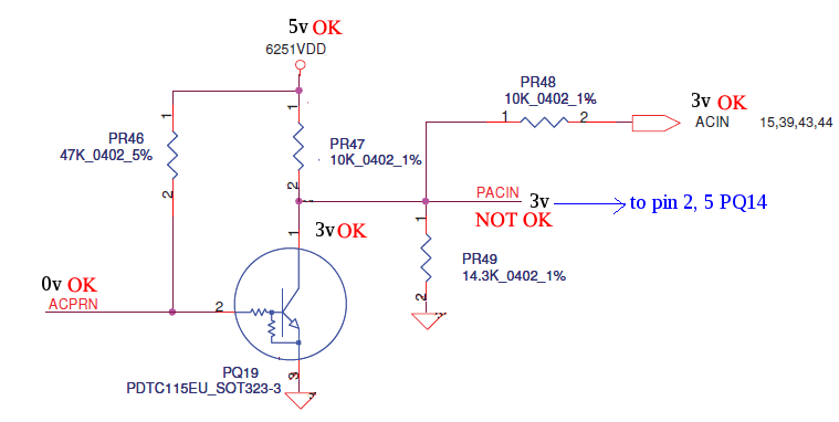

    correct values
    • ahmetozay
      • Jul 2013
      • 73
      • turkey
      Re: Acer Aspire 5750 no B+ voltage
      Originally posted by multiplexer
      correct values
      my measurements as follow

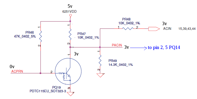

        correct values
        Better to put this way

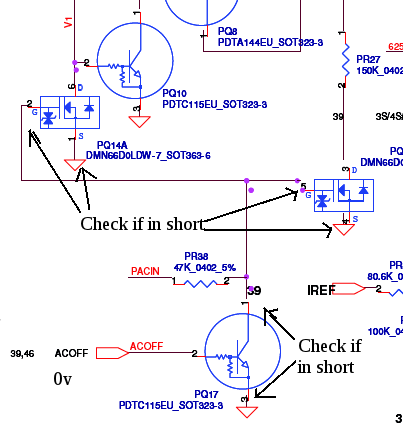

          pq17 must be shorted or acoff is on.
          have one of these with bad pq17
            Possible faults:
            ACOFF incorrect value
            PQ17 short between the collector and emitter
            PQ14 short between pins 1-2 and 4-5
              No shorts on PQ17 or PQ14. there is only one option left i think and it is ACOFF . I assume ACOFF comes from KBC so do you advice to change it or there is a way to test it.
              PS. if shorted pin 1 and 8 of PQ7 the system works without battery fine if i insert battery and short the pins of PQ7 short occures on Power supply.
              i have not tested with the battery beause battery is empty and i dont have other one

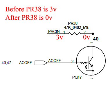

                Measure the voltage on ACOFF PQ17
                Desolders PQ17 if your laptop is running (no short on 1-8 FP7) program bios U36, U38
                  ACOFF is 0v
                  removed PQ17 but no start
                  now flashing U36 and U38 then write the result here
                  flashed both kbc and main but the result is same.
                  there is one odd situation when i turn on the power the output of PQ7 rises slowly upto 0.8v and when i turn off the power the output drops down slowly to 0v. i took a video and share the youtube link soon.
                    PR38 fails
                    replace

                            #33
                            PR38 fails
                            replace
                            removed PR38 and measured 47k as stated in the schema so PR38 is ok
