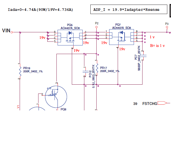

    Hi, i have 19v on pq7 but only 1v output thus no 3.3v nor 5.0 v always voltages and the system is dead at the moment. in the attachment i measured the voltages at start of the B+ rail. Any advices welcome
    Motherboard model is P5WE0 LA-6901P REV 2.0

    Measure the voltages on pins 1, 2, 8, 23, 24 of PU1
    Measure the voltages on all the pins of PQ14

        Re: Acer Aspire 5750 no B+ voltage
        u must have short to ground on B+ rail
        remove all PJP and check which powerrail is shorted
          Thanks for the reply
          i thought of that and shorted the pin 1 and 8 of PQ7 but there was no short. But after your message i tried to short 1 and 8 pin of pq7 but this time with 19v and the motherboard worked ok. Thus i changed the pq7 with the new one but still output is 1v, very strange

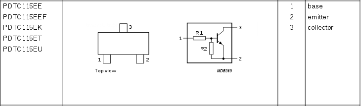

            Measure the voltages on all the pins of PQ19
            • ktmmotocross
              Boardkiller
              • Feb 2014
              • 3591
              • slovakia
              check resistance to ground on pin 5-8 on pq7
              • ahmetozay
                • Jul 2013
                • 73
                • turkey
                PQ19
                1=2.6v
                2=0v
                3=ground
                  Resistance is reading in mega ohms so definetely no short
                    did u use exactly the 4407?
                    • ahmetozay
                      • Jul 2013
                      • 73
                      • turkey
                      it was 4459 and i used 4435 instead
                      • ktmmotocross
                        Boardkiller
                        • Feb 2014
                        • 3591
                        • slovakia
                        on your picture it is 4407
                        but 4459 can handle TRIPLE current than 4435 so u probably burn that 4435

                                  Measures PQ19 taken according to this numbering?
                                  See Annex
                                  Voltages do not add up
                                  Considering the numbering as an attachment
                                  PQ19 pin 1 connected to pin 23 of PU1 (0V correctly stated)
                                  pin3 PQ19 (must essera to about 3V) connected to pins 2, 5 PQ14 (0V incorrectly stated)
                                  Pin 2 to ground PQ19
                                  Check that the pin 2 of 3 PQ19 are not short.

                                        i've checked PQ19 but only 1 pin is shorted to groun other pins are not shorted
