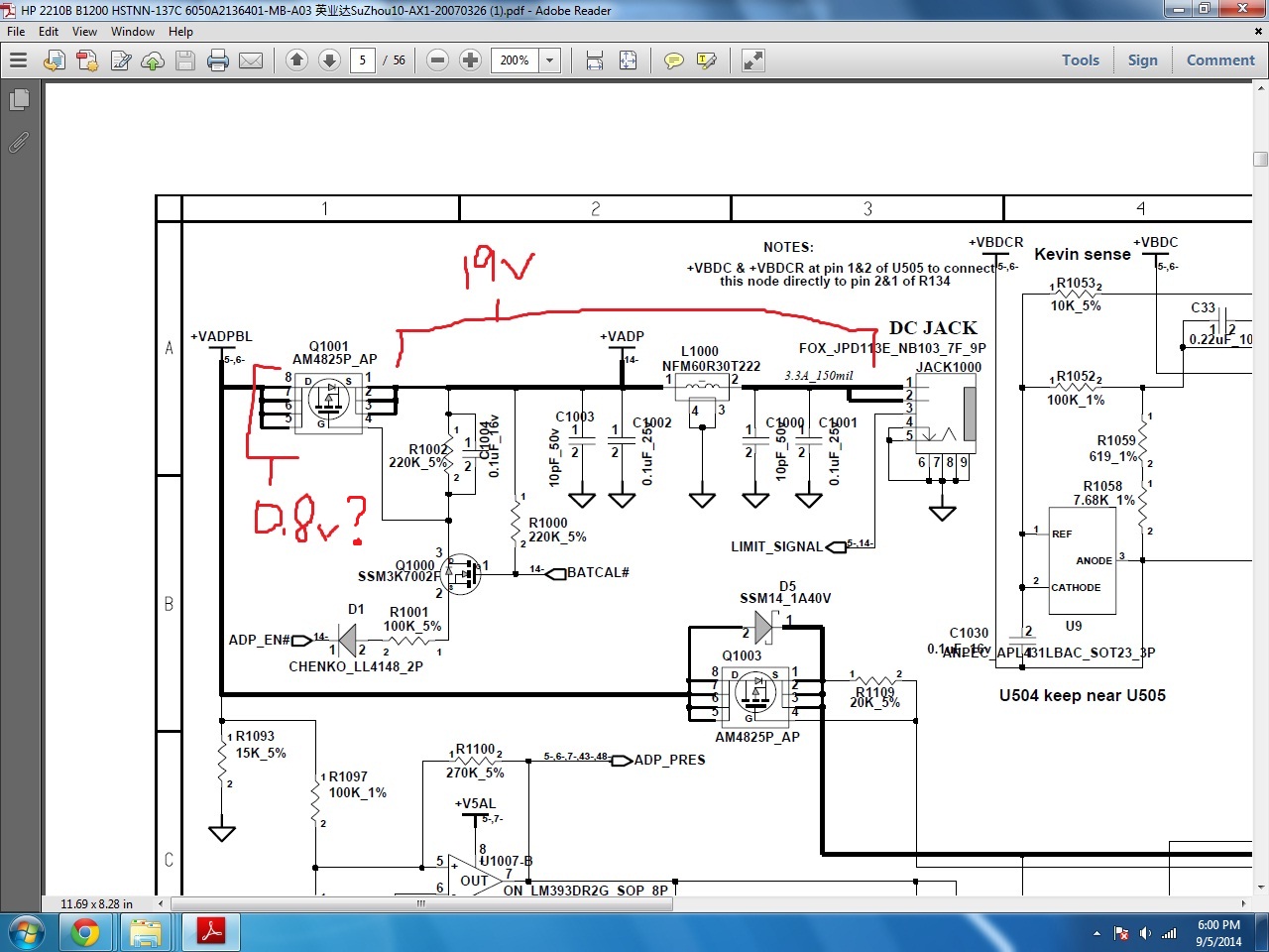

    mb code:
    hstnn-137c 6050a2136401-mb-a03
    hp compaq presario b1200 no power
    burnt mosfet AM4825P_AP
    replaced with same but still no power
    correct me if im wrong please
    but wont the 19v in pin 1-3 of q1001 also goes to pin 5-8
    somehow, 19v wont get past mosfet q1001
    it seems like mosfet wont switch?
    attached are the schematics
    please help
    thanks in advance guys
    Re: hp compaq presario b1200 no power
    Are you sure you have the correct power adapter? That is the circuit that senses the adapter via the center pin.

        If Q1001 is getting hot then +vadpbl line short I had some filter caps short used the bench power supply to find it showed up after 20sec,the cap got hot.
