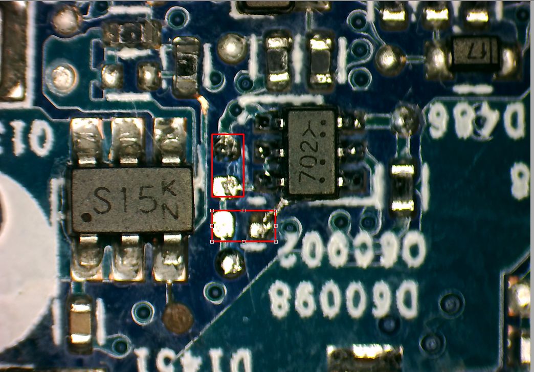

    Hi all.
    Please can you help me with identification missing components on board 6050A2892401-MB-A01 HP EliteBook 840 G3 .
    It is two resistors .
    I don`t finding schematic and boardview for this model.
    Thx.

    Re: Missing components identification 6050A2892401-MB-A01
    have spare board here, left: 0.460 MOhm, under: 476 kOhm resistor
      Did you measure the resistors unsoldered or directly on the board?
      If it was on the board, the values are distorted.
      Thank you very much for the quick help.
        lol, out of circuit xD
        • bushmann
          • Feb 2014
          • 147
          • Slovakia
          Why am I asking?
          Because you write the lower value in MΩ and the higher value in KΩ.
          Thanks.
            Why am I asking?
            Thanks.
            yeah, i thought this is more diversified :o(. have a great day

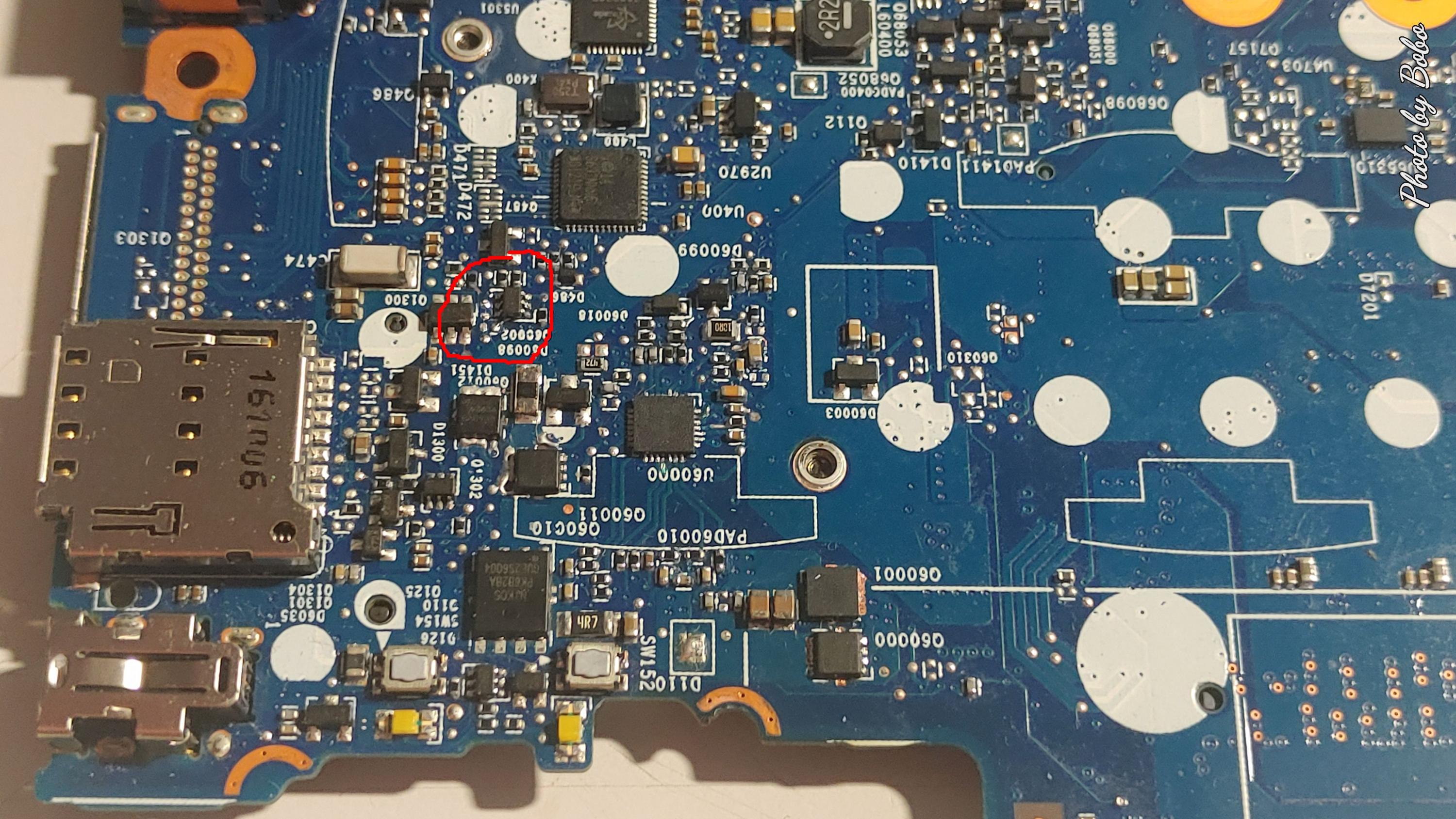

              hi there
              looking for hi res photo for hp motherboard 6050A2892401-MB-A01
              ic U66000 is missing , its a qfn 48 , left side of ec ic nuvoton
              any one has ic number or picture of this area
              thanks in advance
