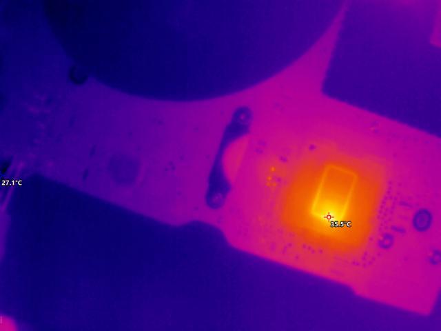

we have a MacBook A1707 with 820-00928-A motherboard that switches to 20V but drain just 0.01Ah.
Customer declared that this machine is used "as desktop" (always connected in the wall, and nearly never moved from his spot). No signs of liquid damage or burns inside, but there's a low resistance on PPBUS_G3H.
Injecting 1V makes PCH to immediately heat a bit (picture attached), so I guess there's a shorted mosfet or something like that somewhere. We still not removed the heatsinks to check if this happens on CPU/GPU too, but I'm here to ask were to start to inspect at least for PCH because there's no direct connection at all from PPBUS_G3H and PCH's mosfets (instead, CPU and GPU have theyr shunt resistor between PPBUS_G3H and mosftes, but for PCH I got lost, lol).
Thank you.
