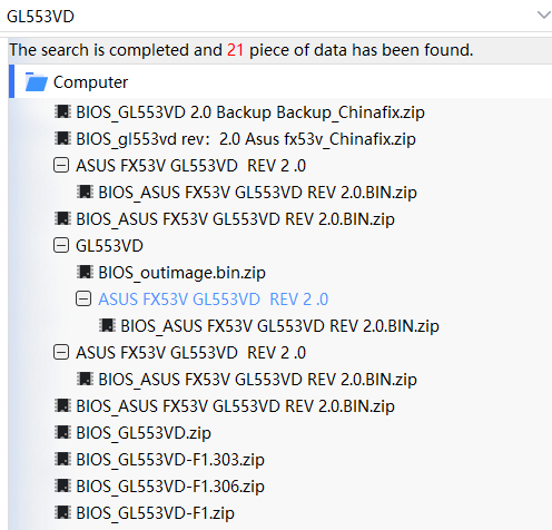

      Let me know if you need any of these.

            The EC and BIOS would be useful:
            Asus ZX553V
            GL553VD Rev 2.0
            SN H6N0CV01P629223
            I guess 4-8 ohm on CPU rail would be normal on inductors

                Posted the bios images from my database under post # 87
                https://www.badcaps.net/forum/troubl...-gl553vd/page5
