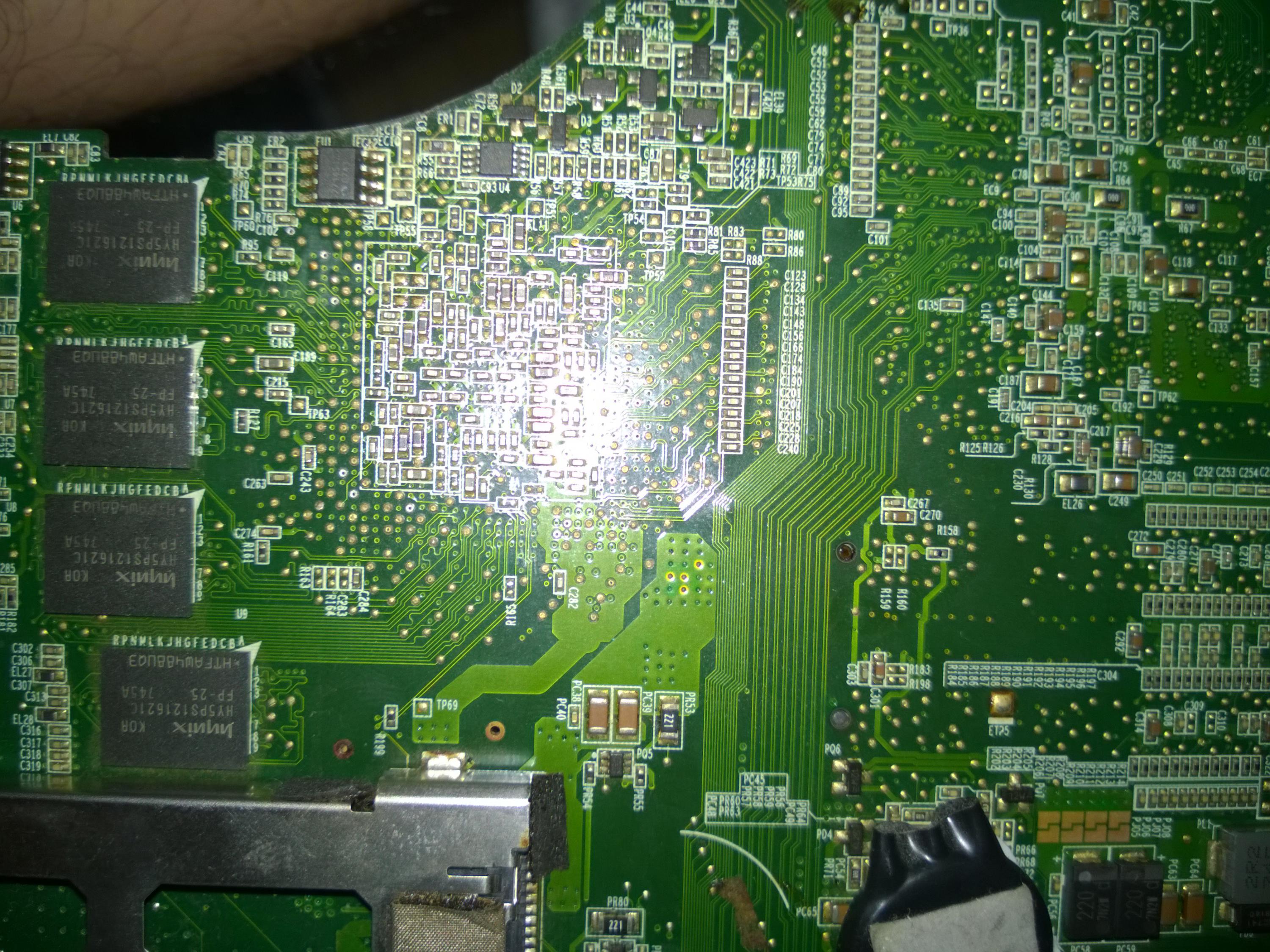

                    Ok here is the front, later I'll post (when i take it apart). If you need clearer pictures tell me .

                      I need to know the part numbers of the two multi-pin ICs located above the GPU. U513 and U516 if i see well. By the looks of it U516 seems to be the PWM controller for the vcore supply, but i can't be 100% sure until you post the part numbers.
                      A working TV? How boring!
                        Re: Medion mim2300 fan mod
                        U516 = P2231TF C1, U-FN77A, L-07402
                        U513 isn't located near the GPU i need to open it.
                          P2231 = TPS2231, which is an ExpressCard power controller. So it's not what we are looking for. The controller for the GPU Vcore may be on the other side of the board.

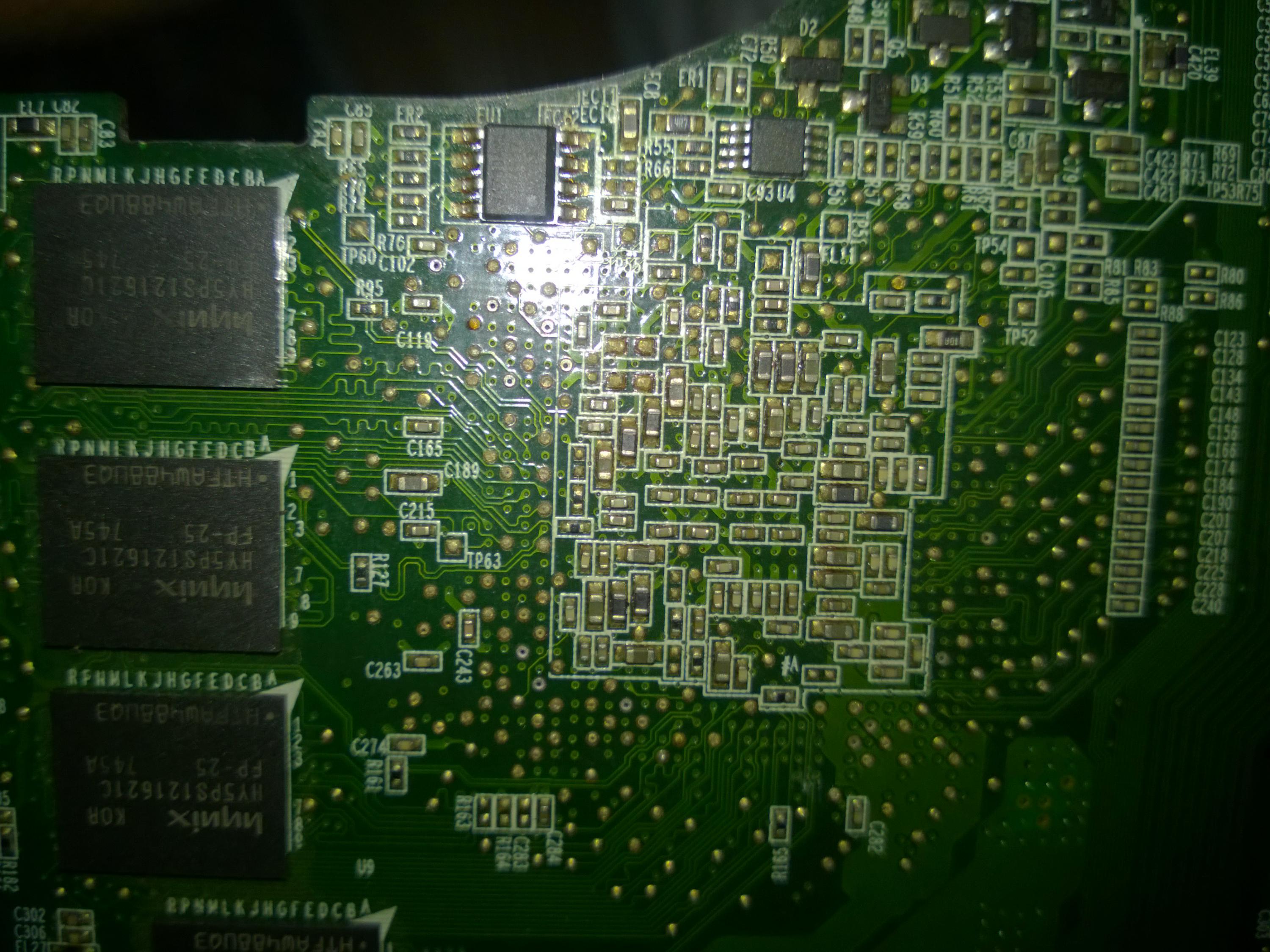

                            I'll post pics in few minutes from both sides and details from U513.

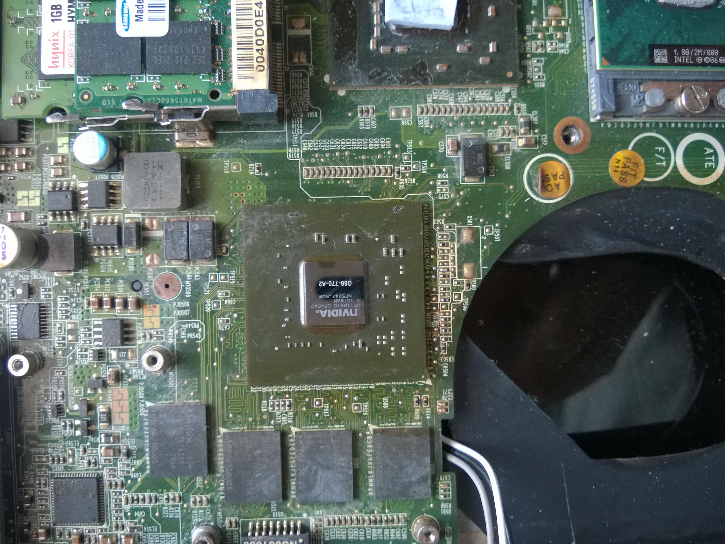

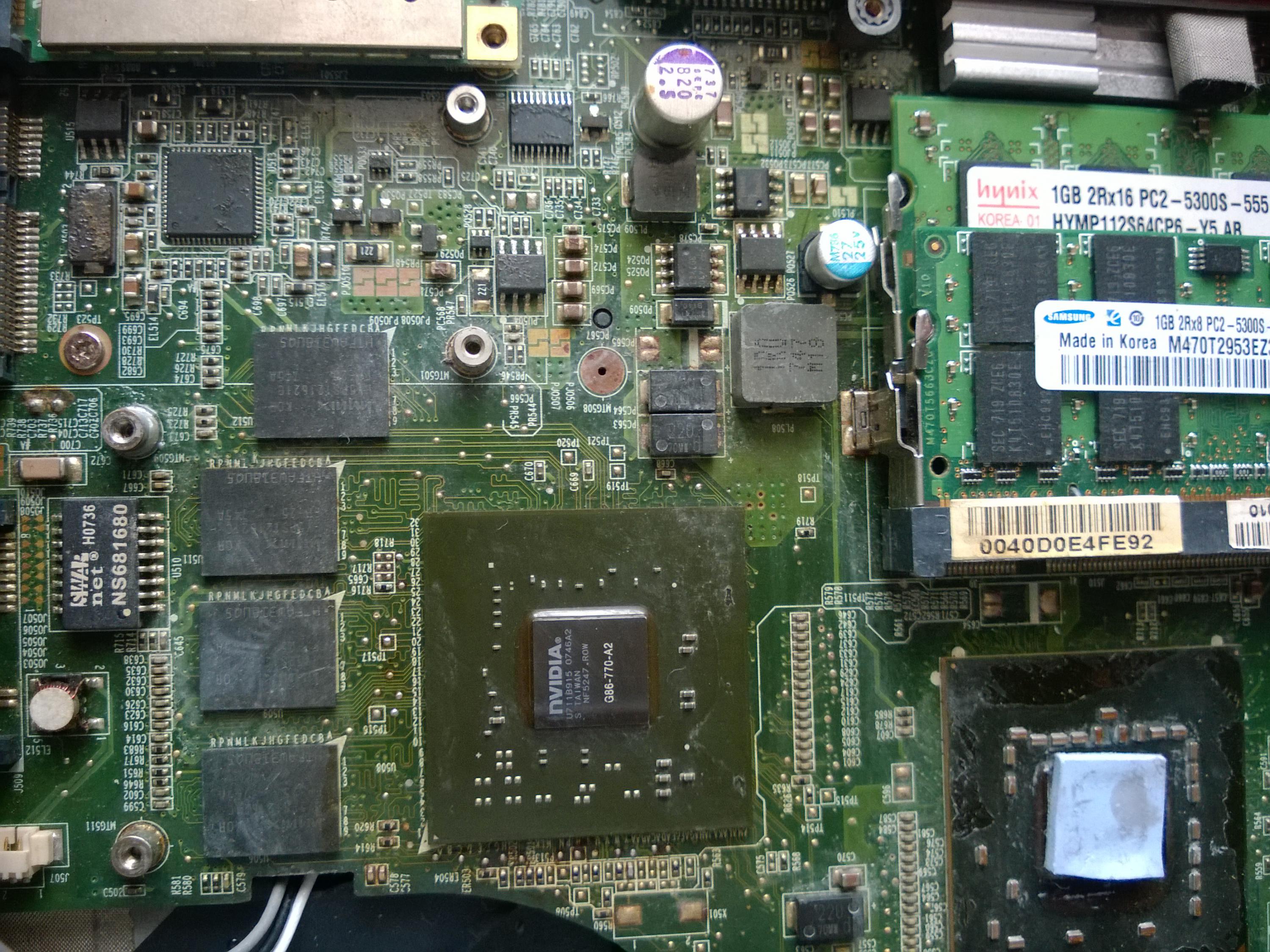

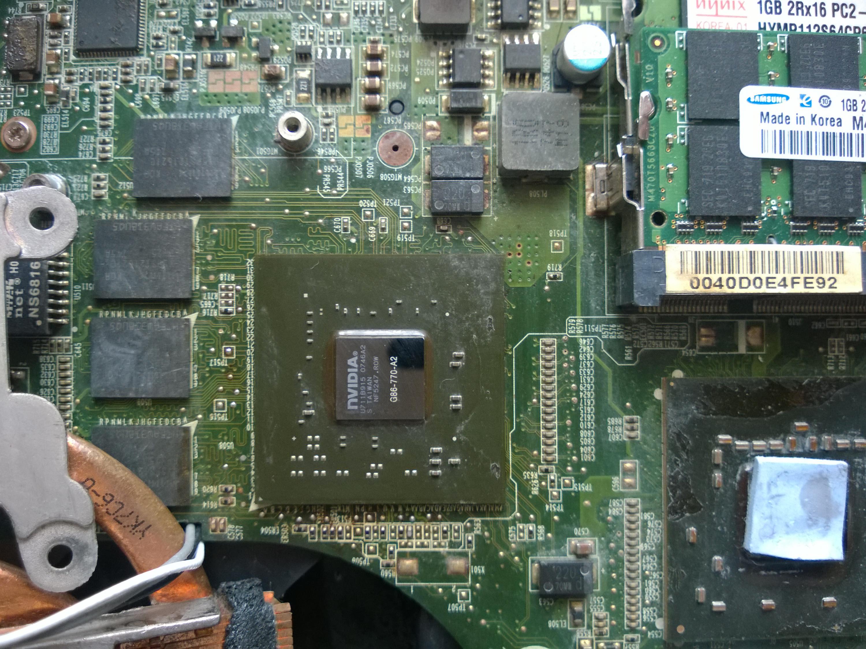

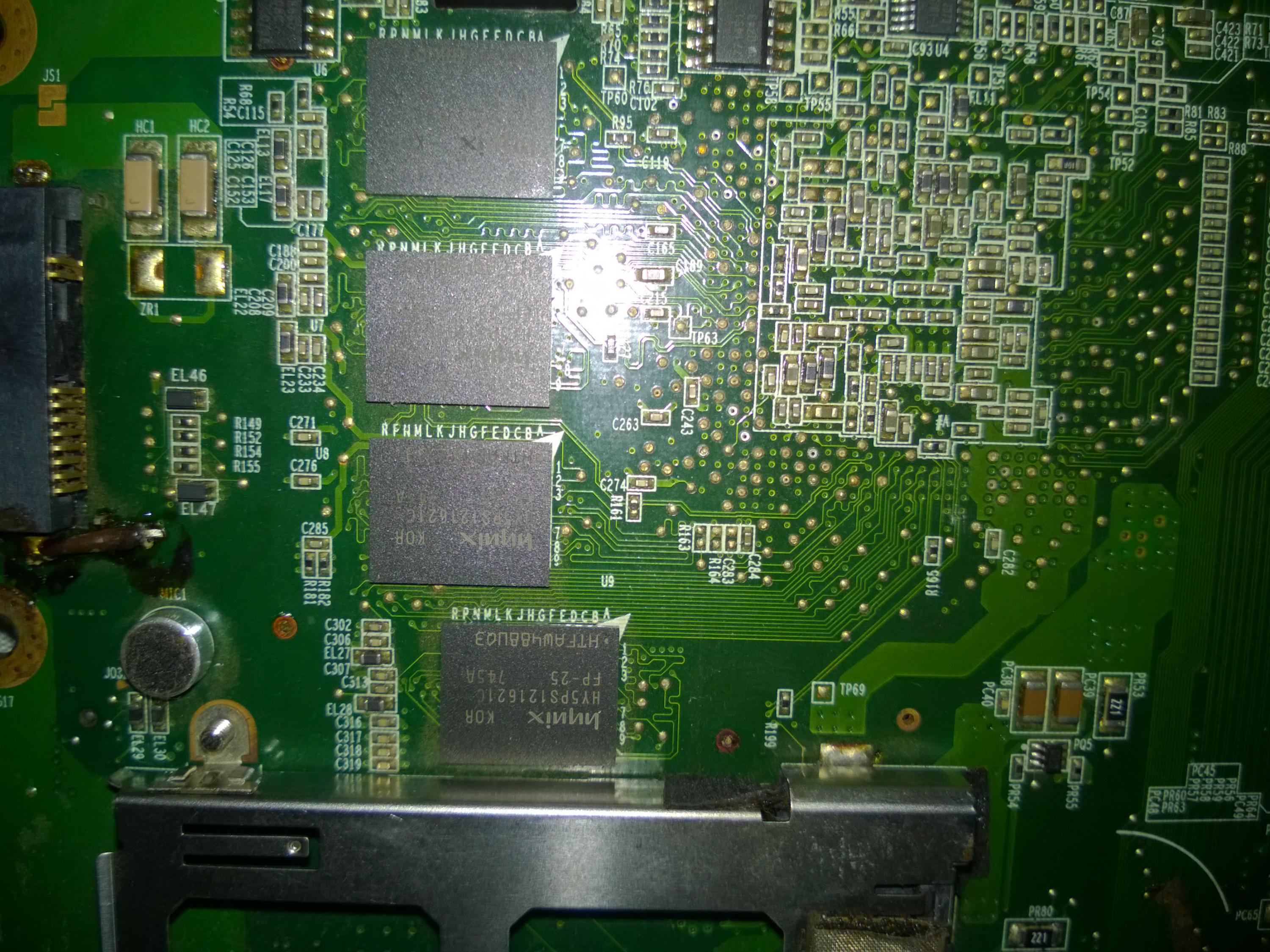

                              Under the GPU is the following picture, and there we have bunch of capacitors. Since i don't have a schematic and got no clue what to look for I'll just post it and await some response when you have time .

                                The pictures aren't much help without part numbers, sorry.
