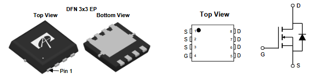

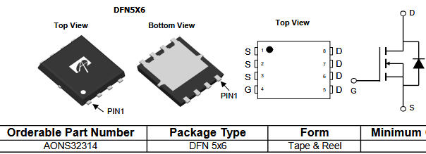

      Suggest to check PQ1003, PQ1002, PQ1001; and PQ1011, PQ1012, also post the markings on those MOSFETs
      With all power disconnected (no charger, no battery) Measure resistance from S-D, S-G, D-G on those MOSFETs and post the values here

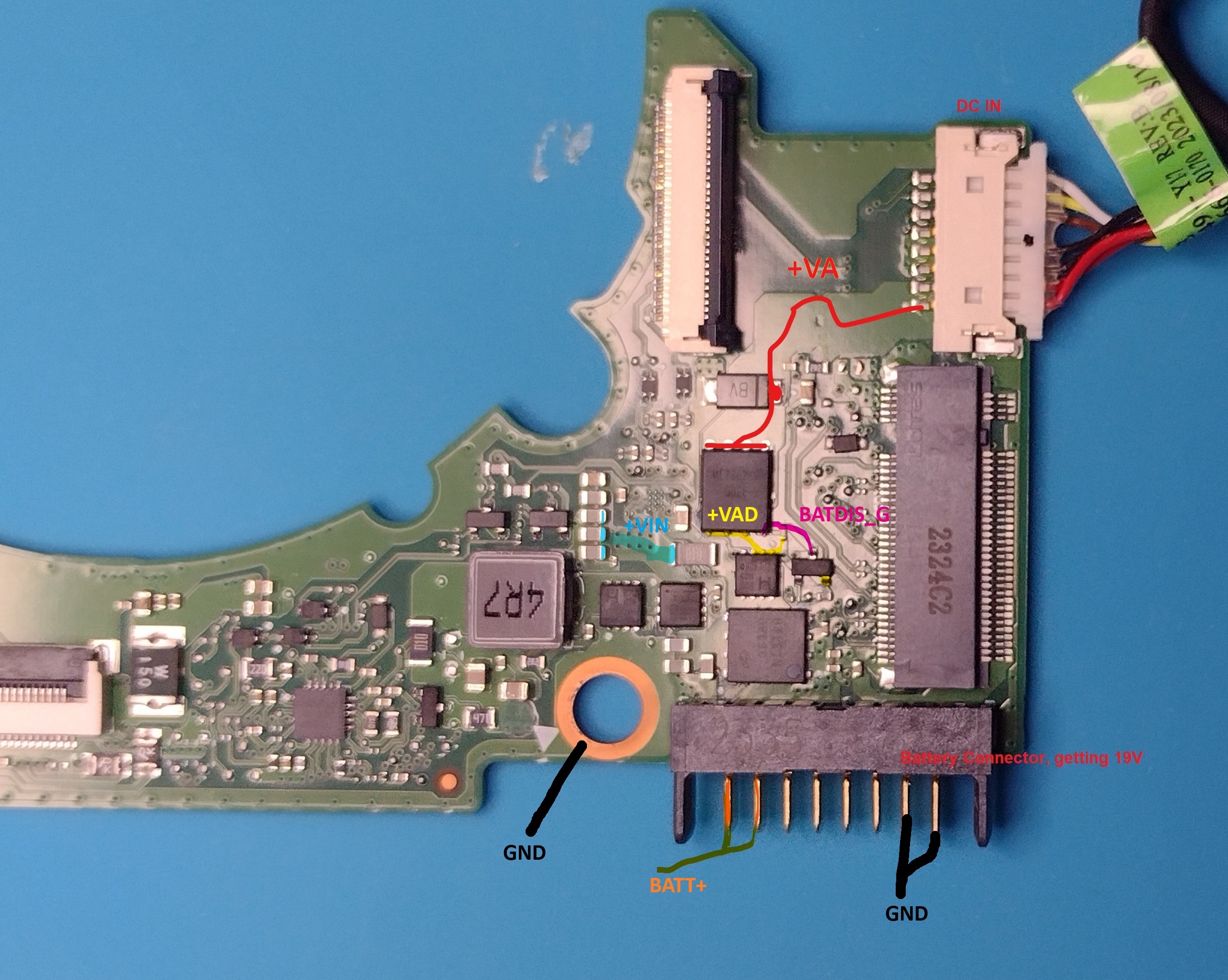

            Now, with only the charger (no battery), measure the following voltages respect to GND and post them, you need sharp probes for your multimeter
            +VA, at the red wires from the charge port connector (it's the charger output voltage)
            +VAD, at pins 1-2-3 of PQ1001-PQ1002, it should be the same as +VA, after 1st MOSFET
            +VIN, at PR1001, you should get the same voltage, maybe a tiny bit lower (around 0.01V less or so)
            BATT+, with no battery connected
            Also measure the voltage BATDIS_G at the Gate of PQ1001-1002, you can probe it at pin 3 of PQ1006, it should be around 25-26V
            Click image for larger version  Name:	measurements hp15dy.jpg Views:	0 Size:	1.04 MB ID:	3670416
            Click the image to enlarge, I marked where you can measure those voltages

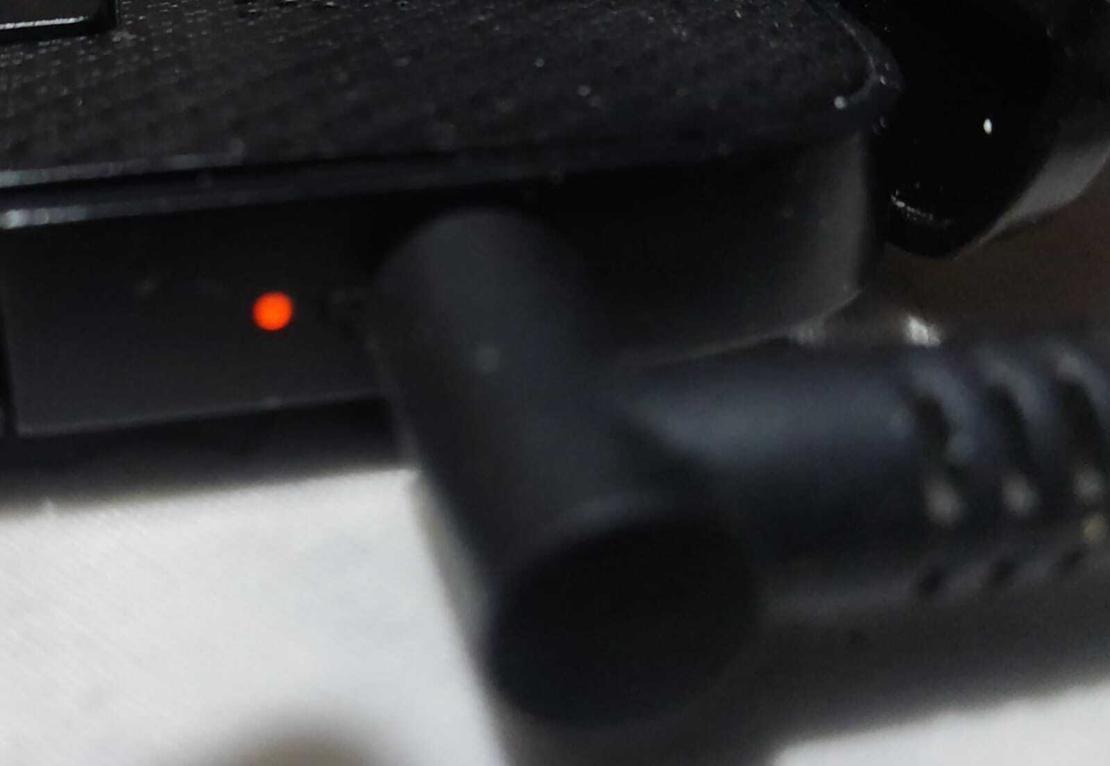

            Confirm if the LED at the charge port turns white with only the charger connected; if everything works properly laptop should power on with only the charger (no battery), as the charge circuit allows for this, it switches the main power rail +VIN between charger or battery

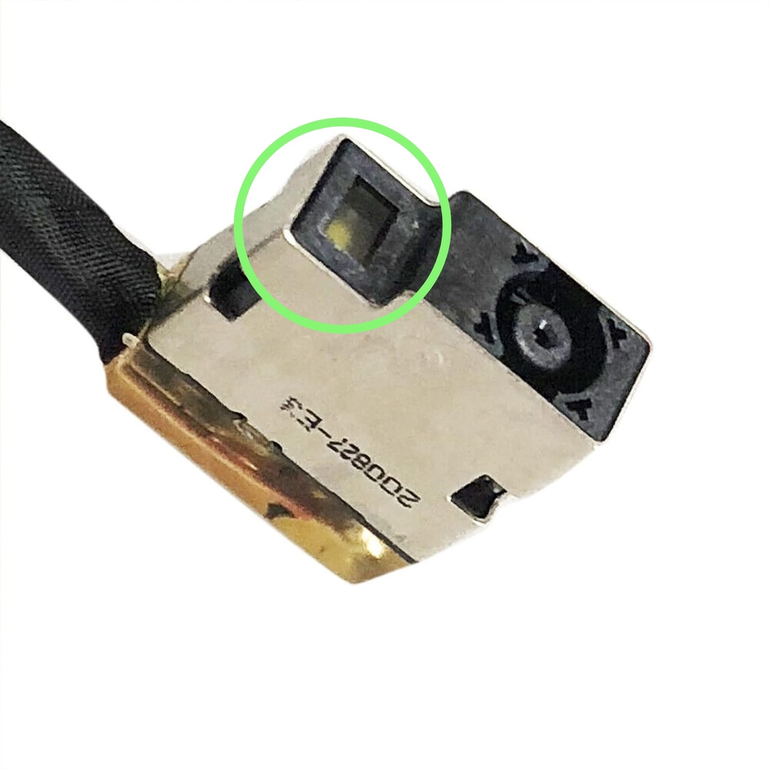

                Motherboard out of the case, also the charge port, the power button according to the schematics is on a separate board with 2 USB ports, you can remove it from the chassis along with its cable
                The charge port on HP laptops has a white/orange LED on it, it turns orange when charging the battery and white when fully charged
                But with only the charger plugged in it should turn white

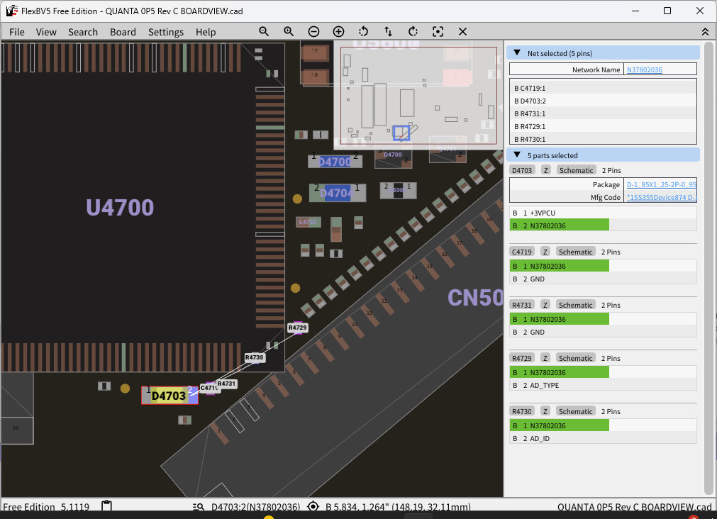

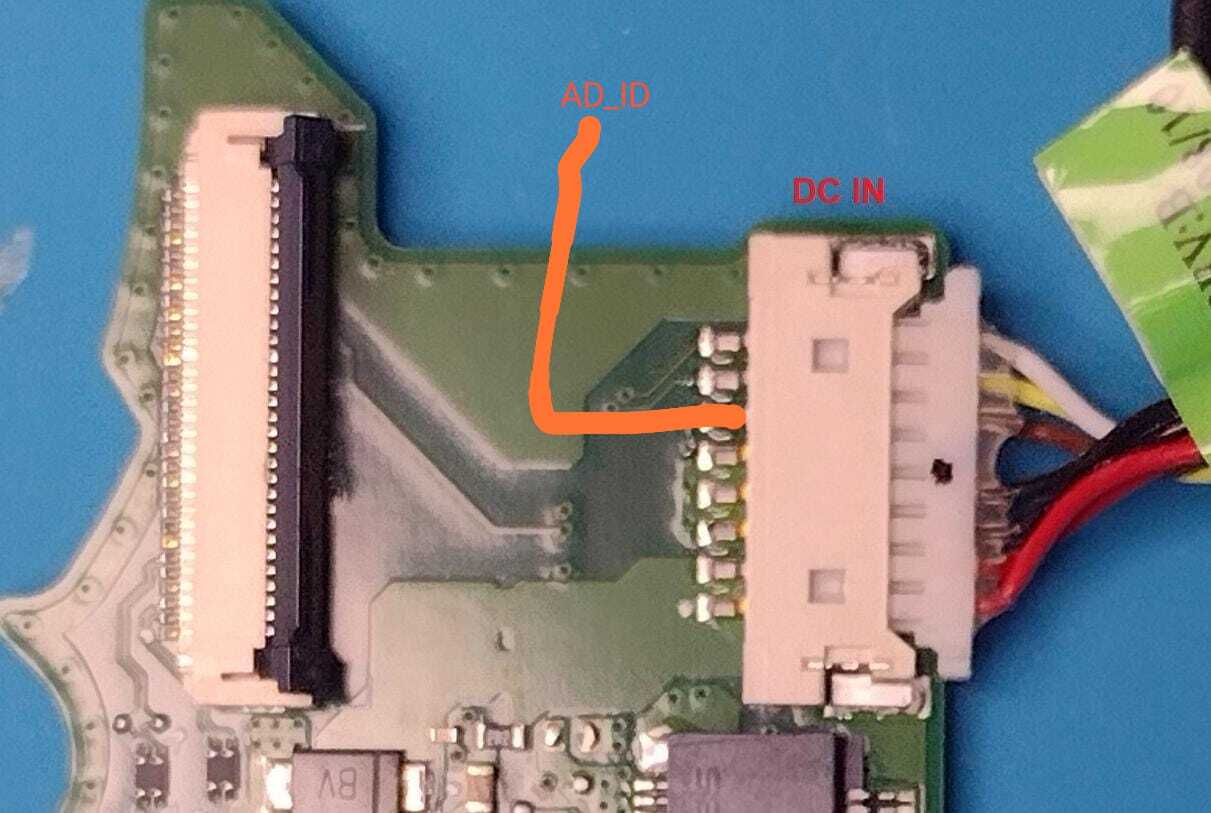

                    Ok, power is getting to the board (+VIN), but it's not detecting the charger type, as the LED on the charge port should turn solid white after plugging in the charger
                    Use an HP charger, 45W-65W, a Dell charger won't work even if they have the same plug (the adapter ID pin works differently on HP and Dell)

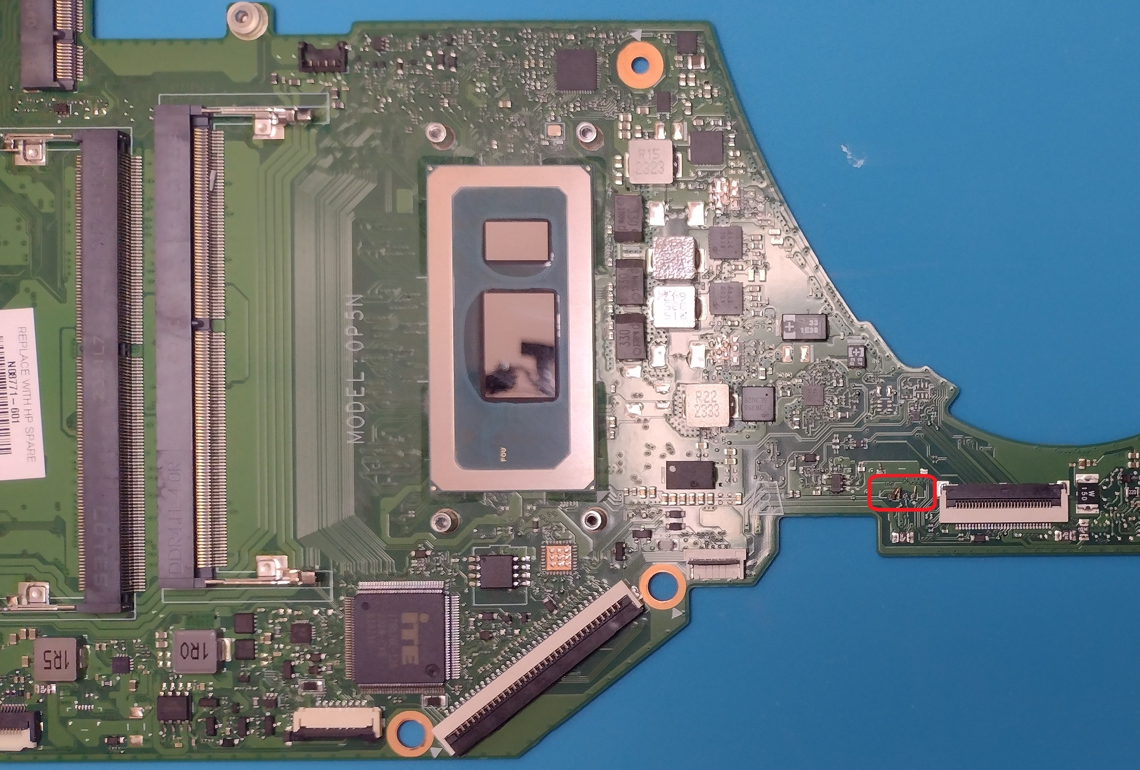

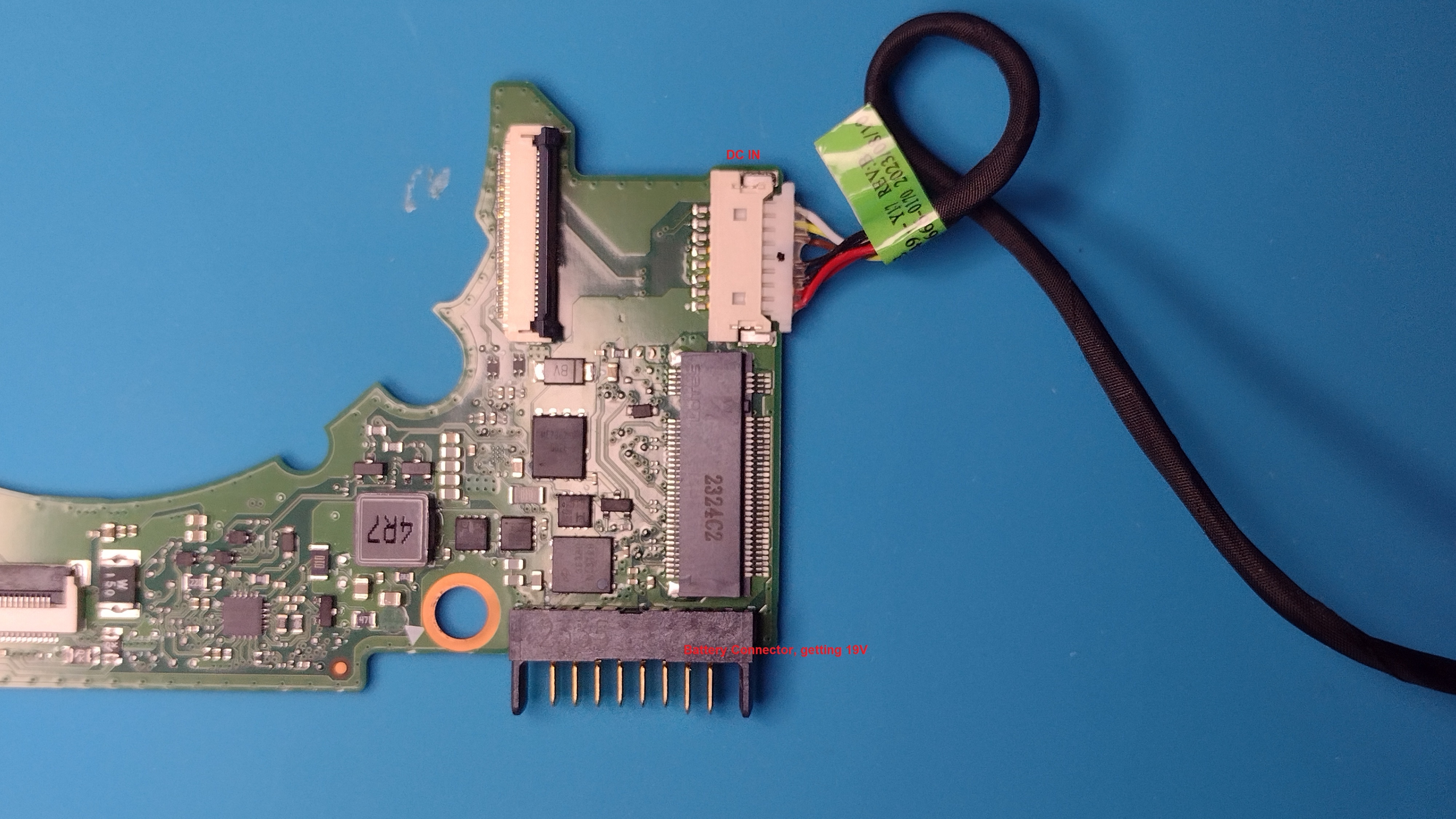

                    Measure voltage at AD_ID respect to GND on the DC jack connector on the board, be very careful not to short the multimeter probe to the other pins
                    Click image for larger version  Name:	ad_id dcjack.jpg Views:	0 Size:	80.2 KB ID:	3673481
                    Click image for larger version  Name:	ad_id.jpg Views:	0 Size:	68.2 KB ID:	3673482
                    EDIT: Added location of "Adapter type check" circuit, very close to the keyboard connector
Name:	ad_id boardview.png

                        Charger is authentic/original charger and I even tried another known good charger and same thing.
                        AD_ID (3rd pin) showed 7.23 K Ohm whether the charger is plugged or not.
                        I am sorry, I didn't understand what I was supposed to do with the last 2 images?

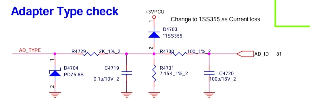

                          The last 2 images are the adapter type detection circuit, forgot to tell to measure the resistors, sorry
                          7.23K to GND on AD_ID is fine if you check the schematics, you have 100 ohms (R4730) + 7.15K (R4731) = 7.25K, but you should measure voltage (meter in Volts DC) on that pin
                          Only thing left is:
                          With no power to the board, measure resistance across R4729, should be 2K
                          Hopefully HP placed it in the same location as the previous years model, please post a picture of the area near the keyboard connector / IT5570 to confirm if that area matches the DA0P5D*** boardview
                          Also check R4727 and R4728, those are on the back of the board, according to the table on page 47 of the 0P5D schematics, you should have:
                          R4727: NC (missing)
                          R4728: 10K
                          for 45W adapter
                          What I meant before for charge port LED, is this
Name:	hp charge led.jpg

                            PS. That LED never had any orange light. I am used to seeing that with laptops when they are charging but not this guy.
                            Only thing it does is, white LED flashes 3-4 times, each time I press the power button. That is it.

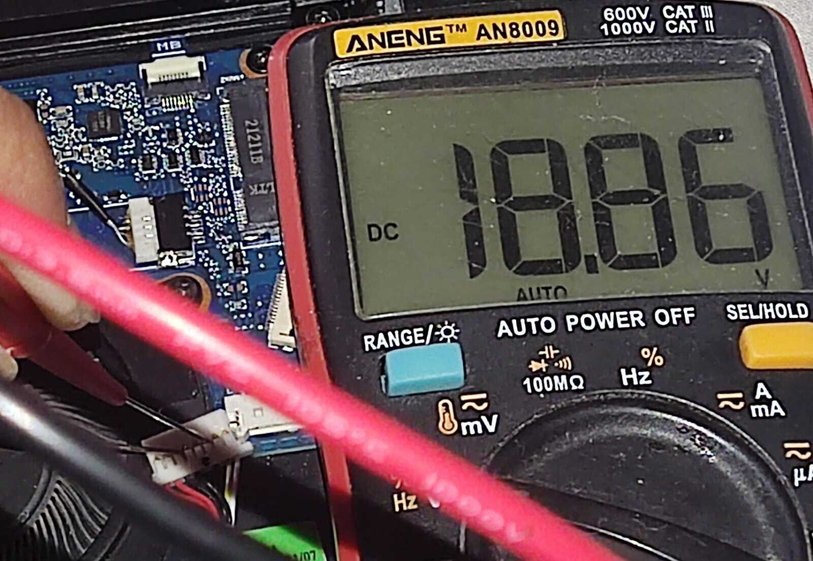

                              Before I forget, check the charge port cable
                              Unplug it from the motherboard, connect the charger to it then measure voltage (meter on volts DC) between the brown wire and one of the black wires
                              With it unplugged from the motherboard, you should get around 18-19V
                              If there's no voltage, it may be the faulty part after all; plenty available on amazon and ebay, search for "HP 15-dy dc jack cable", or the part number that's on a green sticker
                              Plugged in to the board, the voltage in that pin should be less than 3V, as the resistor inside the charger + the resistors on the board form a voltage divider

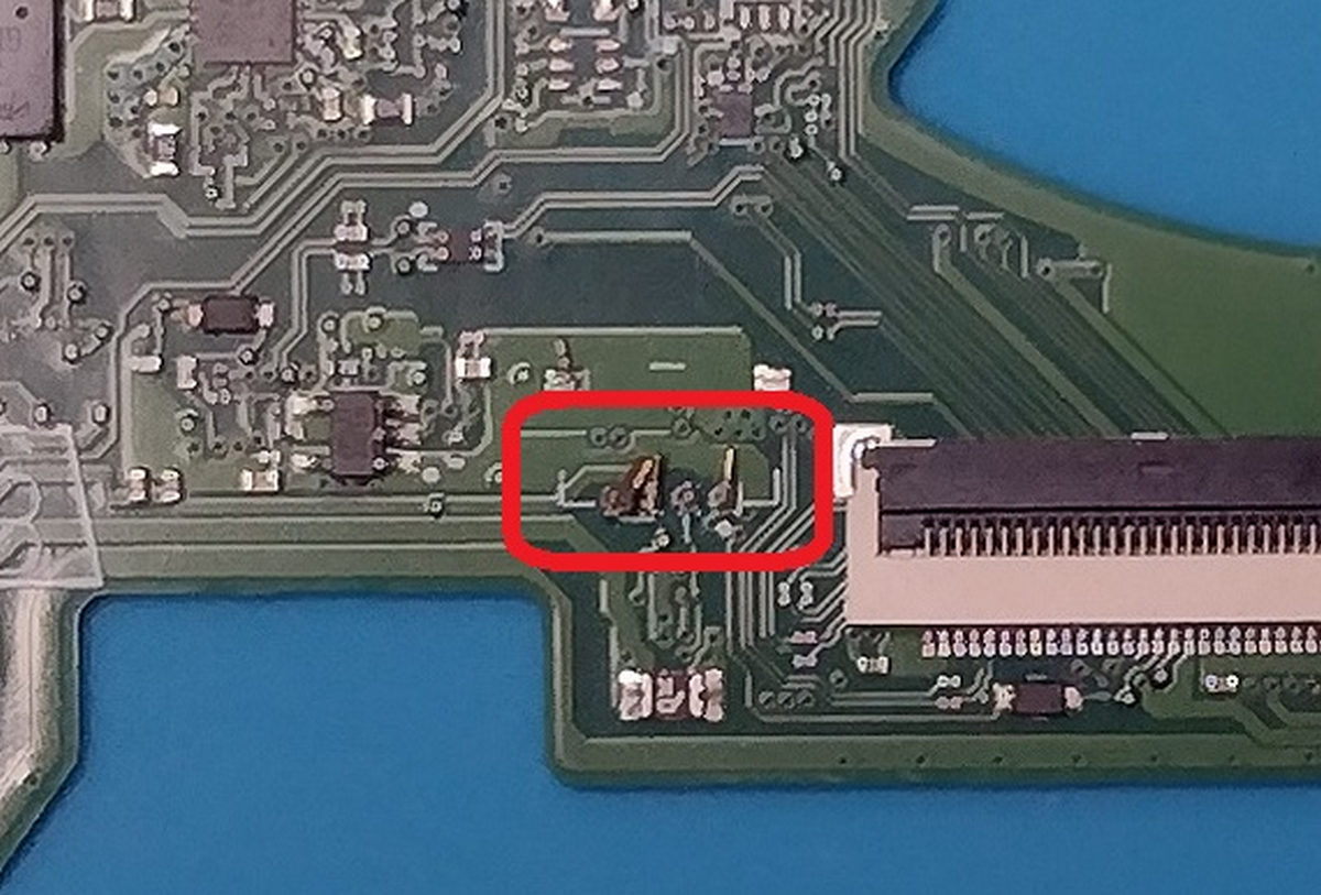

                                  I will check the rest of the ones you mentioned in your last 2 posts but I wanted to share the following to see if it was indeed the DC port that was faulty:
                                  AD_ID pin 3 measured 1.44V when the DC port was connected to the motherboard, separated from the board, the brown wire to one of the black ones measured: 2.2V not 18/19V as you mentioned.

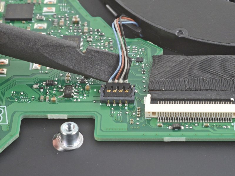

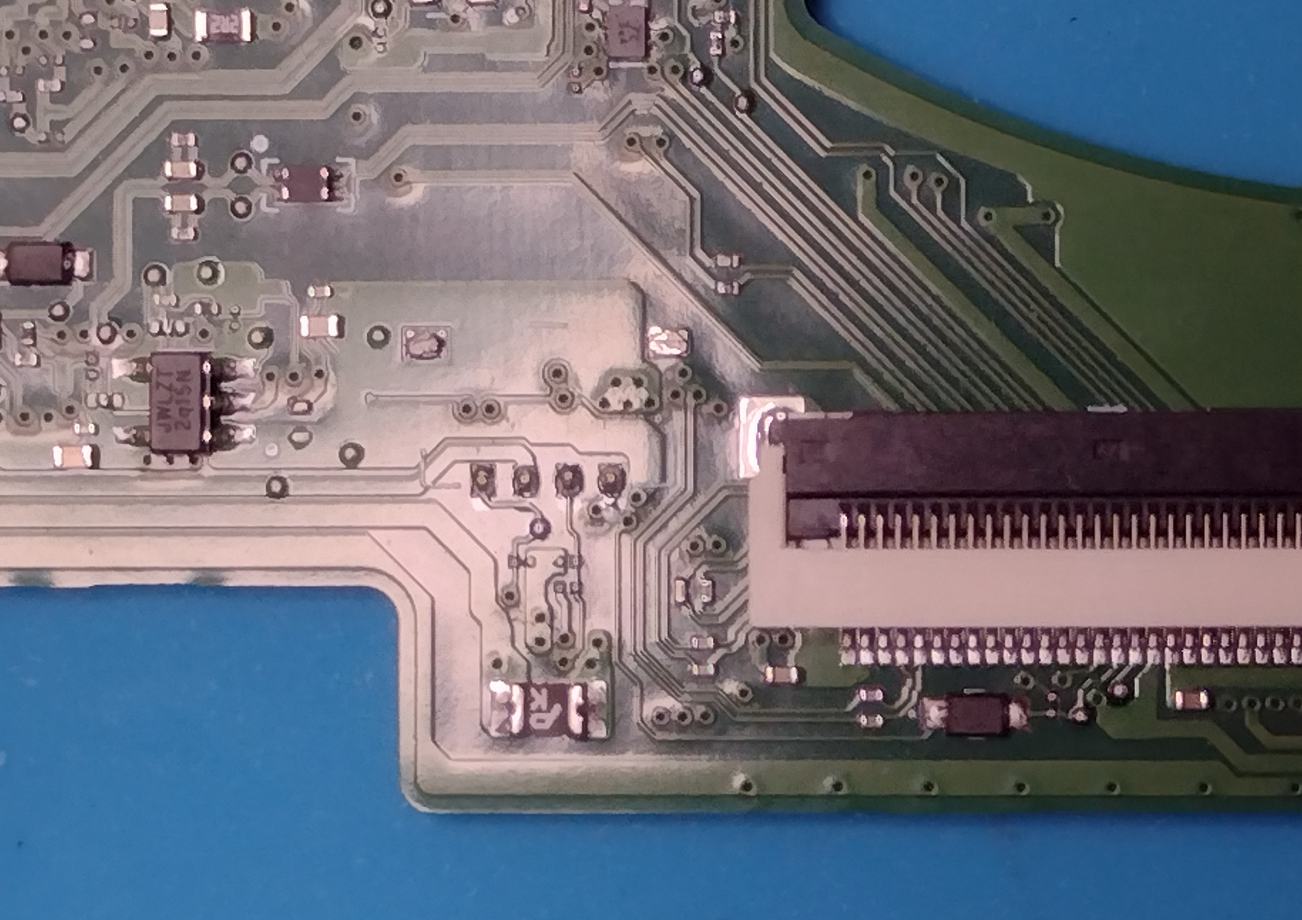

                                  As this machined was opened at least once before with cover screws missing, case corners damaged, etc., I could tell this laptop suffered quite a bit.
                                  I also noticed the CPU/Heatsink fan was dangling with some of the wires broken (but I do believe fan was still running).
                                  That plastic port piece seemed fused to the fan connector and despite my best efforts it came apart from the board.
                                  Please see the attached image. can that fan port be replaced with a new one? If yes, any idea what would that be part called exactly?
                                  Thank you again.
                                  • m1ch43lzm
                                    • Mar 2019
                                    • 1012
                                    • Peru
                                    DC jack seems faulty, as I just tested on an HP laptop I have, with 45W AC adapter (different model, but the Adapter Type Check is the exact same circuit), and I get 18.86V on the brown wire (disconnected from the board)
                                    And plugged in to the board, I get 0.288V on AD_ID pin on the motherboard
                                    Make sure you don't touch the probe tips with your fingers, as that influences the readings

                                    Last check, is to measure continuity from the brown wire to the center pin of the DC jack, multimeter should beep, resistance should be close to 0 ohm
                                    If it fails that, replace the DC jack
                                    Thank you again.
                                    For the fan connector, i haven't been able to find a US supplier for the connector listed in the schematics, it's out of stock at digikey https://www.digikey.com/en/products/...1-001/26766564
                                    This one looks close
                                    https://www.digikey.com/en/products/...710004/2424925
                                    Maybe someone else used glue on the fan connector, as it can easily be disconnected by pulling upwards from the wires
                                    Picture from ifixit guide
                                    ​​​​​​​Also make sure the remaining pins don't touch each other​, careful not to damage the PCB tracks as that would be more difficult to repair
                                      Click image for larger version  Name:	ad_id DC jack.jpg Views:	0 Size:	152.9 KB ID:	3674318
                                      Double checked the brown wire and same thing. Then power disconnected, auto-ranging mm beep with less than 1KOhm on the display.
                                      I am thinking about replacing the DC port at this point as I suspected it might have been faulty (the charger doesn't sit as firmly as I thought it would.
                                      If the issue persisted after replacing it, then I could continue with the rest of the checks.
                                      Click image for larger version  Name:	qrMTiiccVkhmmhtl.large.jpg Views:	0 Size:	91.1 KB ID:	3674319
                                      Also make sure the remaining pins don't touch each other, careful not to damage the PCB tracks as that would be more difficult to repair
                                      Thank you. I didn't even know what the proper name of the part was and searching for molex laptop fan connector brought weird results.
                                      I have taken those fan a handful of times before and using a similar pick tool, it would not come off.
                                      I was trying to hold the base piece down using tweezers but eventually it snapped off.
                                      I believe at least one of the pins is still on the board but I will reexamine.
                                      I also have a few donor laptop board which I will check to see if one from any of those would be compatible.
                                      I will report back once I have an update.
                                      Thank you again for all your help.
                                      ~TL
                                      PS. None of the old laptop motherboards have the same top connect molex so I will have to shop for it.
                                      I think the second one you linked looks like it! I doubt anyone would sell just one so I may end up buying a set just in case.
                                      • TurcoLoco
                                        ocoLocruT
                                        • Mar 2025
                                        • 66
                                        I ended up ordering 5 of each end (housings/receptacles) 78271 & 78172 just to justify the shipping cost! =)
                                        I examined the board and removed a few flakes of remaining pin particles and everything looks healthy on the board.
                                        If I can solder it without melting it (SMD components with plastic parts/base make me really nervous), I will be stoked!
                                        I will keep you posted when all parts are received and installed.
