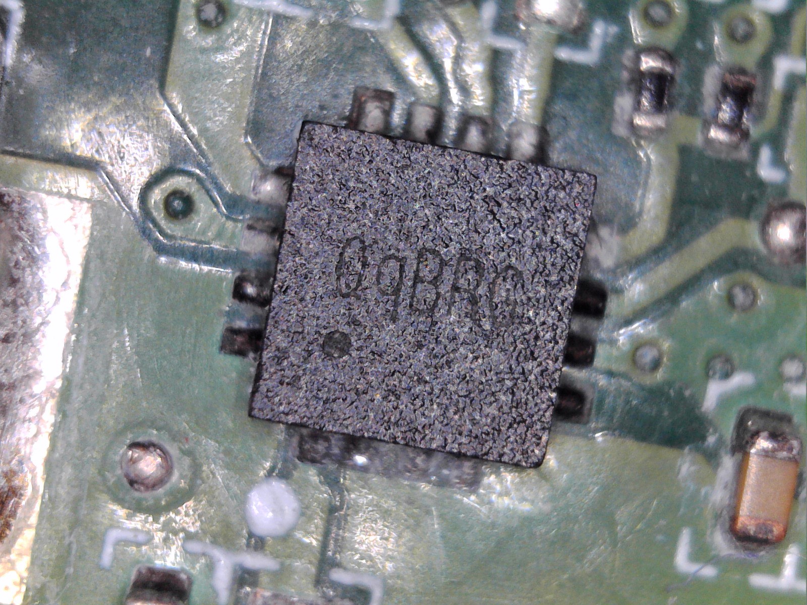

          Does anyone have the boardview for this hp 15-s da0p5dmb8c0?? Will appreciate if someone can share this document. The numbers on every single component is Hp customized, all number are unique. One chip has this number QqBQD, on my board its is getting very hot, can't even touch. Thank in advance

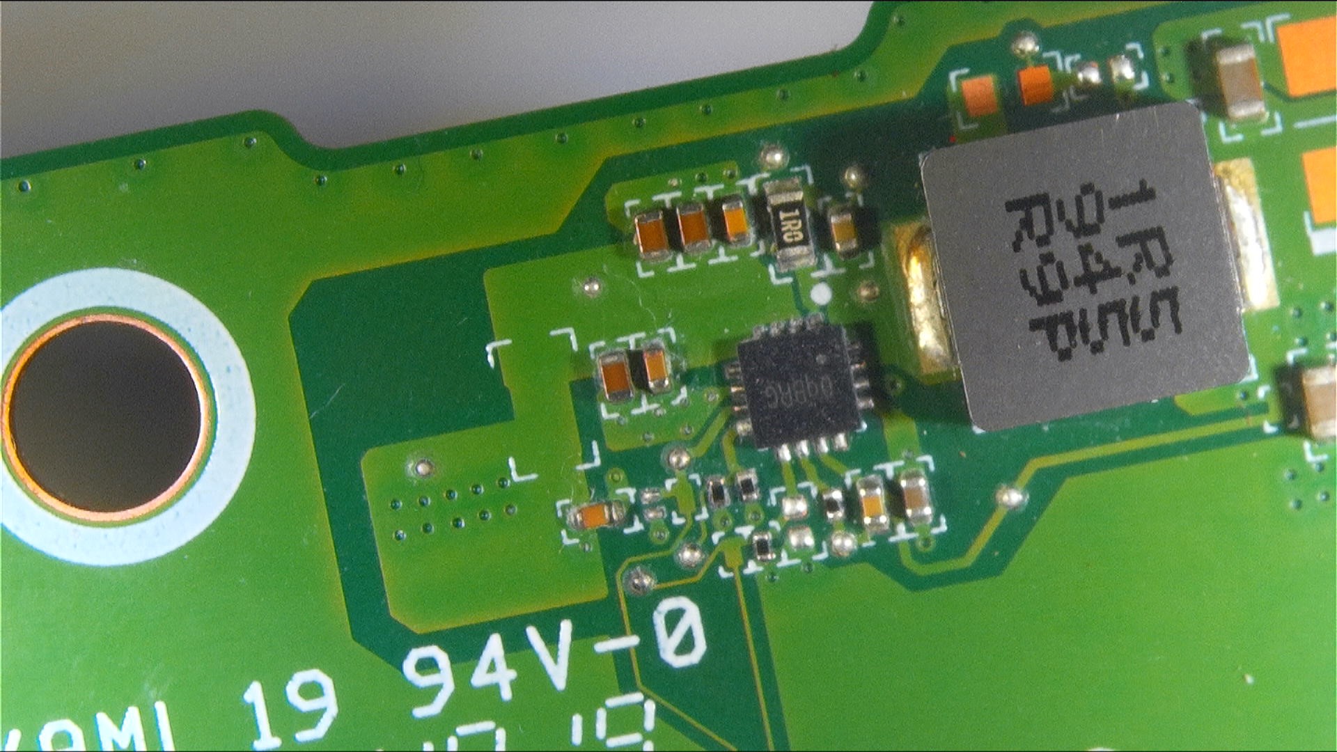

                Anyone found board view for this mobo DAOP5DMB8C0 rev c? I have boiling chip. any idea what the chip is?

                  Re: Schematic for hp 15-s da0p5dmb8c0
                  Silergy p/n SY8386BRHC
                        Originally posted by nissimezra
                        Hi guys
                        This is the +3.3V buck regulator.
