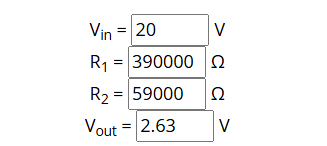

    Pin 6 (ACDET) - 1.83v (should have 2.6)
    Yes.
    Check the resistance of PR310 and PR311. Do so without power to the machine. Each should be close to the schematic values.

      The PR310 has 214k, off the board it has 390k.
      The PR311 has 54.97k.

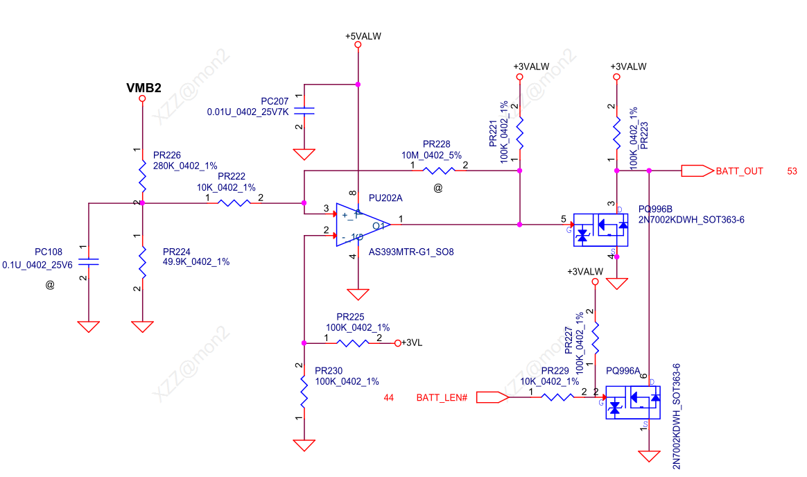

                        Measure the voltage to ground of the following:
                        PU202A - pins 1, 2, 3
                        PQ996A - pins 1, 2, 6
                        PQ996B - pins 3, 4, 5

                          With power supply:
                          PU202A:
                          Pin 1 - 3.36v
                          Pin 2 - 1.68v
                          Pin 3 - 3.01v
                          PQ996A:
                          Pin 1 - 0v
                          Pin 2 - 3.38v
                          Pin 6 - 0v
                          PQ996B:
                          Pin 3 - 0v
                          Pin 4 - 0v
                          Pin 5 - 3.36v
                          With power supply and battery:
                          PU202A:
                          Pin 1 - 0v
                          Pin 2 - 1.68v
                          Pin 3 - 2.18v
                          PQ996A:
                          Pin 1 - 0.v
                          Pin 2 - 0v
                          Pin 6 - 0.008v
                          PQ996B:
                          Pin 3 - 0.08v
                          Pin 4 - 0v
                          Pin 5 - 0.004v
                          • mon2
                            • Dec 2019
                            • 14737
                            Confirm that PR223 is present and that there is a 3v3 voltage on the high side of this resistor. Otherwise, PQ996 appears to be defective.
                            These are 2N7002 mosfets and only if the gate voltage is a logic '1' should they conduct and pull the line to low = ground. These dual mosfets appear to be in the stuck ON state.
                              PR223 seems to be it. 3.38v on the circled side, and on the other side, which would be BATT_OUT, zeroed.
                              • mon2
                                • Dec 2019
                                • 14737
                                This means the mosfets are always pulling this line down. Flux and remove pq996. Then the signal line should be pulled to a logic ‘1’.
                                  Signal line "BATT_OUT"?
                                  • mon2
                                    • Dec 2019
                                    • 14737
                                    Yes.
                                    • G_sene
                                      • Jul 2023
                                      • 76
                                      • Brasil
                                      Yes.
                                      PQ996 removed and not beeping (pin 3 BATT_OUT)
                                      3.3v arriving on pin 3 (BATT_OUT)
                                      • mon2
                                        • Dec 2019
                                        • 14737
                                        Connect only the battery and measure the voltage on PU202A
                                        pins 1, 2 and 3.
                                        No power adapter. What is the voltage on the battery?
                                        Also, the ACDET is not the proper voltage based on the adapter voltage and the shared resistor values for the voltage divider.
                                        Suggest to flux and remove PC316 which may be affecting this voltage. The resistor values look ok for now. What is the ACDET voltage after removing PC316? For this ACDET testing, place back the PQ996 component on the board.
