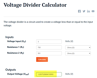

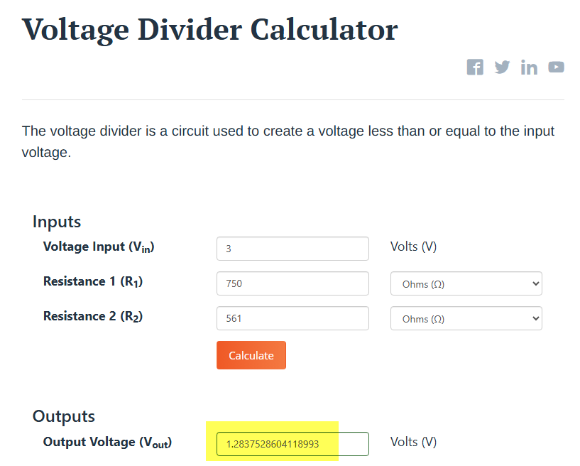

560 ohm resistor on pin 3 of the jack (ID pin) and the other terminal to ground.Comment
Remove all power. Unplug the adapter from the wall. Measure the resistance between the center pin and the ground on the adapter cable. Want to know what resistance is on the id pin from the factory.
see here:
https://superuser.com/questions/1246...apter-slim-tip
561ohmRemove all power. Unplug the adapter from the wall. Measure the resistance between the center pin and the ground on the adapter cable. Want to know what resistance is on the id pin from the factory.
see here:
https://superuser.com/questions/1246...apter-slim-tipComment
It had 1.44v before putting the extra resistorComment
