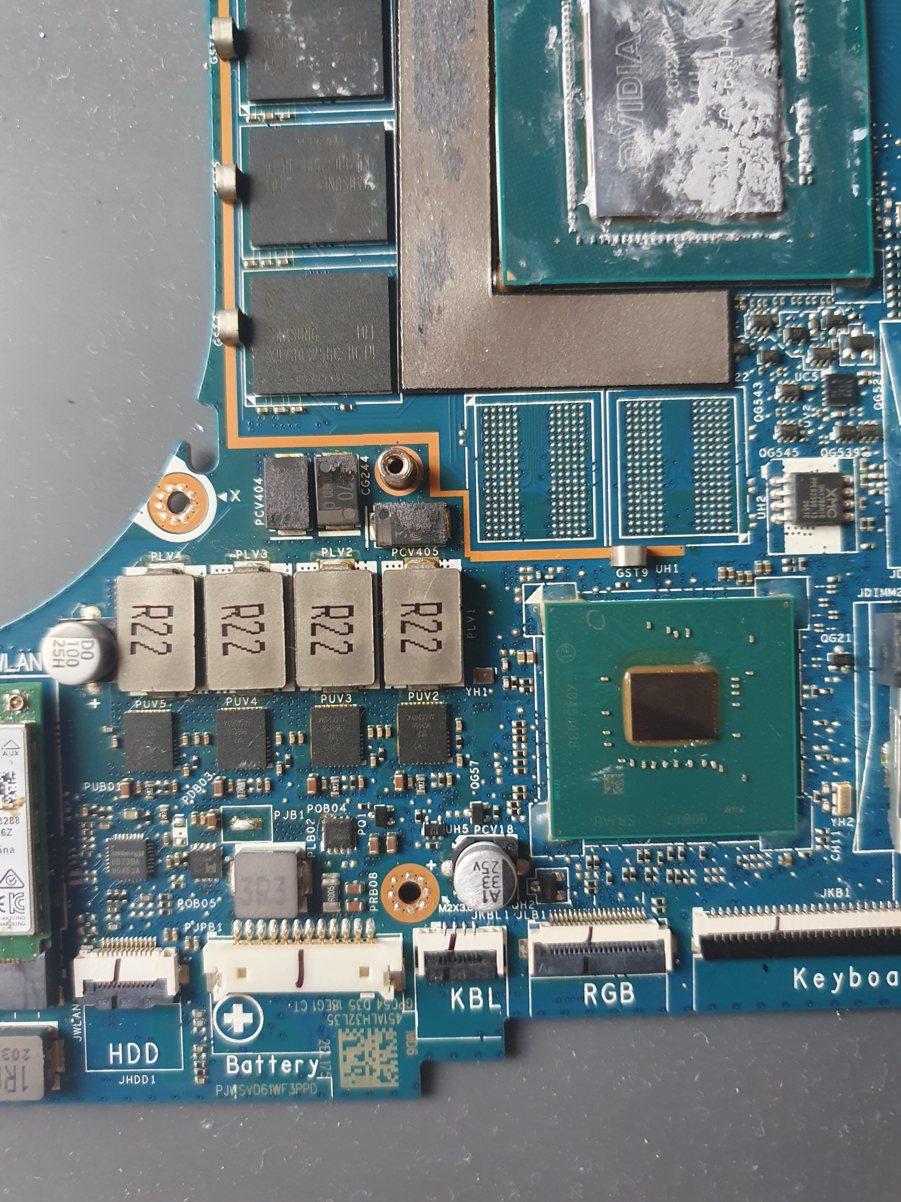

    Hiya does anyone know which mosfet this is? If so does anyone know where to find a replacement? As i need to get it replace but i have no idea where to find one,

    Post more details of the motherboard; make; model. Inquiring minds want to know.

      Looks like it is a PE636BA UNIKC-Semi PDFN 3x3p

        It's from HP OMEN 15-DH1005NA, motherboard, LA-j6622 (N18E)

          Most likely PE636BA

            Thanks, i can't fix my laptop till i change this mosfit, if i find one will the number on the mosfit matter? Or just replace it with any PE636BA

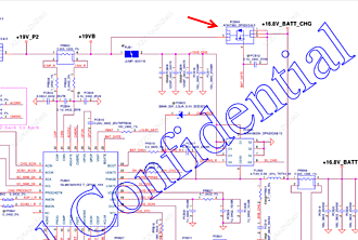

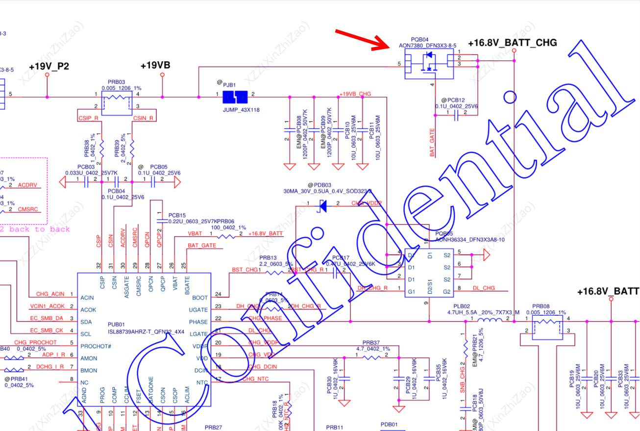

                Found a similar schematic - see attached.
                Criteria:
                1) 3 x 3 smd size
                2) N-channel type
                3) handle the same or higher currents as the original (use the one in this shared schematic to review the datasheet - use it for reference)
                4) handle the same or higher voltages
                From where do you like to shop for parts? Digikey / mouser / RS Electronics ok? You are in the UK so you should also have access to Mobile Sentrix (UK branch).

                    Here is a stock item at DK.
                    https://www.digikey.ca/en/products/d...IPknG1WLGMS2gA
                    * linked are Canadian $ prices. Change the currency to suit. DK has a fair shipping fee.
                    * this cross should work fine
                    Here is a link for Mobile Sentrix (UK) - this part should also be ok but has a lower current rating:
                    https://www.mobilesentrix.uk/cpu-mos...-n-channel-d-s

                        Am just sending you a big picture so you can see what's around the mosfet itself so you know 100% sure it's the one you mentioned earlier
